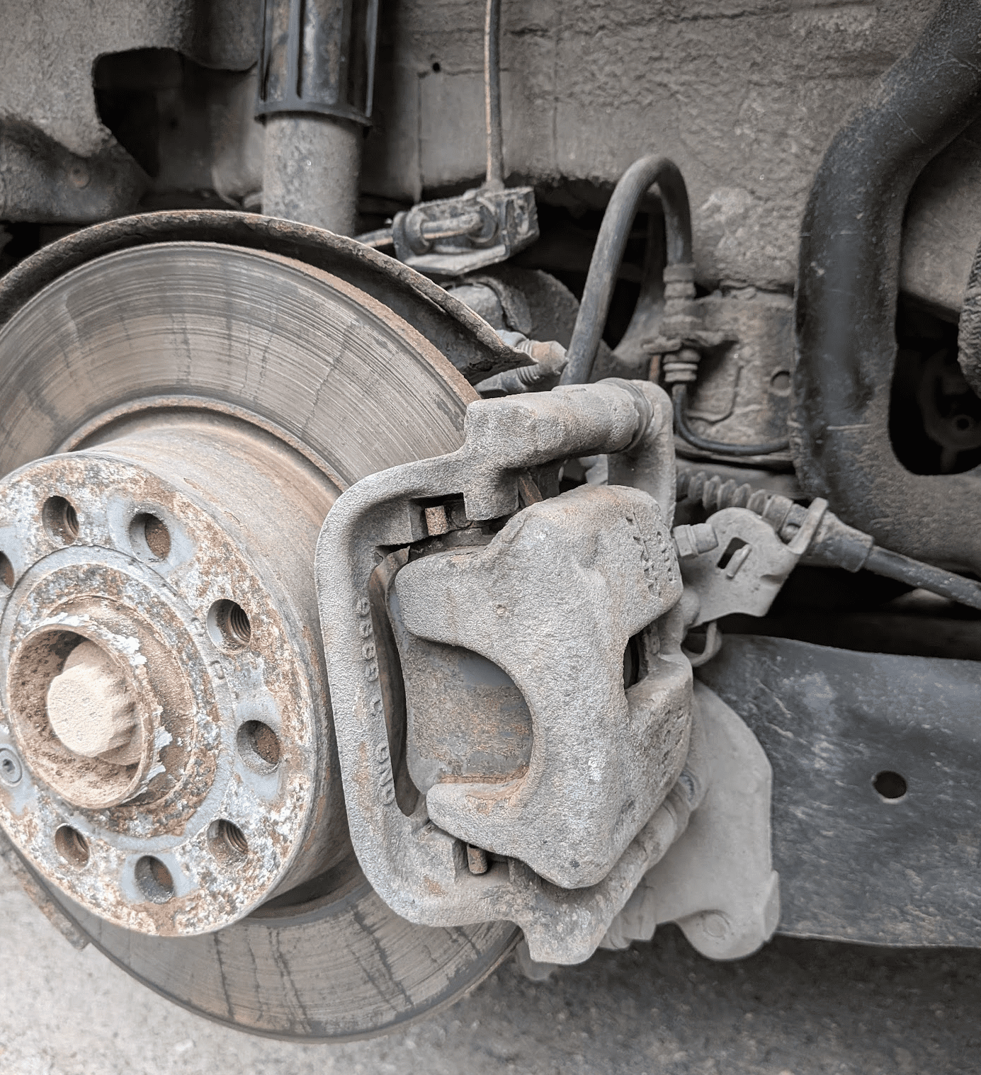

Hi everyone,
I was about to replace the rear brake discs and brake pads on my Seat Leon X-Perience 1.6 TDI (2016). It has the 272 mm rear brake discs.

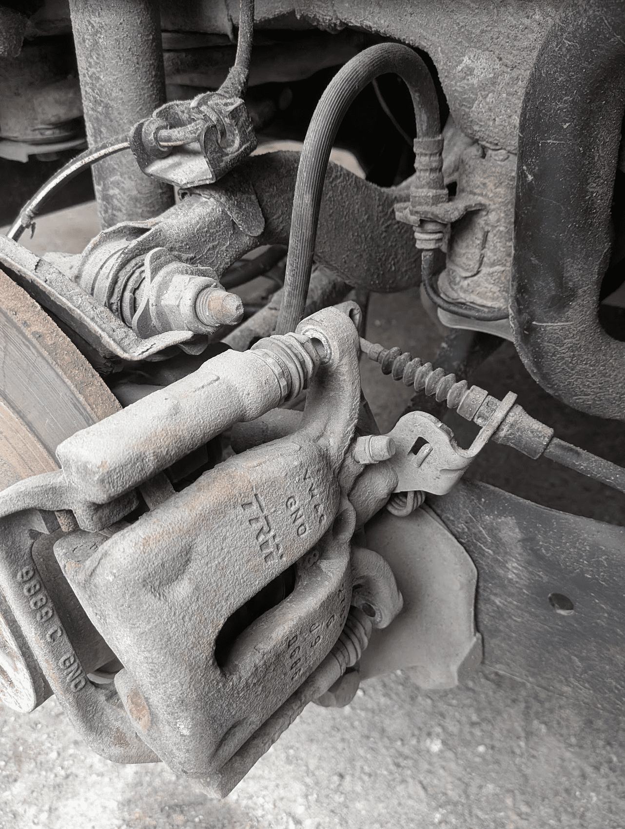

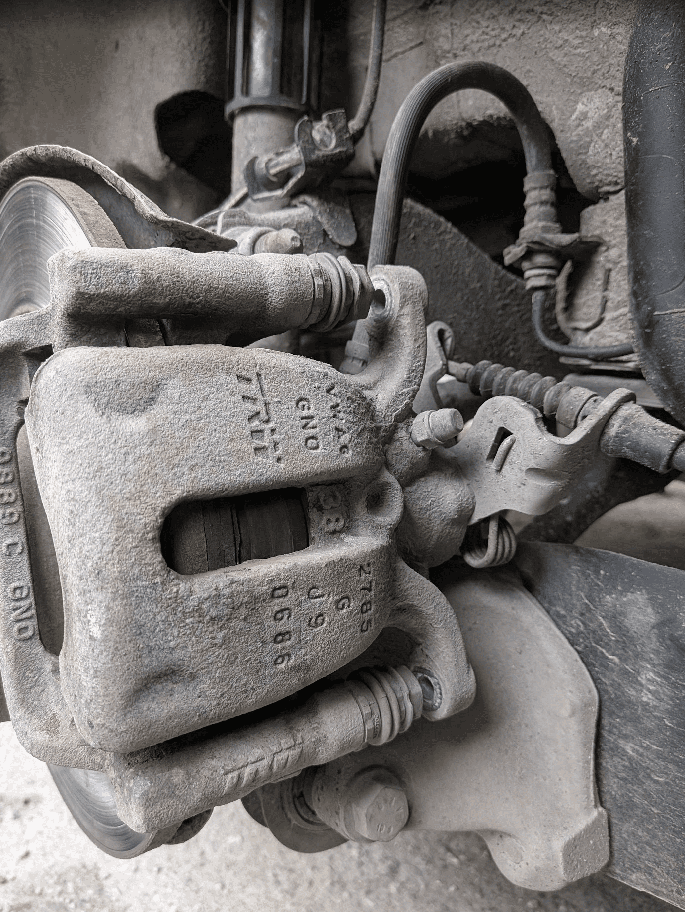

I've done this a few times before on other cars and it has always been very straightforward. I also watched a few videos beforehand and in those cases it looked very simple — just remove two bolts (which I've done) and pull the caliper off.
However, on my car the brake setup looks different. The handbrake cable and brake hose go directly into the caliper, so it doesn't seem like you can just pull the caliper off the same way as in the videos (see pictures).
I haven’t been able to find any guides or videos that show this specific setup with the handbrake cable on the caliper.
Does anyone know the correct procedure for removing the caliper and replacing the rear discs and pads on this setup?
Any tips or instructions would be greatly appreciated.
Thanks for the quick reply! I tried pushing the caliper out, but it was extremely stiff—probably partly due to rust, but also because the brake cable and hose go into the caliper. Felt like I was about to break something. Are you sure there’s nothing else that needs to be loosened on this type of caliper?
If you are still really worried, use a screwdriver to lever the handbrake cable out of the lever on the calliper, then use long nosed pliers to let you pull the handbrake cable out of the calliper's handbrake bracket.
Doing that should let you "use" all the available "length" of the flexible hose to get the calliper out of the disc, it will be "stuck" due to the pads gripping the calliper carrier AND the calliper.

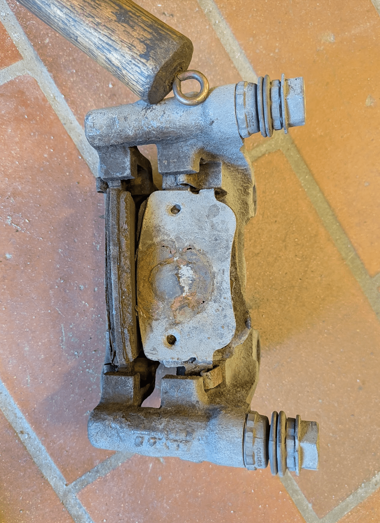

Thanks for all the help — I’ve now managed to replace the brakes.
Compared to other cars I’ve worked on, this one was significantly more difficult.
The XZN M14 was really stuck on there, pita to get off...
Luckily, through a friend’s workplace, I got access to a service pit, which made it possible to reach everything from underneath — otherwise I would never have managed it.
This is what the old brake pads looked like — totally rusted to bits.
No wonder the caliper was so hard to get off.

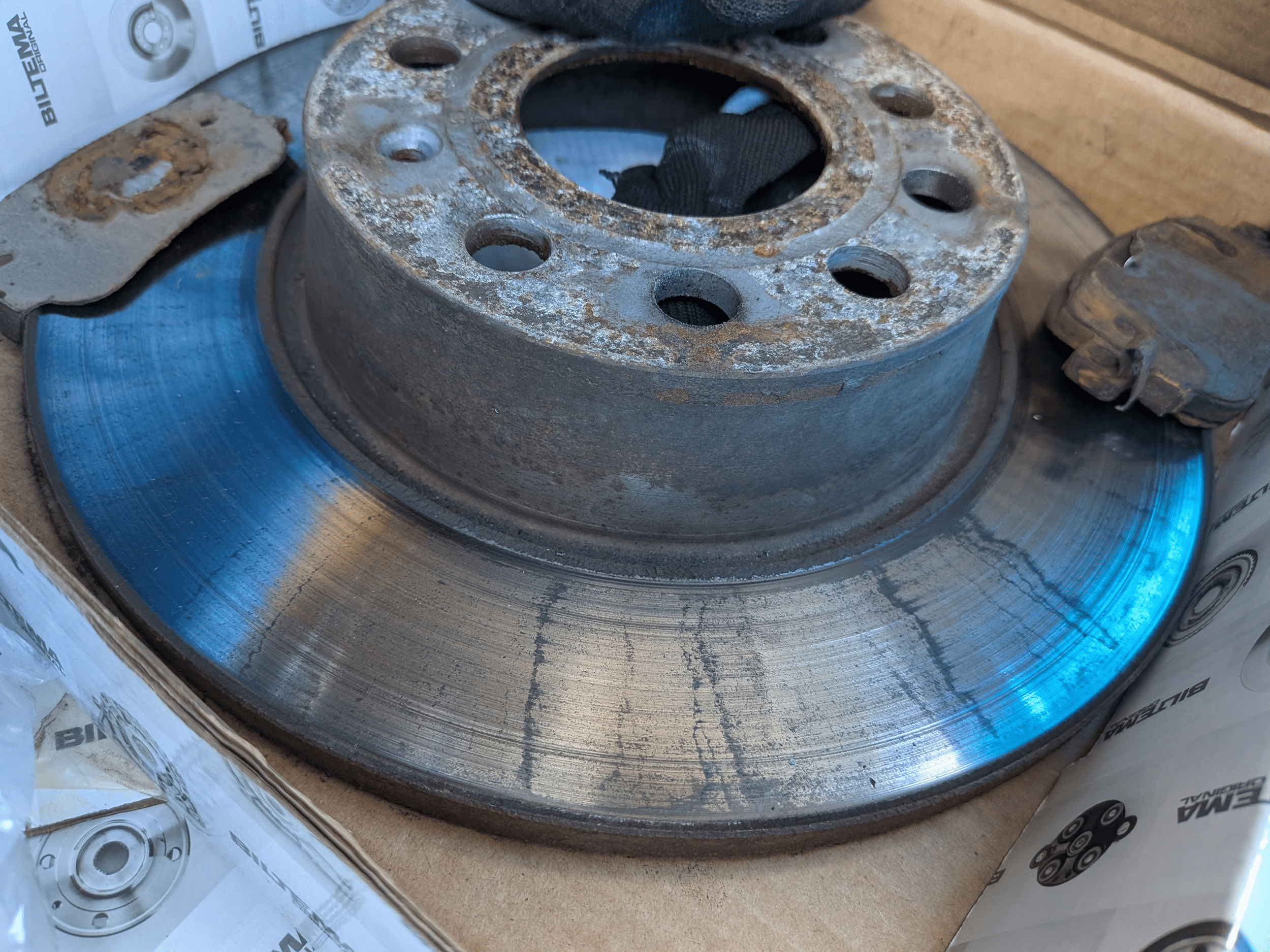

If the pads were this bad - what were the discs like?
I recently had to change my rear caliper due to the piston/handbrake mech being a little seized, same brake as yours.
What were your calipers like? did the pistons wind back fairly easily?
The discs didn't look too bad IMO, or what do you think..?
I had to use some force, but not too much, to rewing the pistons.
Reactions: mty12345
They look quite rough.
A well functioning brake disc should look uniform and shiny.
All those radial lines are a sign the brake isn't working efficiently.
