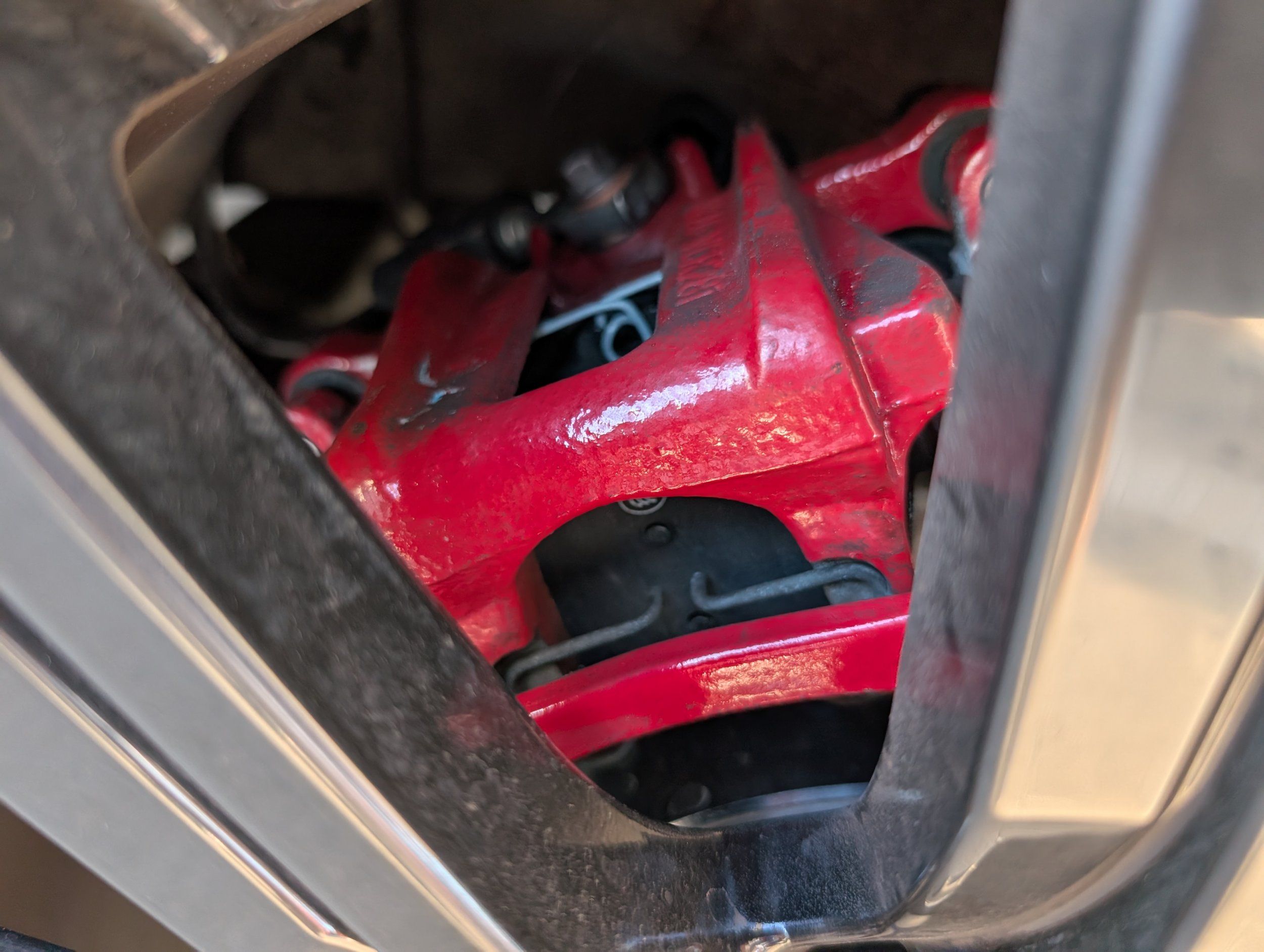

Today the rear brake from a MQB EVO model was installed in a MQB Classic vehicle.
both vehicles have PR code 1KE.
everything fits, however the complete 1KE MQB EVO brake is required.
that means caliper and motor for the EPB, as well as pads and discs.
what I immediately noticed when driving, the EPB drive is much smoother, quieter and simply much more comfortable.
for me it is definitely an upgrade

Interesting feedback.
Presuming it also needed the caliper carrier (bracket) from the MQB EVO?
I believe the discs are the same 272x10 - so could be just new pads + caliper if your discs are in very good condition.
They have the same part numbers!
2019 Leon 1KE
5Q0615601D Brake disc 272X10MM 5/112
2025 Leon 1KE
Reactions: cairus and Craig.
So, now we'll clear everything up. I had, of course, promised beforehand. The brake discs are the same, of course. But the brake plates are not. That's what I meant. A detailed parts list will follow later.
Reactions: SuperV8
So, the spare parts:
- 5WA615424QC8 (Mounting bracket + caliper + motor were with me. QC8 = Red)
- 5WA615423QC8 (Mounting bracket + caliper + motor were with me. QC8 = Red)
- 5WA698451G Brake pads
- 5Q0615601D Brake discs
- 5Q0615611P Left brake plate
- 5Q0615612P Right brake plate
