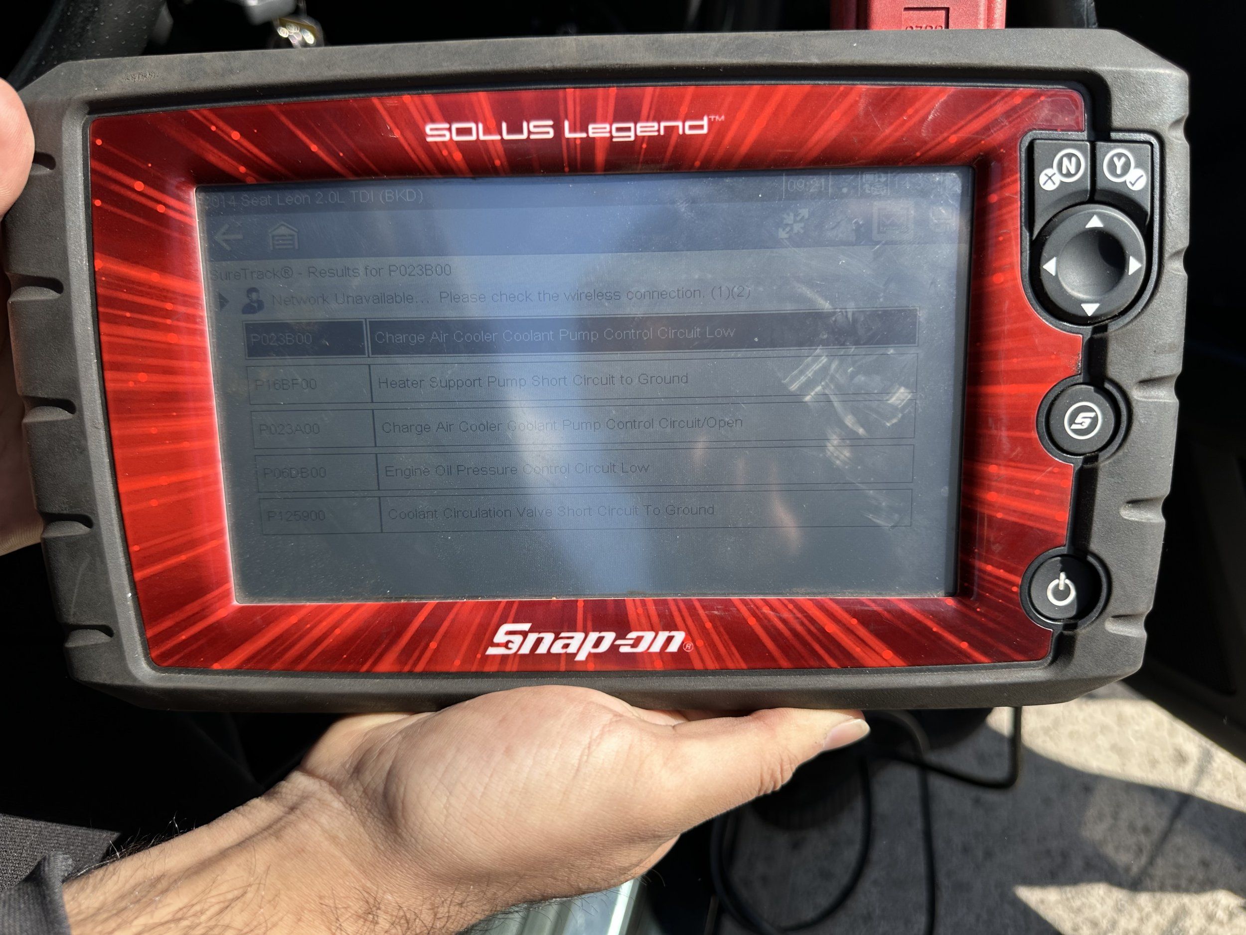

My Car is a 2014 Seat Leon Fr 184 TDi Technology DSG, my car is showing engine management light and when scanned shows these codes and they reappear even after clearing the codes, would anyone be able to help me in the right direction of what could be wrong.
P023B00
P16BF00
P023A00
PQ6DB00
P125900
Charge Air Cooler Coolant Pump Control Circuit Low
Heater Support Pump Short Circuit to Ground
Charge Air Cooler Goolant Pump Control Circuit/Open
Engine Oil Pressure Control Circuit Low
Coolant Circulation Valve Short Circuit To Ground
Have a look at the wires that go passed the oil filter.
Many places stretch the wires out of the way to change the oil filter and it breaks one of the wires going in to the aux pump connector.
That wire might now be touching an earth point.
