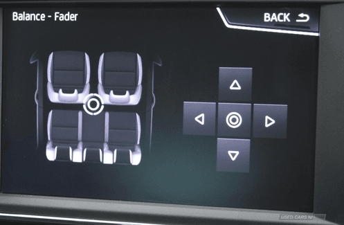

SuperV8
May 30, 2019
1,344
594
Thank-you mate. But I can't find the fader from front to rear ,only left to right??. Thanks for the advice tho
Strange, mine has something like this with left/right/front/rear arrows which moves the circle - and the sound:
