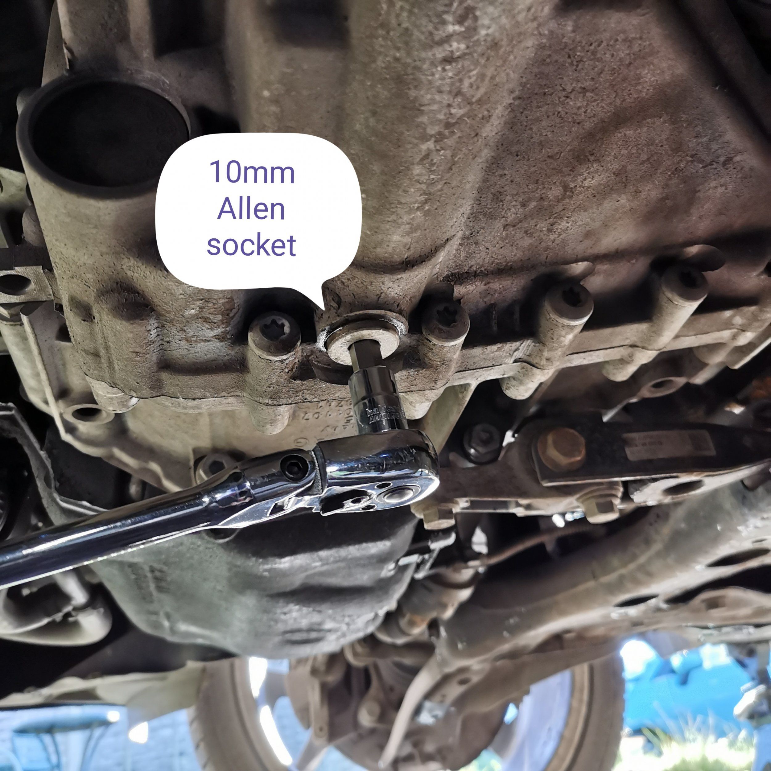

Place a suitable container under the drain plug and crack it loose with the 10mm Allen socket. It's tight but not ridiculously so:

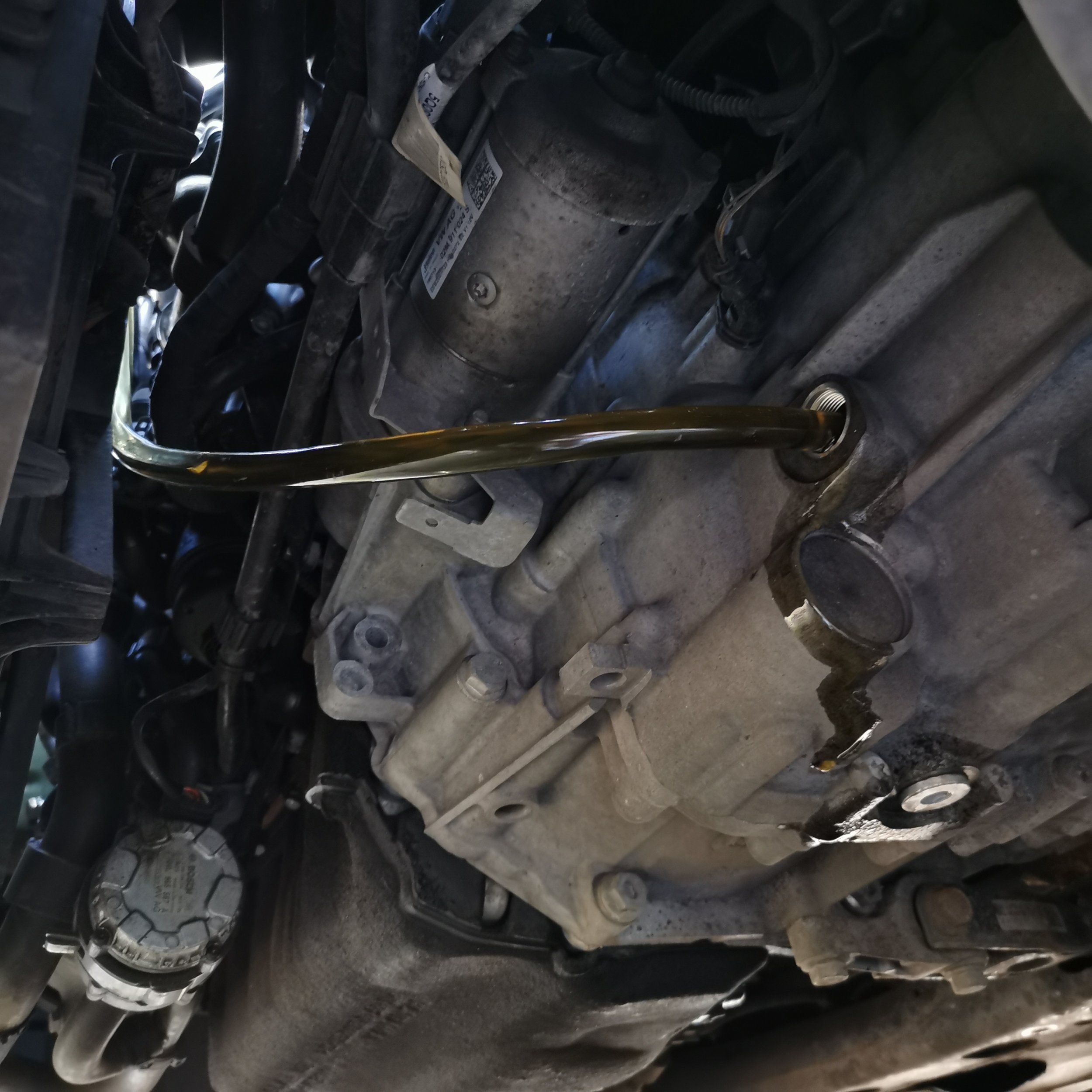

Remove the plug and the old gearbox oil will now drain out. I set a timer on my phone for 30 minutes to make sure most of the oil drained out. At this point I lowered the car to the ground again so the gearbox was level to make sure I got all the oil out:

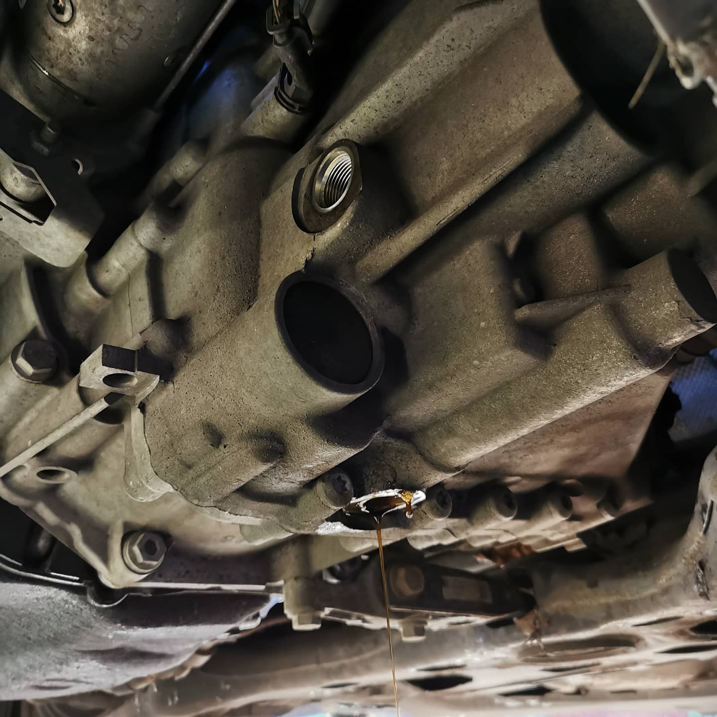

Remove the fill plug as well. This will help all the oil to drain out:

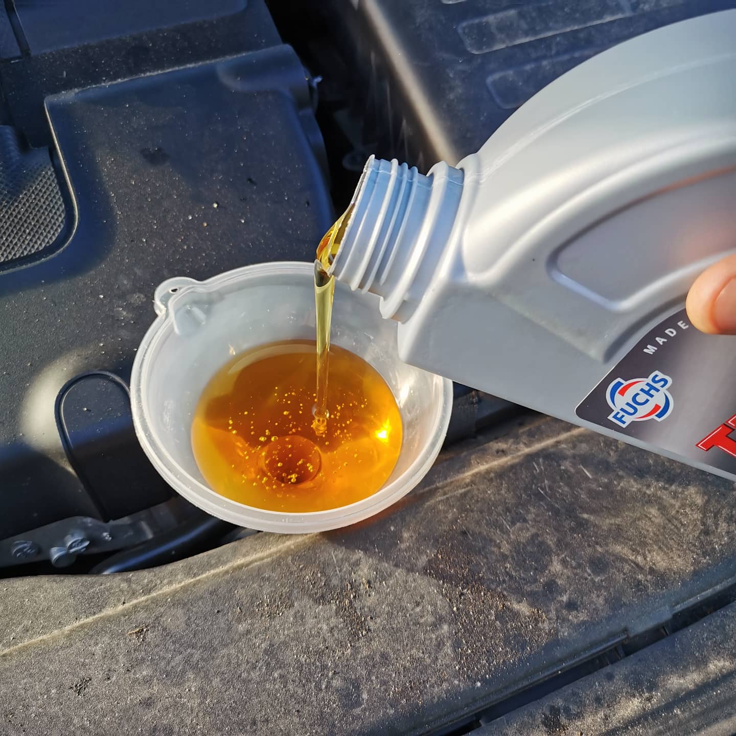

Open your first bottle of oil and pour a couple of glugs into the funnel and quickly get under the car and make sure the oil is going into the gearbox properly.
Keep pouring the oil into your funnel and checking underneath the car that it's still going into the gearbox properly. The first couple of litres should go straight in but check frequently when you're on your third bottle. When the correct amount of fluid is in the gearbox, the oil will start dripping back out of the fill hole.
