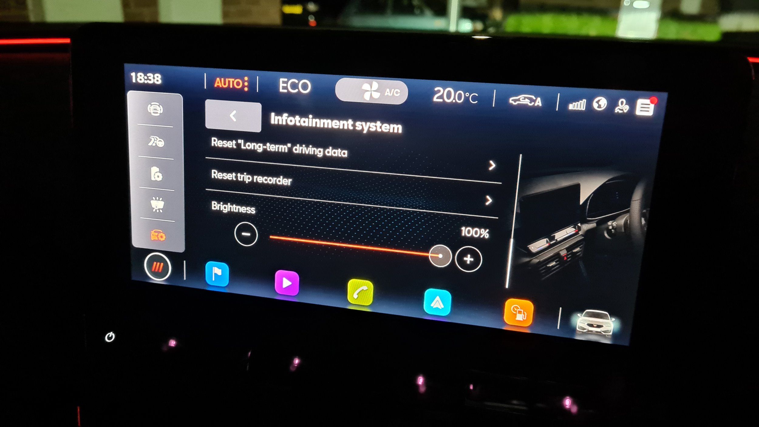

If you are talking about the actual screens (i.e the virtual cockpit and main infotainment) - there is DEFINITELY an option to adjust this as I've done this myself. I will look in the morning which sub-menu it is, but it is absolutely there as I know the screens can go very bright indeed.

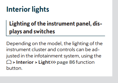

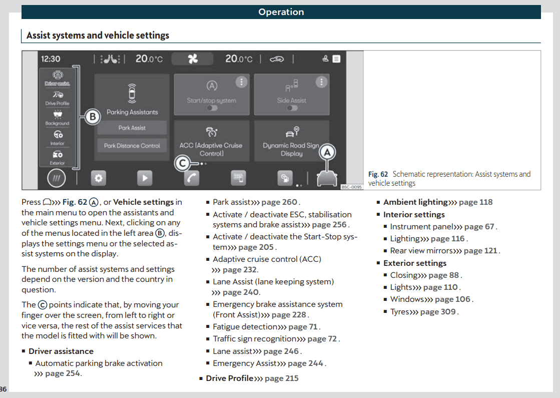

Took some finding in the online manual:
On page 116 I found this
That direct you to a not so helpful page 86...

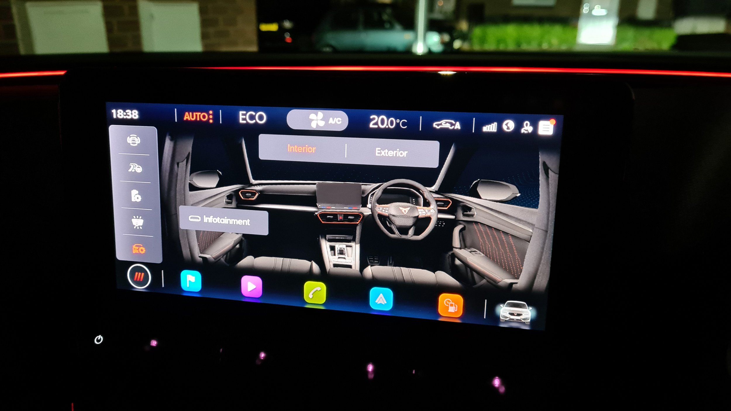

So I don't have a Fomentor, but going from my Leon Mk 3, I'd say you first need to go into Vehicle settings from the main menu.
So it looks like you then select interior on the left, and then if the instrument cluster is not immediately displayed, then Point C suggests swiping the screen left/right to view the additional options.
