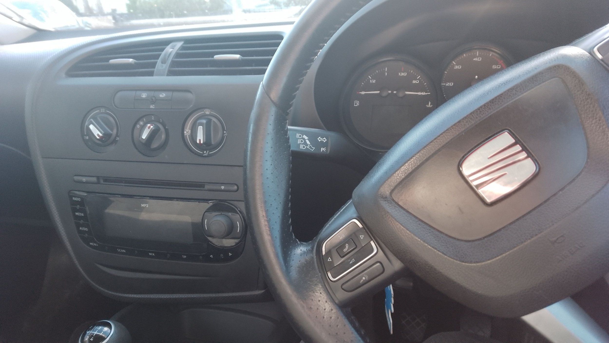

Hi all,

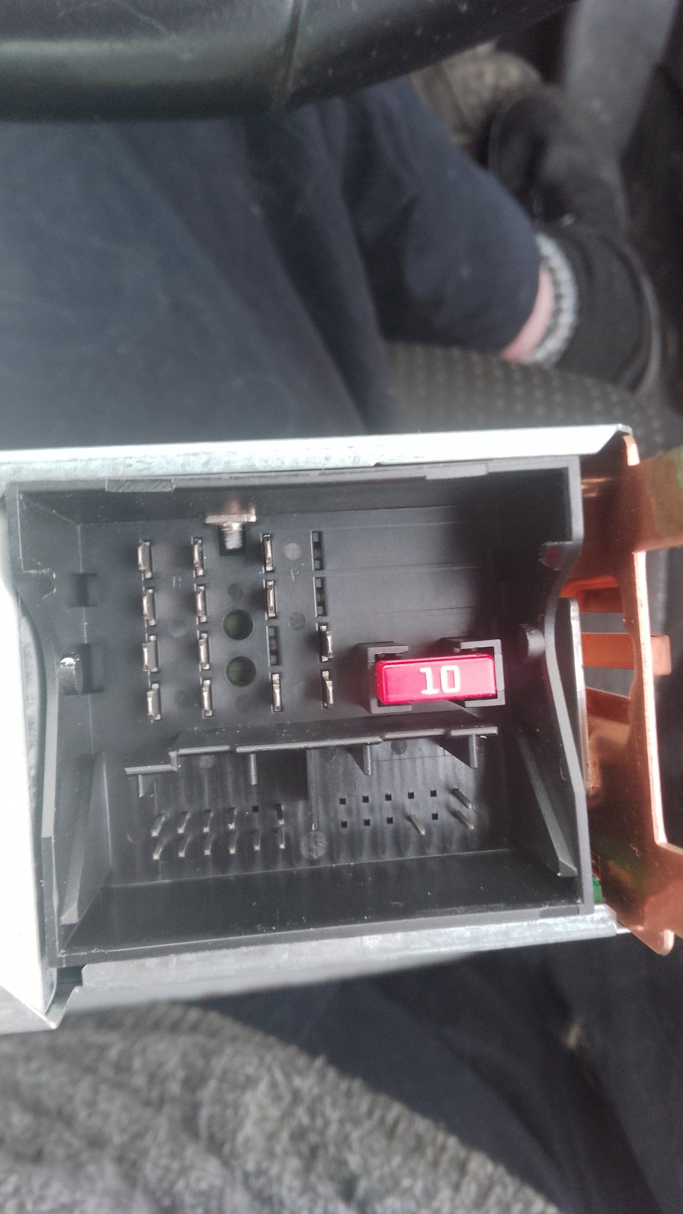

My car head unit all of a sudden turned off and now won't turn back on again tried fuses they seem OK including the one on back of head unit? I don't know what else to do it was working perfectly..
I've never had this issue before. I believe its fuse number 46 20amp that's the head unit fuse and there's a small 10amp on back of head unit. I've simply run out of ideas now?
I drive a 2014 Ibiza Fr 1.4

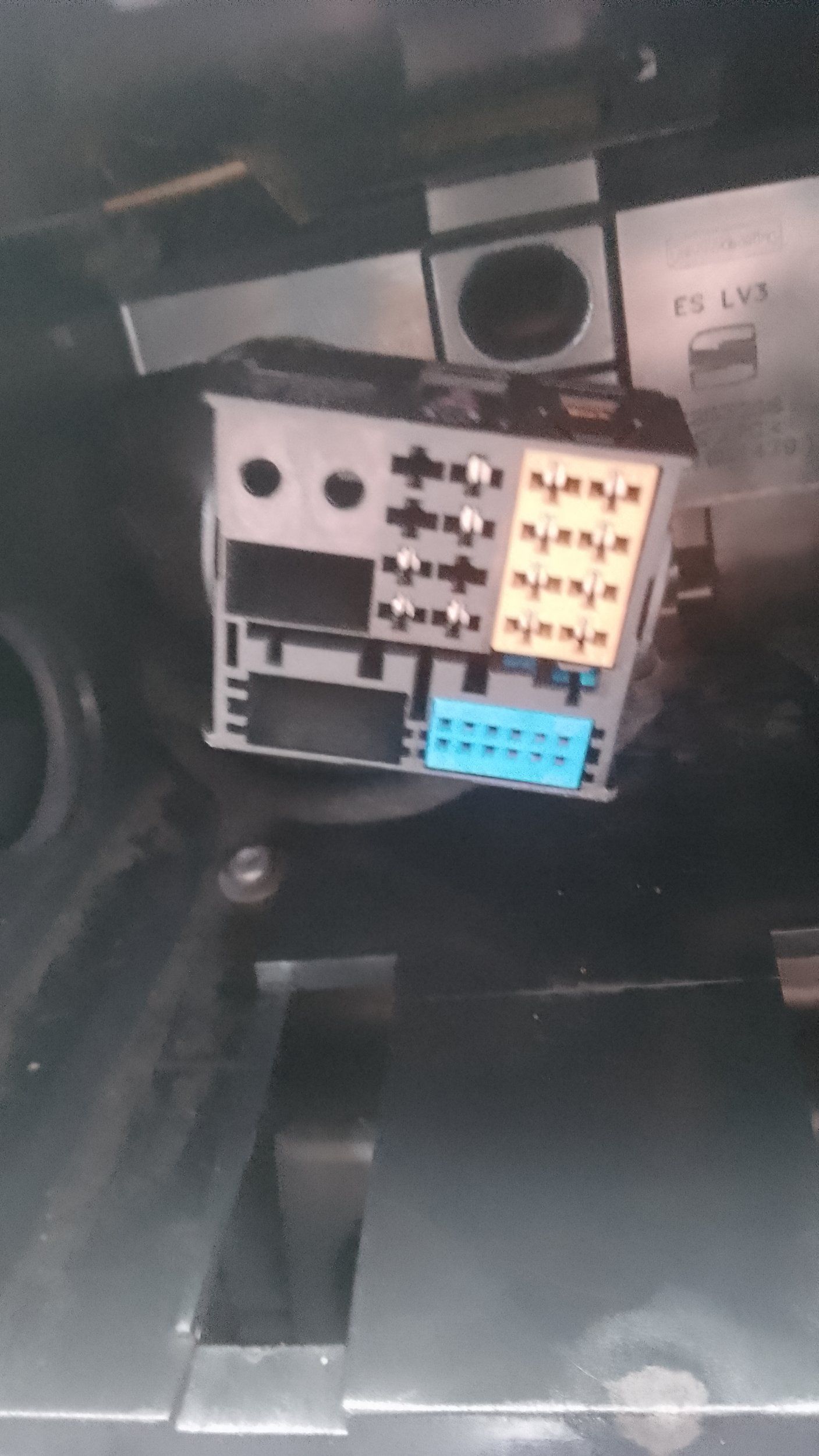

Have you got power to the back of the head unit?
RADIOTWO
Mar 6, 2018
490
94
North Derbyshire
Hi. There's no power checked fuses etc they are ok. The hazard etc all work but nothing on head unit no power
Hi that did not really answer the question ! You have all ready said the "Fuses" are ok but have you checked for 12 volts at the back of the radio (Head unit) ?
Jul 20, 2022
16
Nope. Il have to get a multimeter from work today and report back
Jul 20, 2022
16
Just to update. There was no power coming in so garage did a rewire with a few fuses and it's OK now
