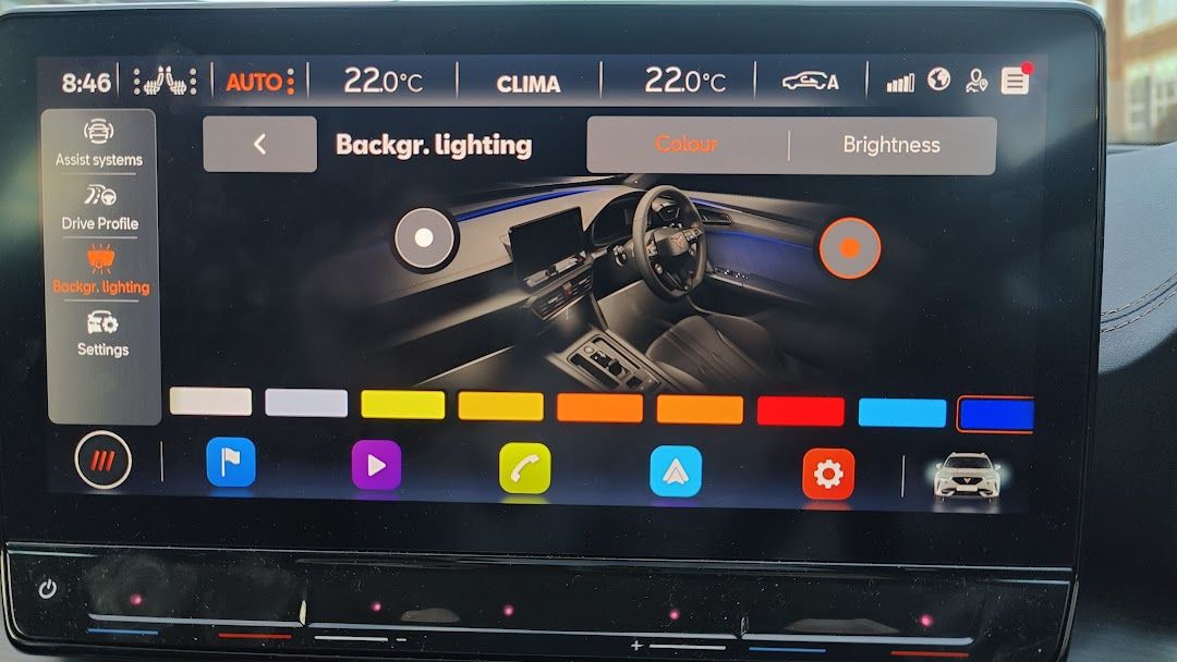

Formentor V2 eHybrid 204 DSG has purple.
Colour selection is identical to Villabrand's post #7

Of course, I have read the adaptations with OBD11! The results are sadly, inconclusive imo.
Firstly, identical HMI software:
H42.325.78_OIWLargeSEAT_EU
software base:
H42.325.78-202302061526
Skin build, model, etc. It's identical, so this must come together with software 1940.
Now the adaptations.
Hmi_ambient_colors_bitmask:
3ff00000
Both identical between the Formentors - I think this puts to bed the idea of changing this number to gain purple.
Interior_light_router_config, Interior_light_functions_1_to_70 - both identical.
Some differences:
V2 eHybrid (with purple)
Default_value_ambient_color:
16
Default_value_contour_color:
16
Default_value_ambient_color_fod:
16
Default_value_contour_color_fod:
16
VZ2 310 (without pruple)
26
26
26
26
Nothing specifically jumps out to me, I've only done an automatic difference search.
News still to follow if my own Formentor can be updated by technical - but tbh after looking at what I have here, I'm doubtful.
