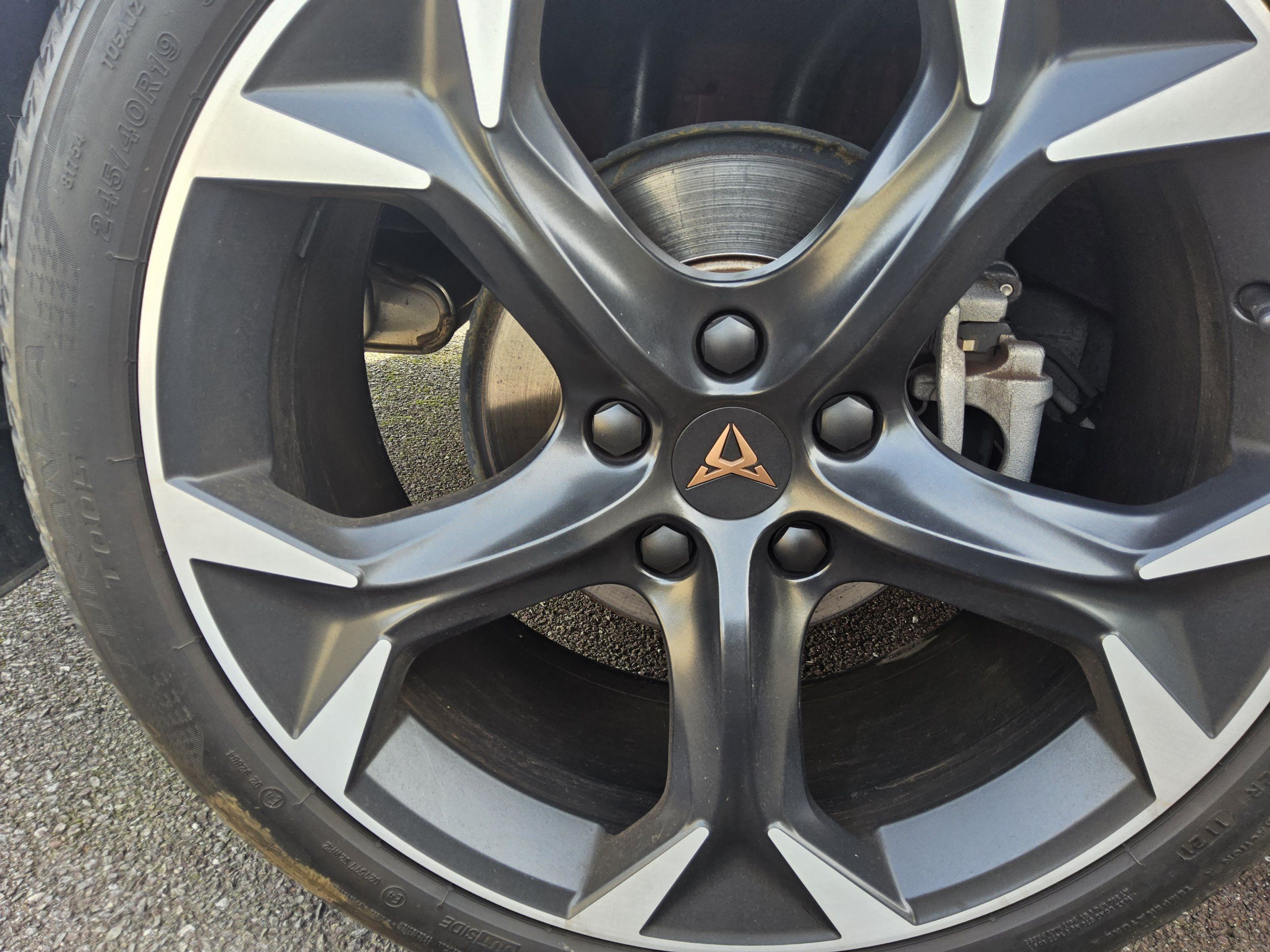

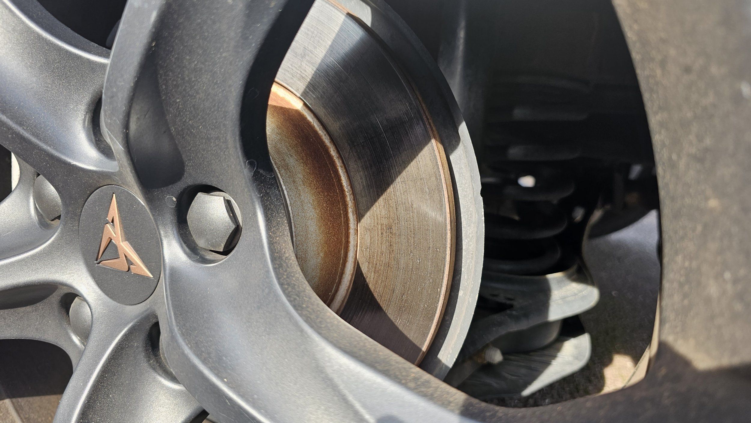

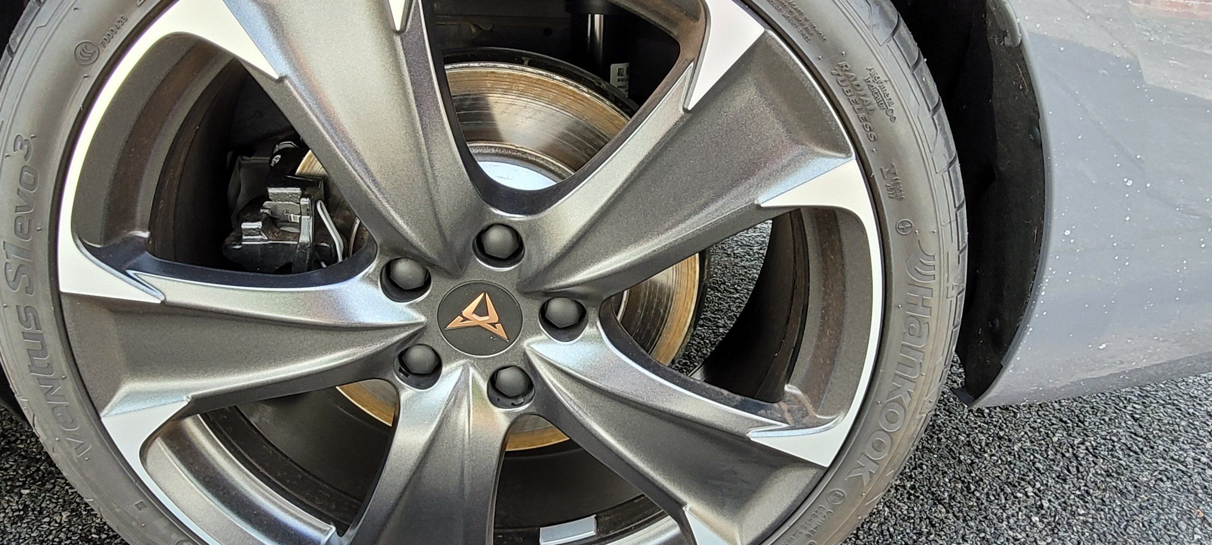

Hi, I recently took delivery of VZ2 E-Hybrid and the back discs are showing signs of the pads not making contact correctly 1k miles currently)
I'm aware this has been mentioned in a thread previously but I'm not sure what people's solutions were.
Has anybody experienced this on their car and if so what was the fix?
I've heard people say about having to brake harder due to it being a hybrid but I think if the pads are touching atall (which they are) then they should be touching across the full surface, parallel to the discs.
Look forward to hearing your thoughts/experiences!

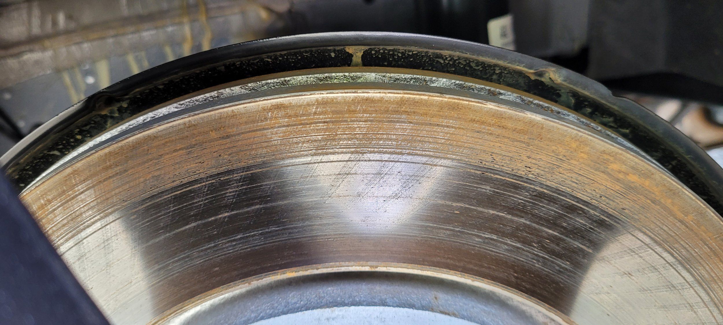

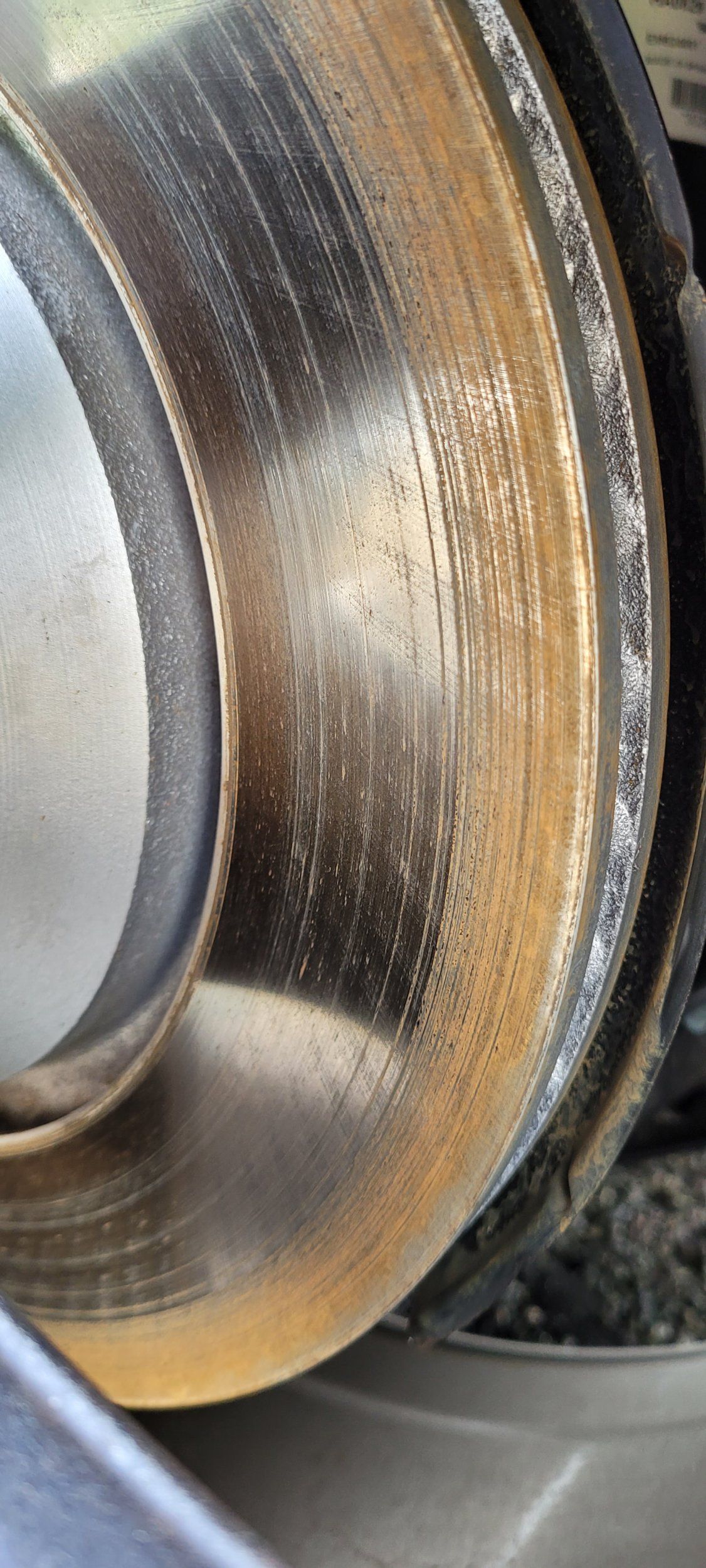

I have the Formentor hybrid and have regen set to max. My mileage is fairly low, I rarely brake hard and the rear discs are clean across the surface. I think you are right to have a concern. I'll try and put some pics up tomorrow for comparison.

They are perfect and as you/I'd expect them to be! Out of interest, how many miles has your car done (approx) and have your brakes always looked spot on as per the photos?
Appreciate you taking the time to send these,👍
It's a 21 plate, 12.5k miles approx.
This morning they looked rusty but I washed it yesterday. Today I did 40 mile round trip so used Hybrid mode.
No problem with the photos. Hope you get yours sorted. 👍
