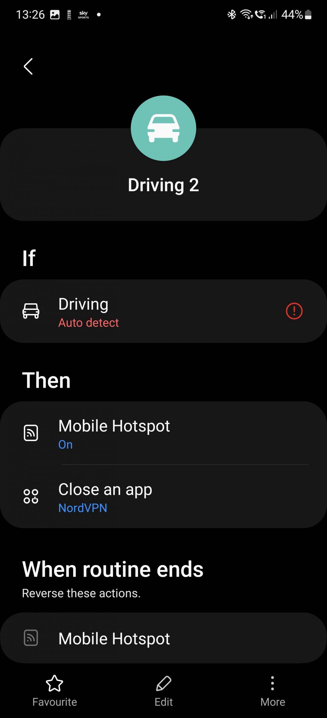

The Leon's and Formentor's are very similar in this. They have an eSIM buried in the infotainment / telephone system that connect to the Internet. A new car will come with just 1 year free connection (well, here in the UK they do). Look for the world globe top right of the infotainment screen. If not connected it will be greyed out. If you are still within the first year then it could be the system hasn't got a good mobile connection to the servers. Many people have had problems like this. If it's over 1 year old you can pay for more data on your cars eSIM but it is ridiculously expensive.
The best thing to do is create a mobile hotspot in your phone and connect your car to it. So your mobile phone will be connected to your car via Bluetooth and WiFi. Your car will then connect to the Internet via your mobile. It will of course use your data but it shouldn't use a lot.
I'm not familiar with your mobile phone so I can't help you there, but I have mine set up so it automatically connects the WiFi hotspot to the car as soon as I start it up. I use a routine like this:
It works every time without any problems. Take a look at this thread too:
I hope this helps.
