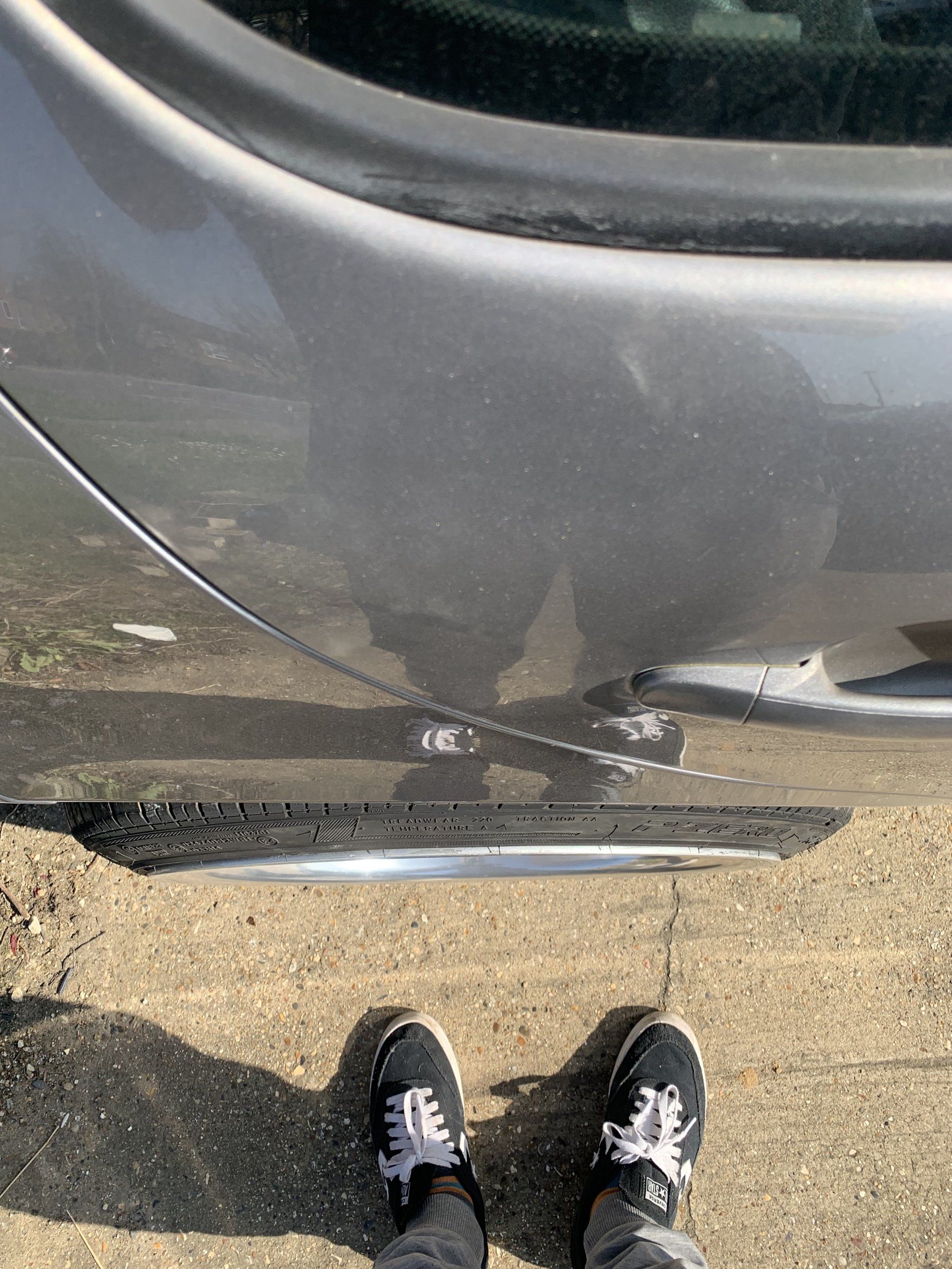

Since lowering my car on coilovers I've noticed quite a lot of toe in on the rear, and 3 months later it's starting to wear out my tyre's...I didn't even think the alignment could change on the rear with it being a solid rear axle, but obviously I was wrong and there's no way to adjust it. So what would you guys suggest? It's pretty much at the height I want, so I would rather not raise it, and I've seen other MK1's lower than mine so there must be some sort of solution for this 🤔

I haven't had the geo checked, as I'm not aware of any garage around here who even do it...The place I usually go to (and will be going to again soon), only does front wheel alignments. When the car is on flat ground it looks like both wheels toe in which I never noticed before the coilovers went on. But when the rear is jacked up, the toe looks fine again. I posted the same thing on a few facebook pages, and one guy was explaining all this geometry stuff to me. Don't really understand what he was going on about, but I'm pretty sure he was trying to say that it's normal for this to happen 🤷‍♂️
Also, I did change the wheels around. Only because the rear tyre's needed replacing and the fronts were still good, but I wanted better tyre's for the front. So I put the good ones on the back, the crap ones on the front, then had brand new PS4's put on the front. They wasn't worn on the edge when I first put them on the rear, so I don't think it's that.

Umm, definitely shouldn't be showing any toe on the rear, definitely not both toe in. Rear beams don't change any geometry except for misaligning the beam (which would mean toe in on one side and toe out on the other).
Definitely get it checked asap, either with a string guage or by someone with the right gear because if it is changing geo then you've got very big problems with the beam

Somebody else said the same thing, pretty much. He was adamant that my rear axle is bent, but I don't see how 🤔 It seemed fine before, I installed the coilovers, and that's when I first noticed the toe in...The only thing I can think of is that there has always been toe in, and it was just less noticeable at stock height? But I then had another guy explaining all this geometry stuff to me, basically saying it's normal.
If it comes down to it, I've heard that a new rear axle is fairly cheap on Autodoc and places like that. So I'll just build another one with polyurethane bushings, to match the front.

I can confidently say that the person saying it's normal does not know anything about this kind of suspension.
Beam axles don't have that kind of flex because it would be dangerous to have suspension geometry uncontrolled like that.
If your toe is changing then your rear suspension is well and truly knackered or you have multi link suspension. The latter is great, the former is a bit scary

@Ca11um43 its a normal occurrence when you slam a mk4, the toe camber and caster all go out of whack. theres nothing wrong with your axle.
you can adjust camber and toe with washers, drop plates or shims.
my toe was crazy when i added some camber shims, i used a washer to adjust it.

Well that's reassuring...Was starting to think I was seeing things when everybody told me it's not possible unless my axle was bent 😂 As it's highly unlikely that it bent just from fitting coilovers. But what would be my best option? Washers, drop plates, or shims? And any ideas where I can buy them from? The annoying thing is, sometimes they look fine, and sometimes they look like they have a lot of toe in. It all depends on how uneven the ground is, etc etc. So it may be a struggle trying to get the toe right.

shimming its pretty simple the only thing you need to account for when chucking any kind of shim in to align the caliper as well (not needed with the drop plates) getting to the stubs is a *******, you have to wrestle with a lot of rusted stuff and the disc shields.
the SPC toe shims seem harder to get but that is probably all you need. i should have got 1 camber 1 toe shim myself but im happy with just adding a washer to the lower front stub bolt. start with a 4 wheel alignment if you can to get some figures. i think ive got around neg3-4 camber in the back so im just sucking up my imperfect toe.
what you need is really up to you, some of these bits arent super easy to get hold of as they're mostly for bagged/static stuff. some people say adding a washer instead of a shim is super sketchy, but there's no serious force on the axle. also depends how low you are, because the drop plates will adjust the the caster rearwards.
