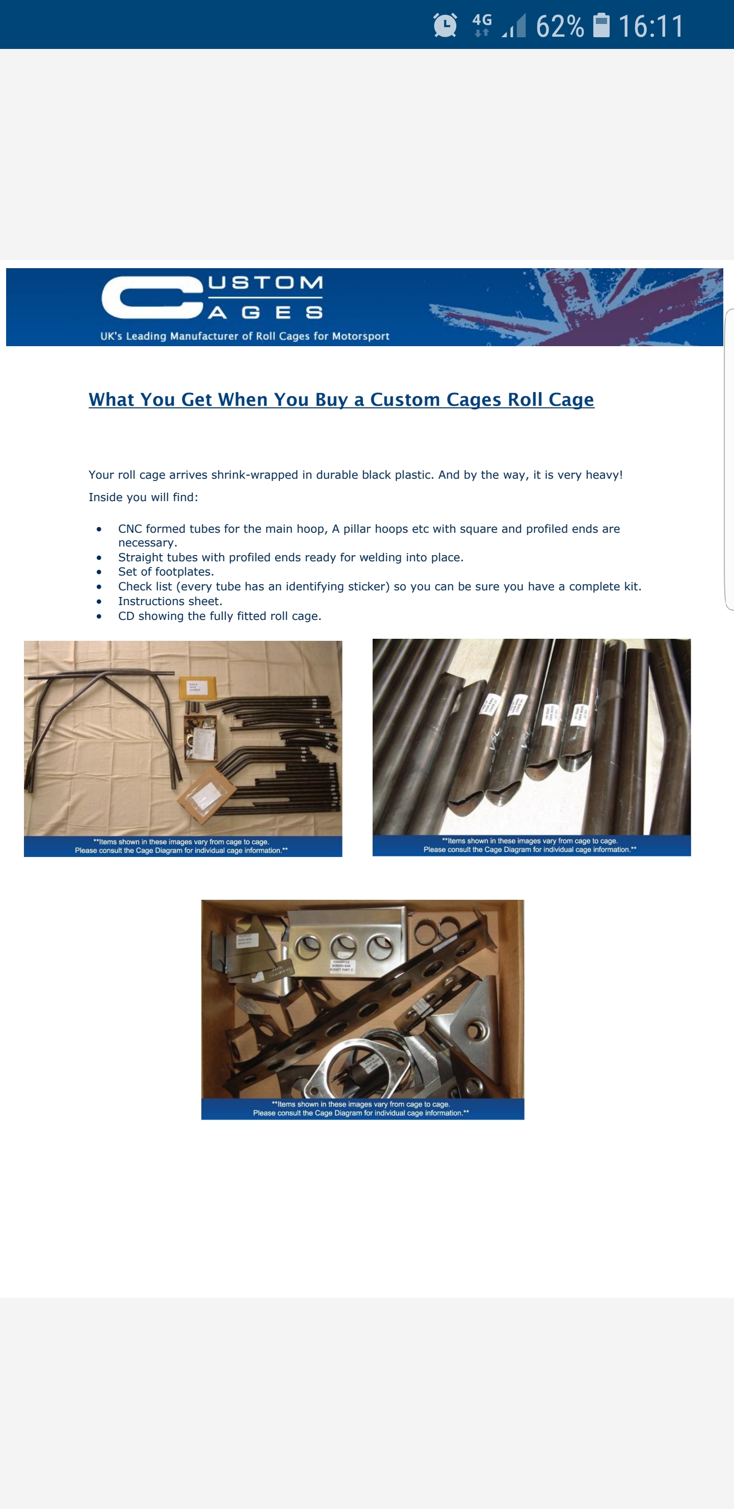

Been on the phone to custom cages. For £1200 they will supply a multi point weld in cage with all fixings etc. Very tempting.
