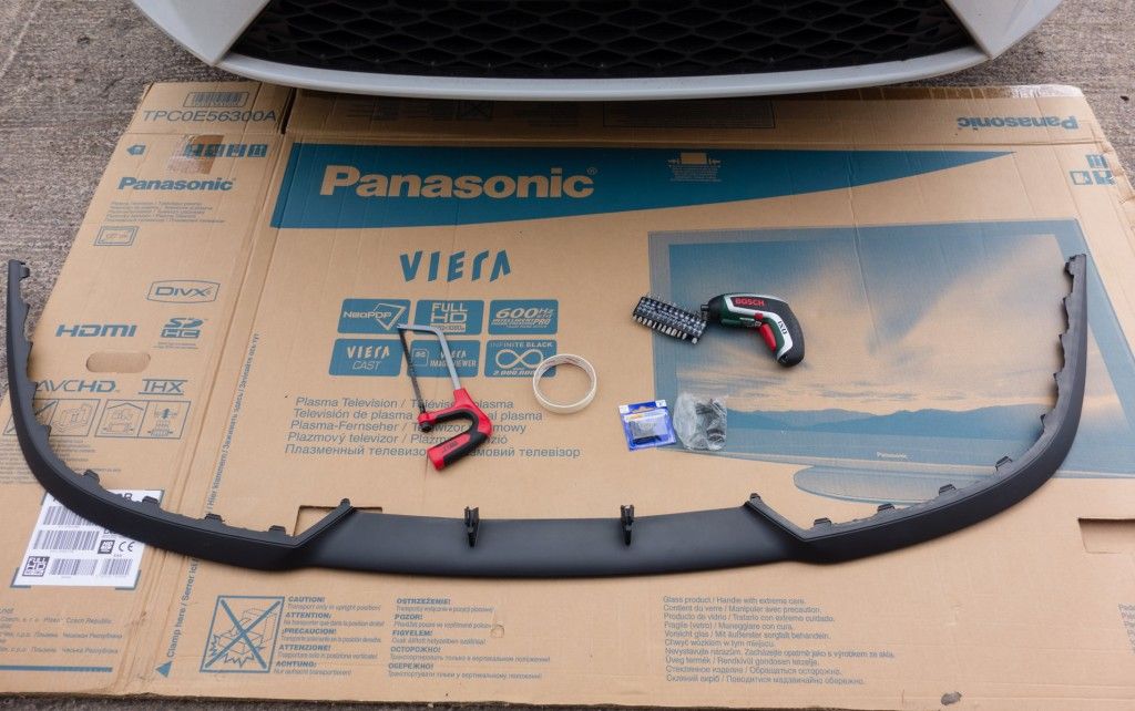

Parts list
  • MK1 Leon Cupra R Splitter - Part number: 1ML805903 (cost around £45 at the time of writing)
  • 20x 1" self-tapping screws (got mine from my dealer)
  • Hacksaw (to cut down the middle struts)
  • Sandpaper (to smooth afterward)
  • Masking tape (to hold the splitter in place when working)
  • Screwdriver (powered if possible)
  • Some cardboard or something soft to lie on when working under the car
  • Drill with a small drill bit (for pre-drilling the holes)

1. Get your parts ready. Some people have jacked up the car for this, but I managed it without needing to.
2. You need to trim down two center vertical struts so they don't push against the bumper. Otherwise, it will push the splitter down and look terrible (and you won't be able to fit it on very easily either).

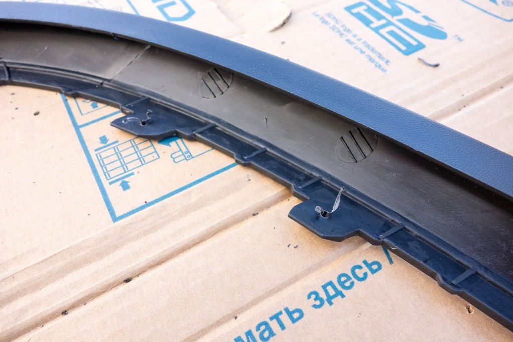

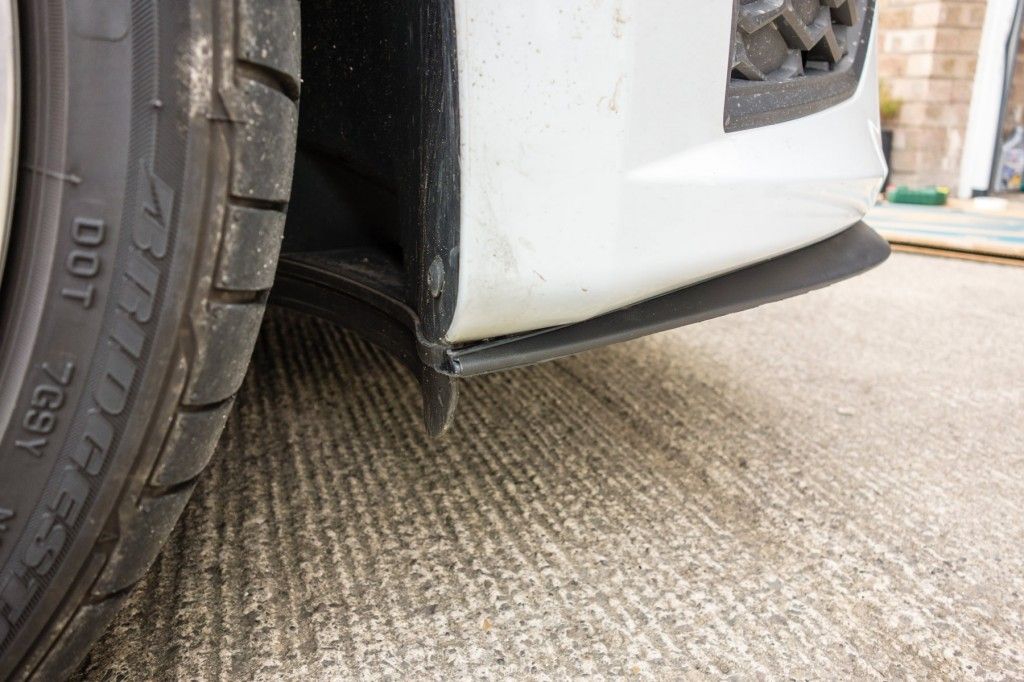

7. Other people who have done this have had to cut the small end pieces to get them to fit. I managed to get them to hook in just next to the small mini flaps that sit in front of the wheel arch.
8. As you have worked around both sides just double check all the screws are tight enough.

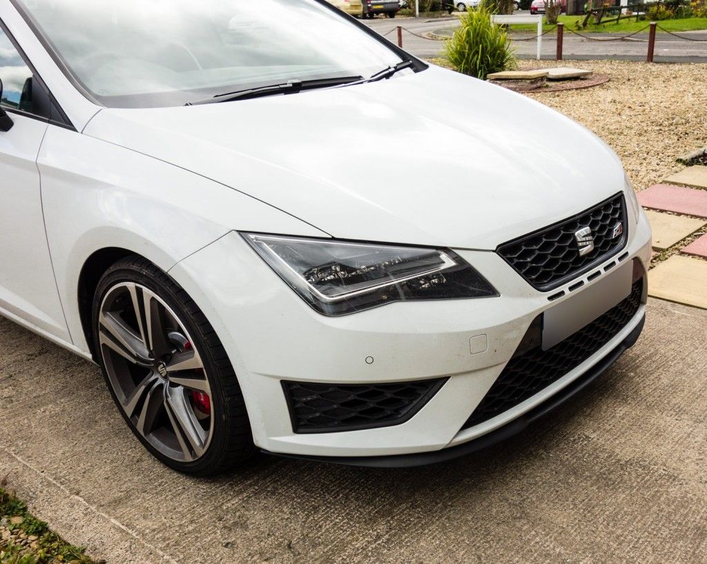

9. Step back and admire your work. Probably best go for a drive to make sure it doesn't fall off.
Great idea for a relatively low cost styling improvement!
