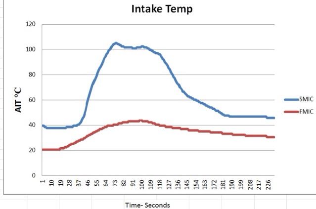

You're going to need an fmic, Phil. Saw a graph logged before fmic and after intake temps with a pd150.
They were sky high after a minute, I'd sooner do that before clutch, standard clutch will hold 200bhp/300ftlbs anyway.
Hope you enjoy it, glad you've decided to keep it!
Edit - found the pic

Hhhmm that puts a new slant on it lol, I have got one which I can get, needs a quick refurb on the end tank as it's split but comes with pipes so I'll go and sort it, I would have picked it up start of this month but all manner of **** happened so it got postponed, I'll email the chap.
