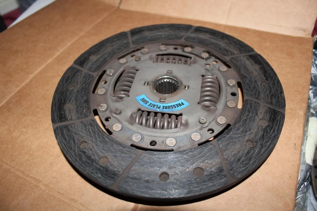

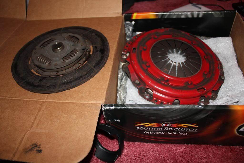

Well new clutch was fitted today :D and all is fine so far woop. As you can by the pictures, the clutch disc was only wearing on the outside so my mechanic said it looks like the disc might be warped and got jammed at some point which wouldnt let the clutch disengage. Just hoping its not the flywheel thats the problem as that hasnt been replaced.
