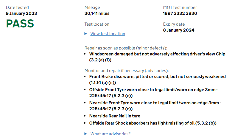

Final question; I've seen quite a lot of "light mist on rear shock absorber" on some Mot histories, how concerning is this?

"Final question; I've seen quite a lot of "light mist on rear shock absorber" on some Mot histories, how concerning is this?"
My wife's last car had this comment on its MOTs for the last 6 of the 11 years we owned it. Never failed an MOT & caused no problem.
My 2018 Leon had the same comment on its 2nd MOT but not on the following 2!
Shock absorbers contain a finite amount of oil.
Any misting is this oil escaping!
Eventually there won't be enough oil for the shock to function properly - but the misting will stop!
My Leon had a misting comment on a few MOT's - got round to changing the rear shocks at 100k miles and they were both completely shot!
You couldn't tell by the usual bouncing the car that the rear shocks were knackered - and if my other half drove the car she couldn't tell - but I could tell, gave weird handling sensation.
Rear shocks aren't too expensive - so if you have misting just budget for new shocks in a year or two.
Yeah I'd agree with that, glad to hear they aren't too expensive.
