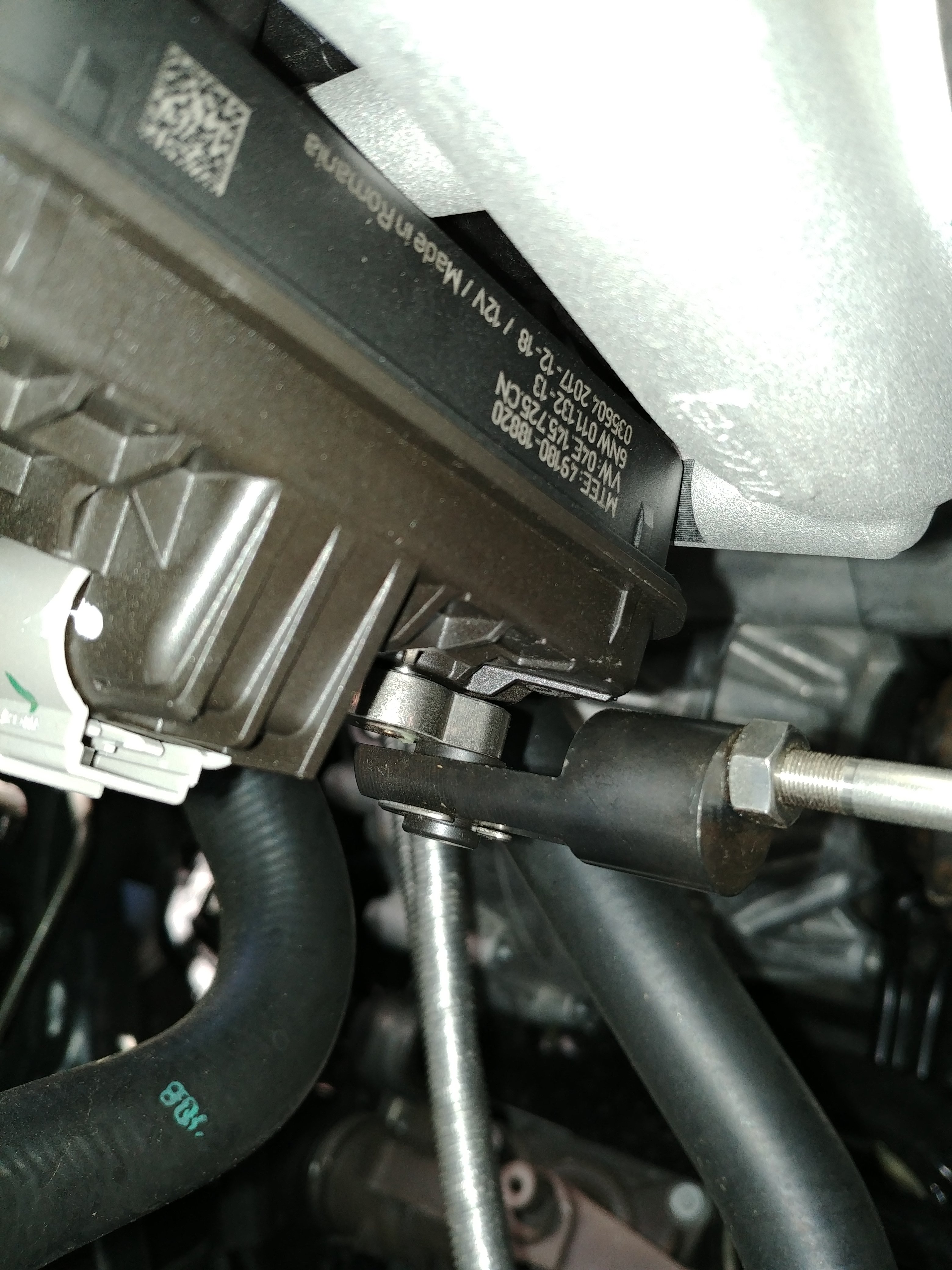

Loose circlip on the wastegate actuator IIRC. There’s a thread on here with photos etc. Annoying but not a problem apparently.

On the rear of the turbo there is an waste gate link rod, connected to the actuator. If it feels loose and rattley to the touch (don't touch it when the engine is hot) then this is likely the source of your noise.
There are other threads on the same subject.

Turbo rod rattle really bad design and make metallic rattle.
You can try with hand when engine cold.
