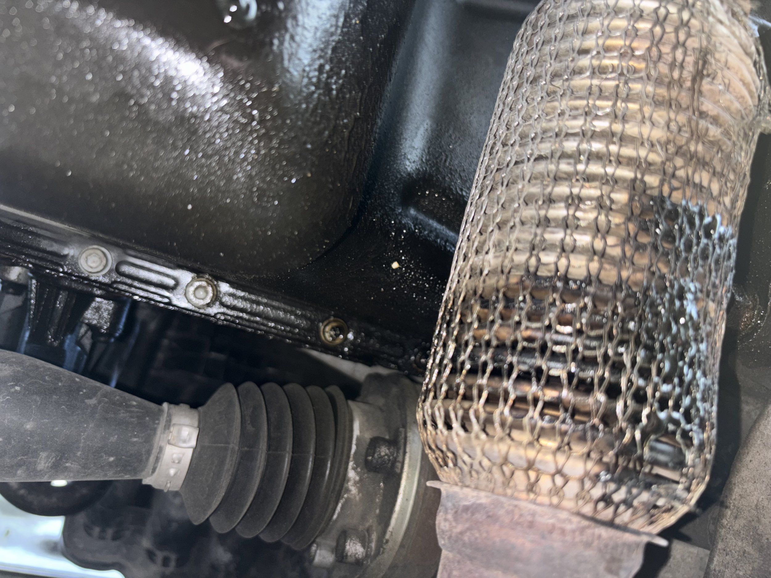

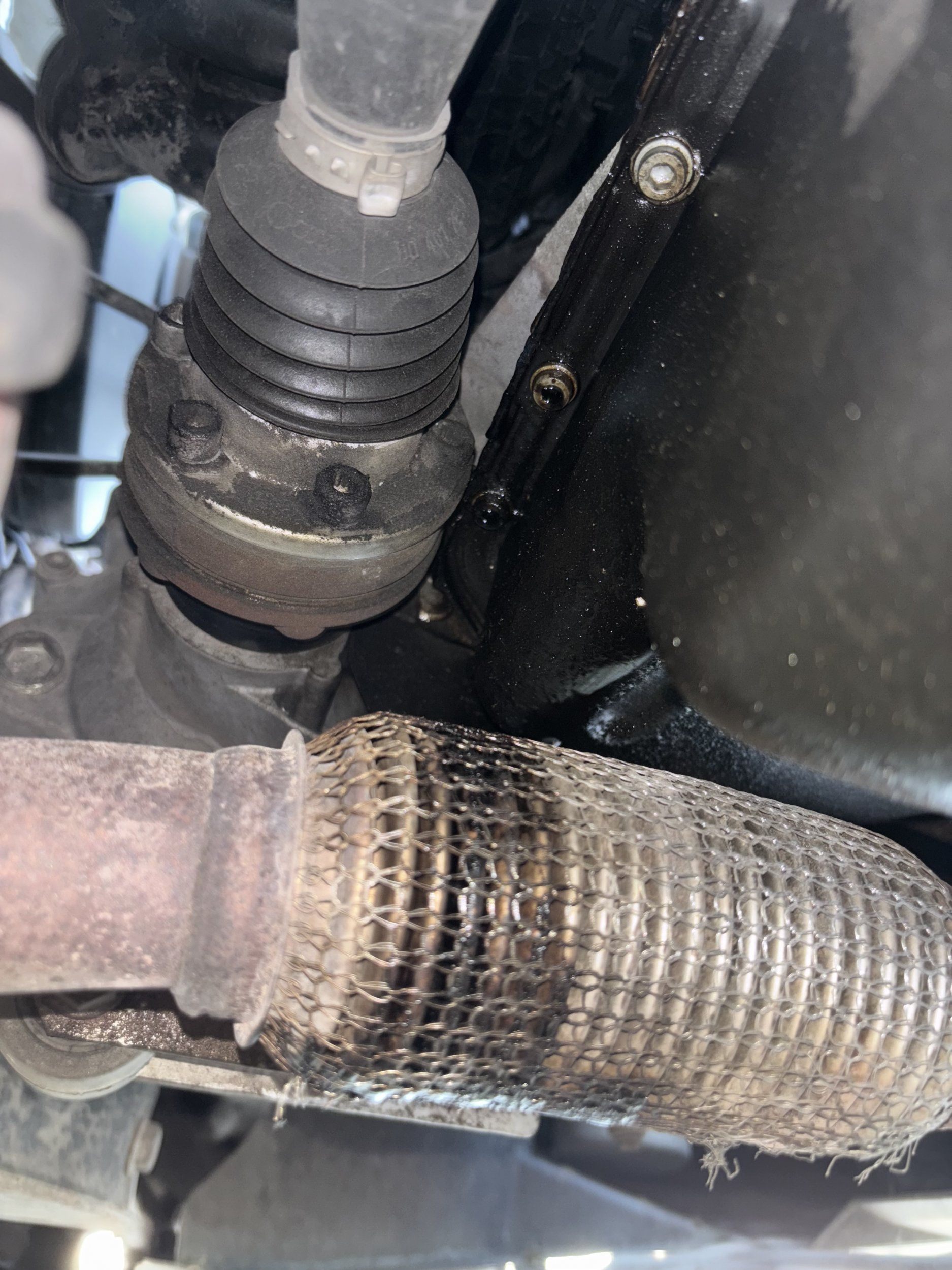

Hi all, my 2012 Ibiza with the 1.4 petrol (non turbo) leaks oil on the exhaust and it smells very bad while driving.
I tried looking under the engine to locate the source of the leak but I have no idea where its coming from (maybe the pan?).

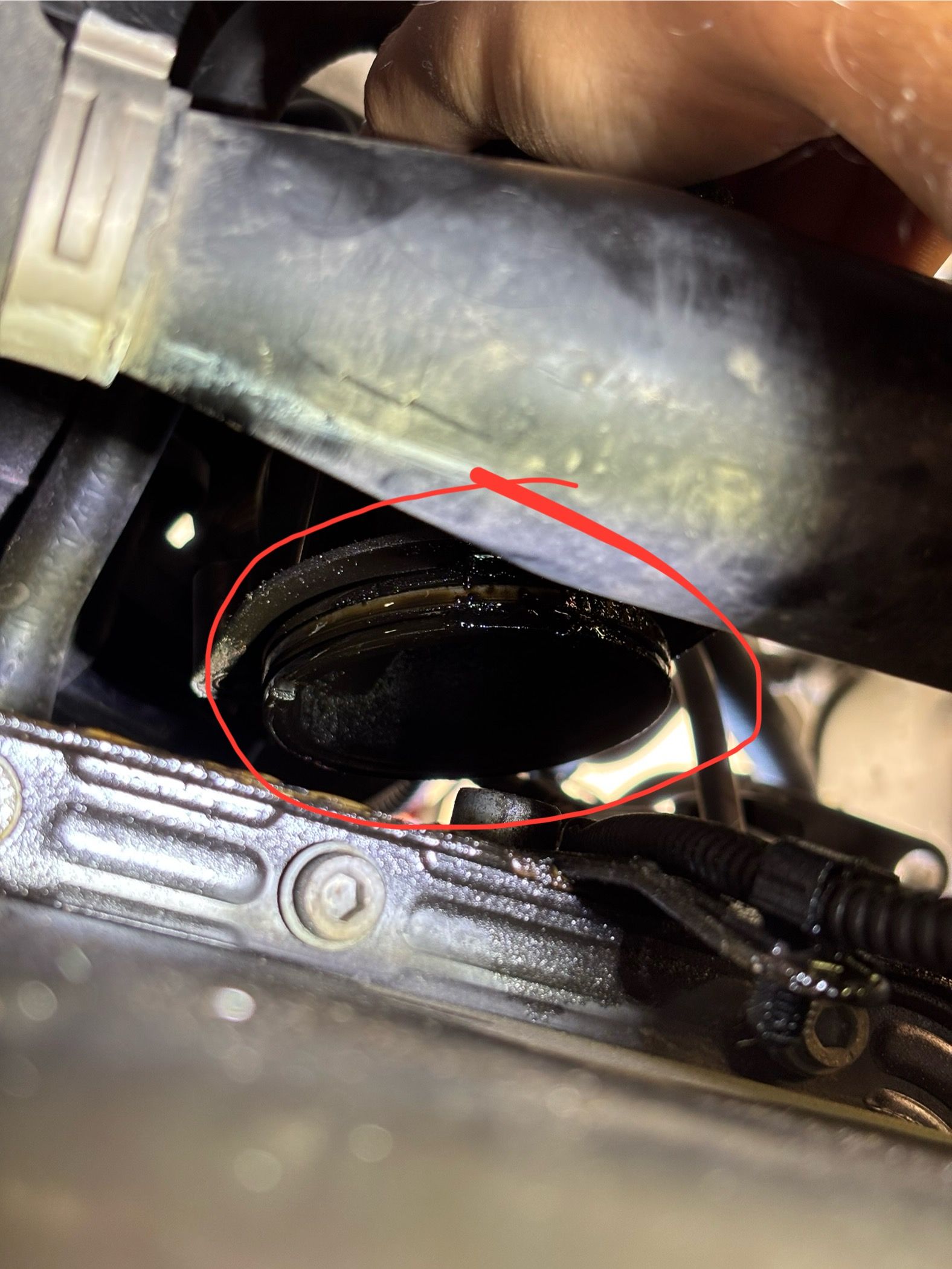

Thank you for replying.
Are you referring to this?
Yes, the overall shape has changed slightly over time and your one might have a small heater in it and a cooling water loop running through it, that it will be in the same location at the back of the engine.

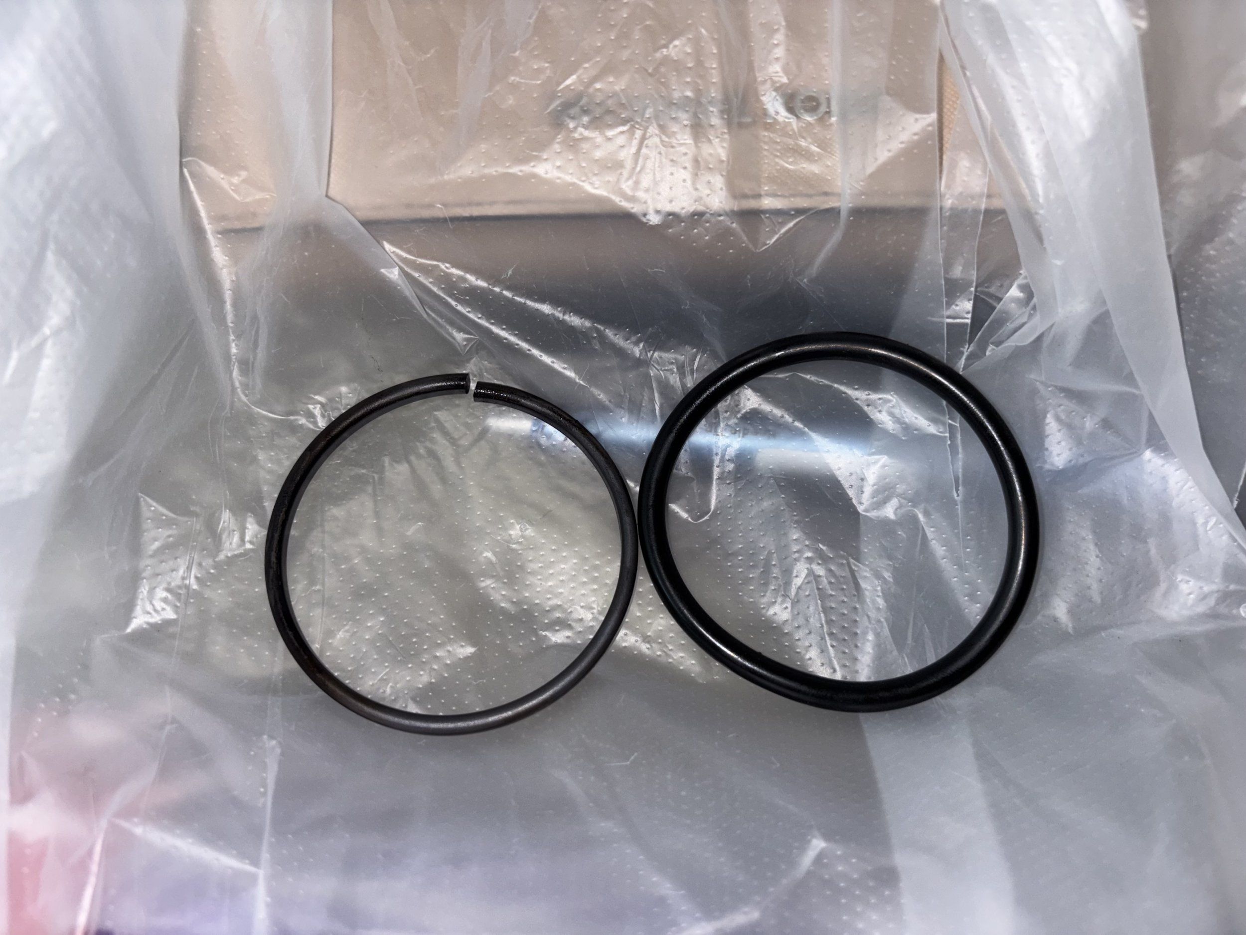

I had the same problem, it was the rings in the oil separator, you can see it in the second photo

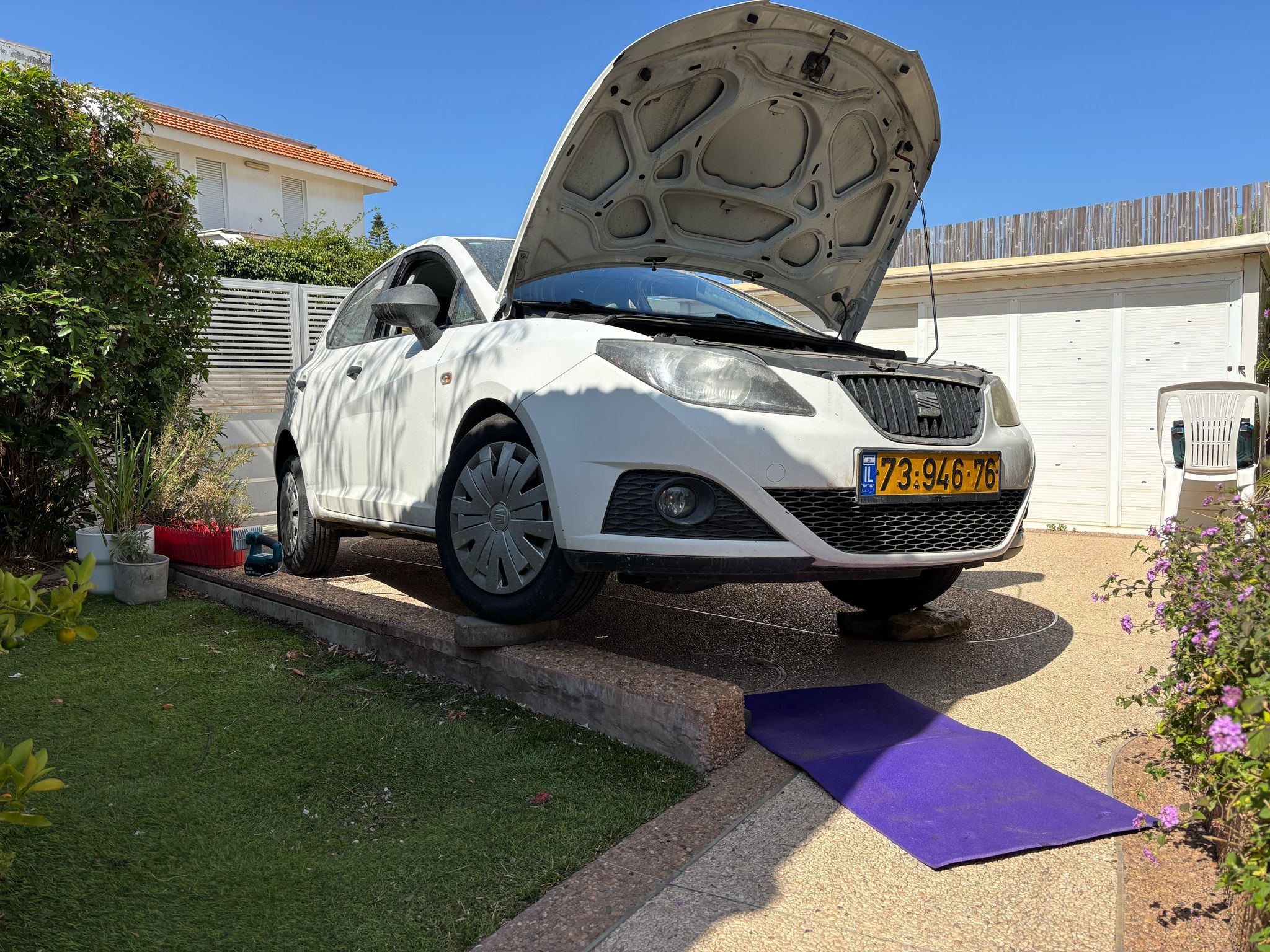

So today was the big day.
First I tried taking it apart from above but I couldnt see anything even without the airbox, so I tried removing it from under the car.

I then removed the bolts of the oil separator, tried removing the lines too but I couldn't remove the clips and I didnt want to break anything so I left them attached, looked into the separator and saw that the main big o ring was leaking.

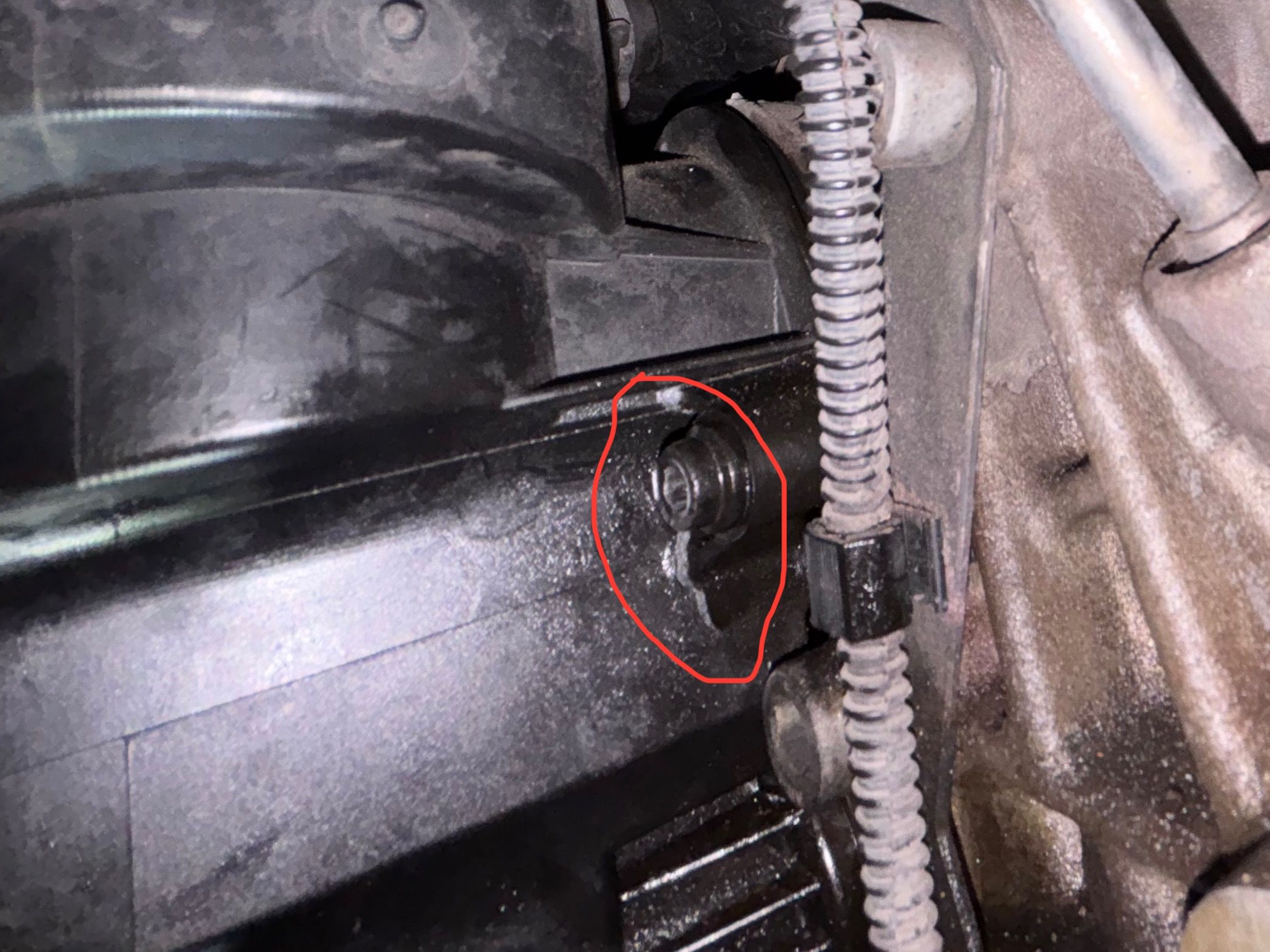

But the I heard something break, it was the arm of the right bolt of the oil separator, it didnt break apart but it created a crack.
The o ring was too thick and needed much power to push it into the engine so the plastic cracked.
After removing it again I inspected the separator so see if the crack is also from the inside, but I think the crack is only on the outside.
So I got a smaller and less thick o ring, replaced it, put some RTV on it and on the crack from the outside and attached the oil separator back to the engine.
I hope this fixes it and the crack is only on the outside because I didnt see anything while looking from the inside.
