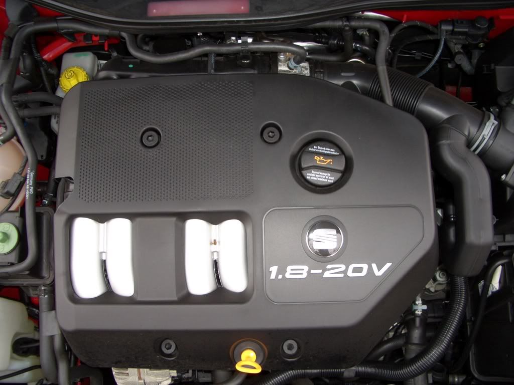

Are the 1.8 20v and the 1.8T Engine Bays the same. So that an induction kit for one would fit the other?
All 1.8T engine's are 20V so there is only one = 1.8 20V Turbo
Yea Dave but I was just saying that all the 1.8 turbo engine's are 20V's
So it's all the same, apart from one has a Turbo. So, 1.8T kits should fit on an 1.8...
The airbox is just out of shot.
Looking at that, I'd say the airbox is smaller than LC (with the MAF further towards the nearside wing by maybe 2") This would leave you less room for replacement induction / filter.
You would also need to check your MAF outer diameter - if it's 70mm then you haven't got a fit problem on that.
