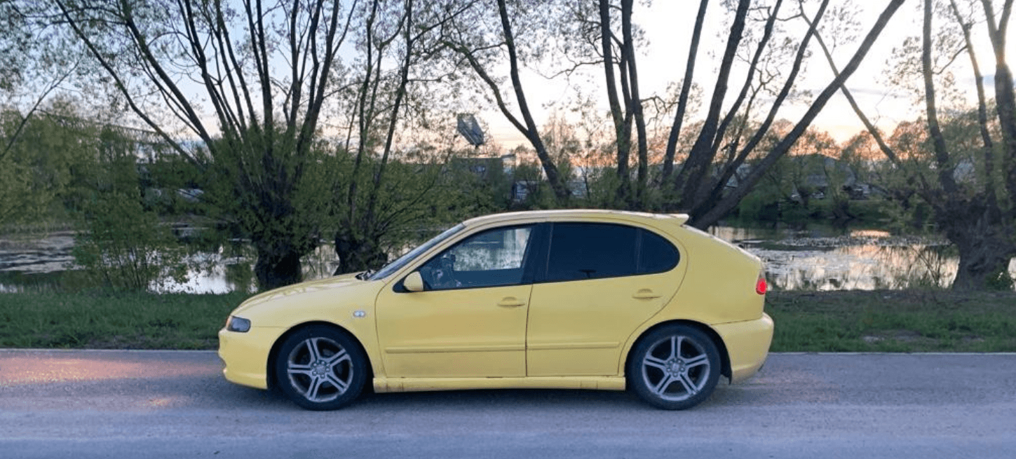

Sory for my language. Im new guy in leon world.
I buy mk1 leon top sport.
Saw yellow leon when i hawe only 9 years and always want this car. Now i get when i hawe 29
Work is lot but i try build Nice leon. Start body repair, then engine rebuild, then missing extra install but that i start october or november when latvia start winter
1.9 tdi ARL 110kw
6speed manual fwd.
Now done jobs not A lot
Change 1 abs sensor
Change oil and filters
Change front door locks
To do:
Weld rear wheel arches
Repaint all car
Rebuild engine
Install 4x electric windows
Install cruise control
Install cupra interior
And lot things

Welcome to SCN.
Sounds like you’re going to be busy.
Shame yellow ones suffer so much from faded paint. Love onvi yellow.
Sure it will look great once you’ve finished it.

there will be a lot of work on the car, but it's worth it
as far as I can tell, the car originally came from Spain, so the color has faded and it is also a little rusty due to the salt that rubs on the roads in winter.
parts are harder to find, so when here they are not so much.
but thanks for the well wishes. the car will be revived
