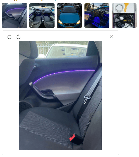

Hi guys, I`ve recently bought an ambient light kit for my `10 Ibiza FR 2.0 TDi.
I have to tap in a 12v source which has to be controlled by key switch on (when turning the key it has to turn on), the problem is that I have to find this power source inside the door panels, where do I get this power source? Power Window Switch? Door Locking Mechanism ?
Also it so happened that I`ve found in the reviews page of this kit that other had it fitted in their Ibizas so it makes me think that is doable.
I`ll drop the screenshots below.
Any help would be much appreciated.

Don't go taking any feeds from inside the doors ! as I guess it is all canbus and would not have a 12 power any way

I would feed 12v off pos off battery and maybe run through spare fuses location in fuse box, t’ing off live wires isn’t like old stuff anymore
