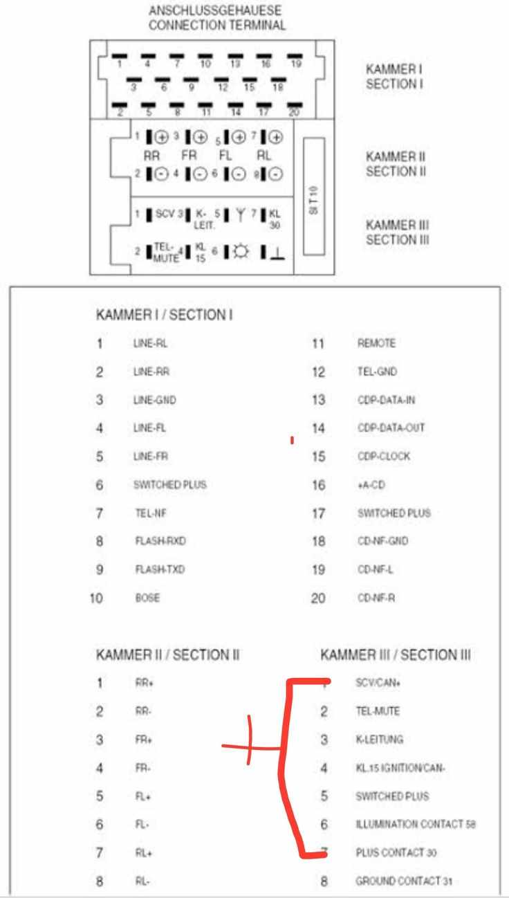

Hello, i'm replacing my 1din center console for the factory 2din with the nav radio, but the pins on the connector doesn't seem to match.. radio just says "safe pin not connected" I had the aura cd unit before. How do i adjust the connector so it works? Thanks
Just the diagrams, one is for the aura cd and the other is on the nav radio. From what i found, can i just splice the 12v and route the cable to the safe pin?
