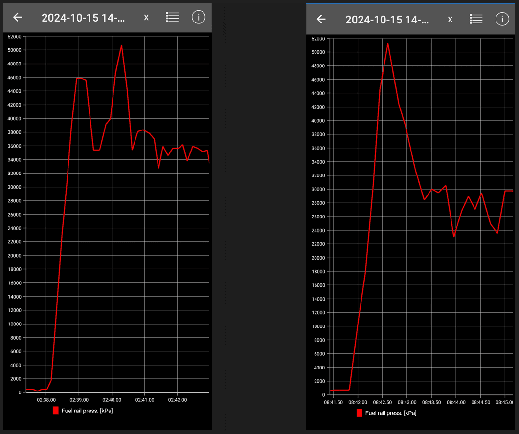

I noticed on some fuel rail pressure logging I did that on a long crank (in this case around 2.5 seconds - left graph) it didn't get past 50,000kPa, and only fired when it got to 50000kPa - where on a normal crank/start (right graph) it went straight past 50,000kPa and fired straight away.
The rail pressure is controlled by the control solenoid on the HP pump and fine tuned by the pressure regulating valve on the rail 057130764AB.
My current 'best guess' is maybe this rail pressure valve is 'playing up' - trouble is they are quite expensive to just throw one to see, and the control solenoid is even more expensive.
