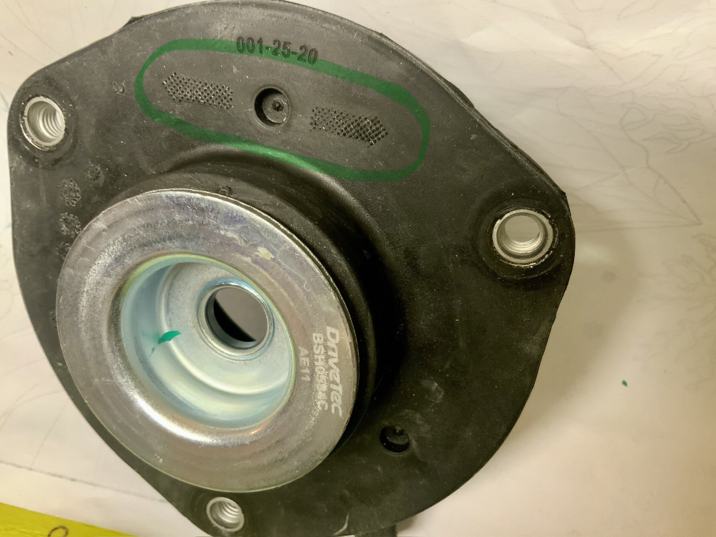

I have a 2012 seat Leon that has an annoying pinging noise (driver side)
I’ve replaced the springs mount and bearing as when I bought it 8 months ago it had a broken spring on the driver side but still getting a pinging sound so removed it and added more grease to the bearing and put it back on but still has the same problem so removed it again and turned the spring around but it still has the pinging sound
Please can someone help
Hi
I’ve bought a new mount and bearing
Please can someone tell me from the picture what direction the arrows should face on installation
Is it pointing at front wheels or front to back wheels
Thanks
I think that it means front - rear, so if on the RHS or the LHS that designation works, it is more in the way of forcing you to fit the mount in a certain "rotation" as all 3 fixing holes seem to be equi-spaced.
