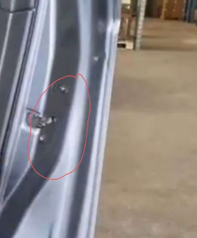

I don't quite understand what component is actually freezing,. The door opened from the inside, then wouldn't latch shut when I tried to pull it closed.
The door lock unit is placed in the red circle area.
Could also be the wire from inner door handle. That is not so easy the heat.
Okay thanks, this is the area with the problem on my Ateca. Usually the heat works, but not on the last occasion.
