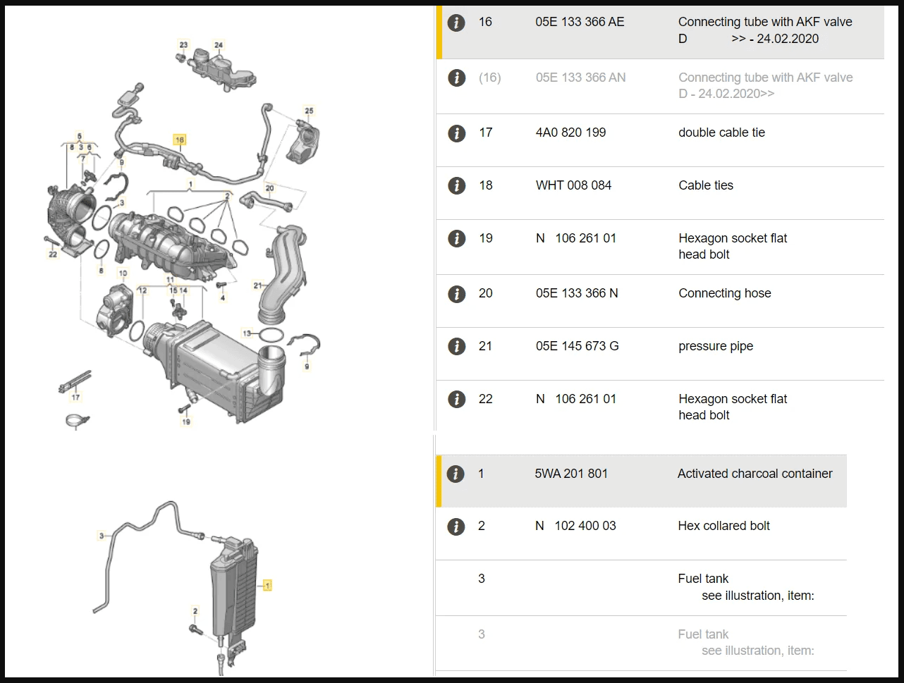

Needs new EVAP valve this picture is from 1.5 tsi assume that would be same on your engine part number 16 but double check this as you should able to see this valve on the top of the engine
You looking on your negine for something similar to this https://www.ebay.de/itm/385646181854
I recommend replace all assembly two valves and the pipes as displayed on the picture for new part to avoid any other issues in the future
