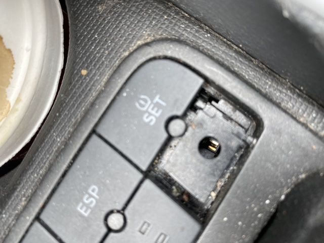

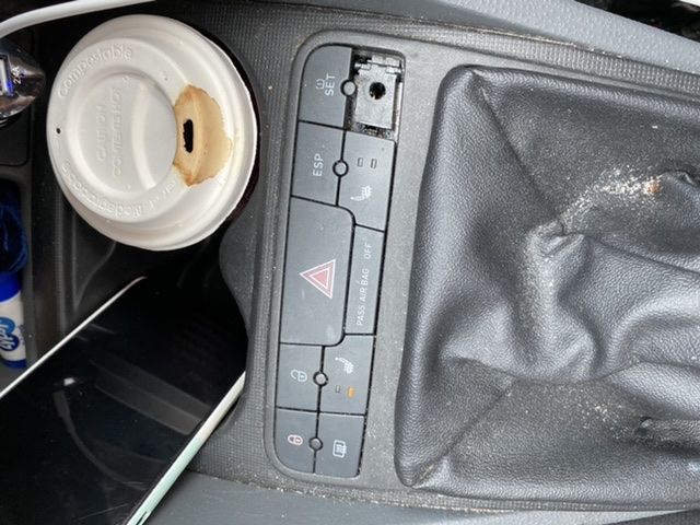

Hi all,
I have a SEAT Ibiza ST 1.2 TDI Manual, 2012, 6J 1st Facelift.
The last few weeks the right side speakers hasn’t been working when using AUX, so today I decided to look what might cause it. I found that the 3.5mm aux input was loose. And when I pulled the cable out to inspect it, the actually input socket came off and fell in to the middle button panel. Any ideas how this could be solved? Would you think I need to replace the entire button panel? If so, how is this done and where can I find one?

Hey! FYI, I managed to fix this by replacing the entire switch panel. Bought an used one for sub 50€. Got the old one out by removing the middle panel by the gearknob, and then just easily removing the cables and plugging in the new one. Done in less than 10 minutes.
