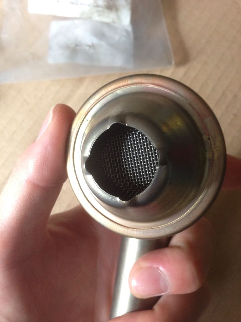

No get it out ASAP. I did the same a few months ago. I had to move the car across the drive so I started it briefly and all was fine however I dropped the sump straight away. Found the bit of plastic wedged in the mesh on the oil pick up pipe. This will affect flow and I'm so glad I dropped the sump in the end. At the end of the day a few hours dropping your sump spent or a possibility of engine failure.
By the way there is no way that a piece of plastic can get to the oil filter as the only way out of the sump is through the oil pickup with has a mesh type filter on it. Obviously this has to be clean for obvious reasons.

the pick up isn't meant to be a filter. its there to protect the oil pump from large objects that may end up in the sump that could potentially ruin the pump and engine, any objects stuck in the mesh will affect flow. even with that mesh on the pickup it still could ruin the engine if there's not sufficient oil being supplied due to that piece of plastic. like I said 5 ltrs of fresh oil, sump sealant which doesn't cost that much plus a few hours out someones day isn't a lot when you think how much an entire engine will cost plus the man hours to fit.
I was debating about whether to drop mine when my dipstick disintegrated into the sump. deffo glad I did now. the pickup on mine was clean as a whistle probably due to the fact its been serviced well except for the bit of plastic that surprisingly took up a lot of room on the mesh. glad I didn't drive it or have any issues. its just not worth the risk

As you can see this is a new pickup pipe i have in spares, it's a very fine filter gauze as it is, over time this can become restricted with dirty oil, narrowing the passage ways, adding to that a bit of plastic you can see the potential for issues
