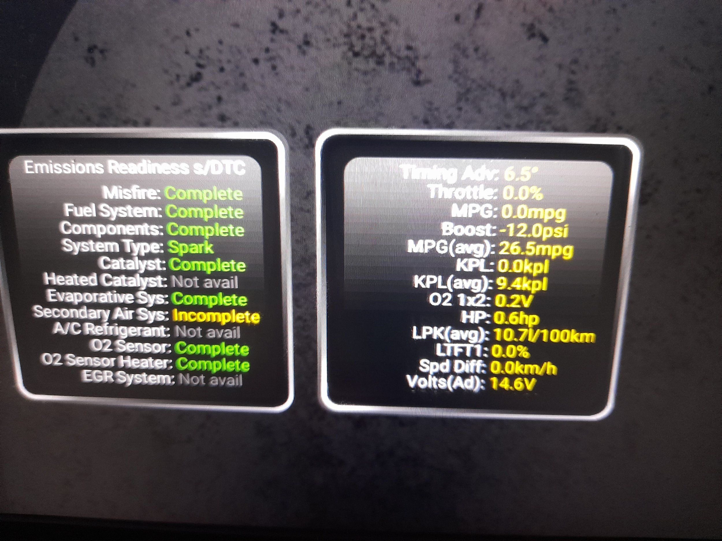

I reset the ECU earlier today and went for a short run and fuel trims look good at 0.8 idle and 0.0 long term, everything I can see looks good in the data the only thing I could see was the MAF seemed a bit low at idle? 2.0-2.2g/s, Im getting no codes at all in VCDS and no light flash or anything when the hesitation happens, I'm completely stumped to the point Im getting a bit depressed about it, I just want it to run right and I cant keep throwing money and time at it.
heres a couple of pics of Torque Pro monitoring at idle.

The ECU was reset just before I took the pics of Torque Pro so I had only done a couple of miles, the usual long term fuel trim is around -4.7% to -6.4%.

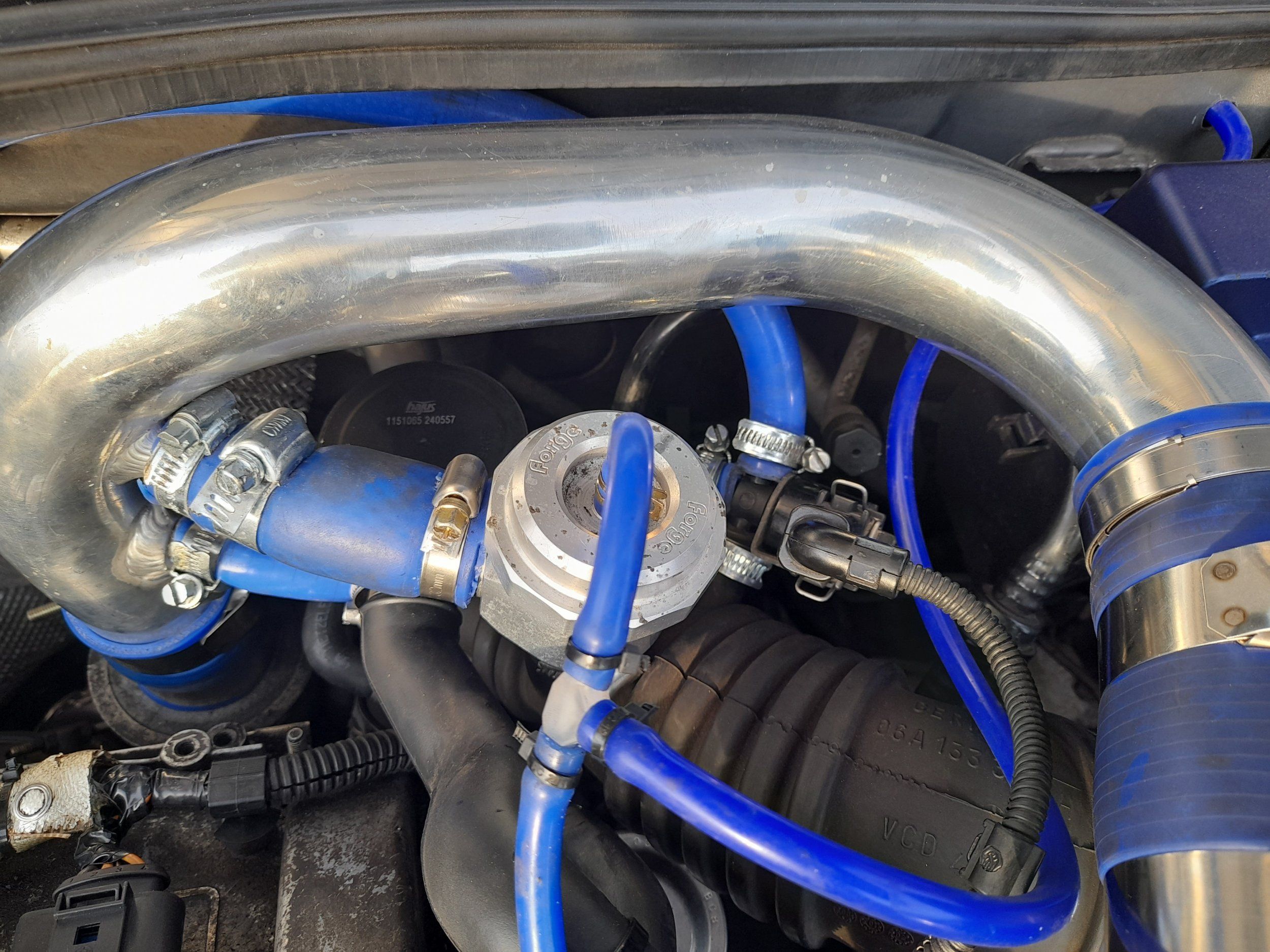

Do you also tested the Forge 007 with the finger test? Push in the piston, hold your finger on the vacuum nipple. The piston should stay in place, if not it should be serviced.
Also the latest service kits from Forge added a rubber O-ring on the piston, which allowed for better seal. I ran with a Forge DV006, which flowed better than the 007.
Forge 006 service kit
Forge 006 new vs old piston
thanks for the help you guys, we could be getting somewhere.
regards the 007p, I just serviced it with new grease and new yellow spring from Forge, I also made sure that when I press the piston and cover the vac port the piston holds, then pops back down when I release my finger so seems all good.
Im just this minute back from a 15 mile run, the long term fuel trim is sitting at -4.7% when I got home so roughly the same numbers as always, seems to be running a bit rich.

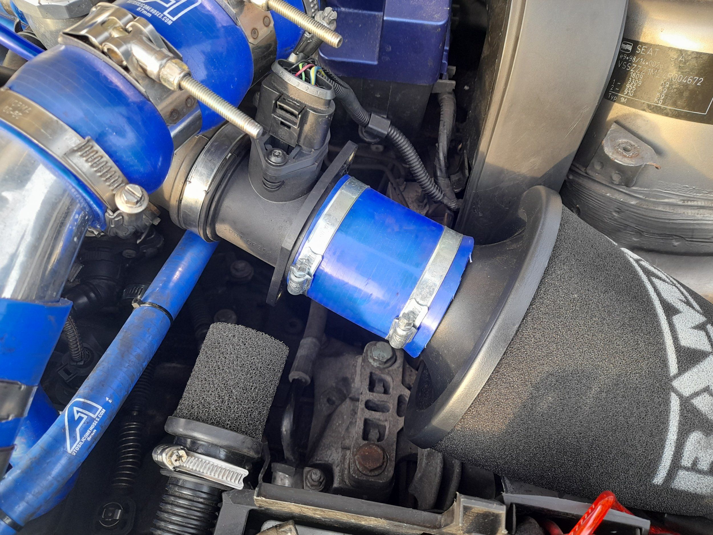

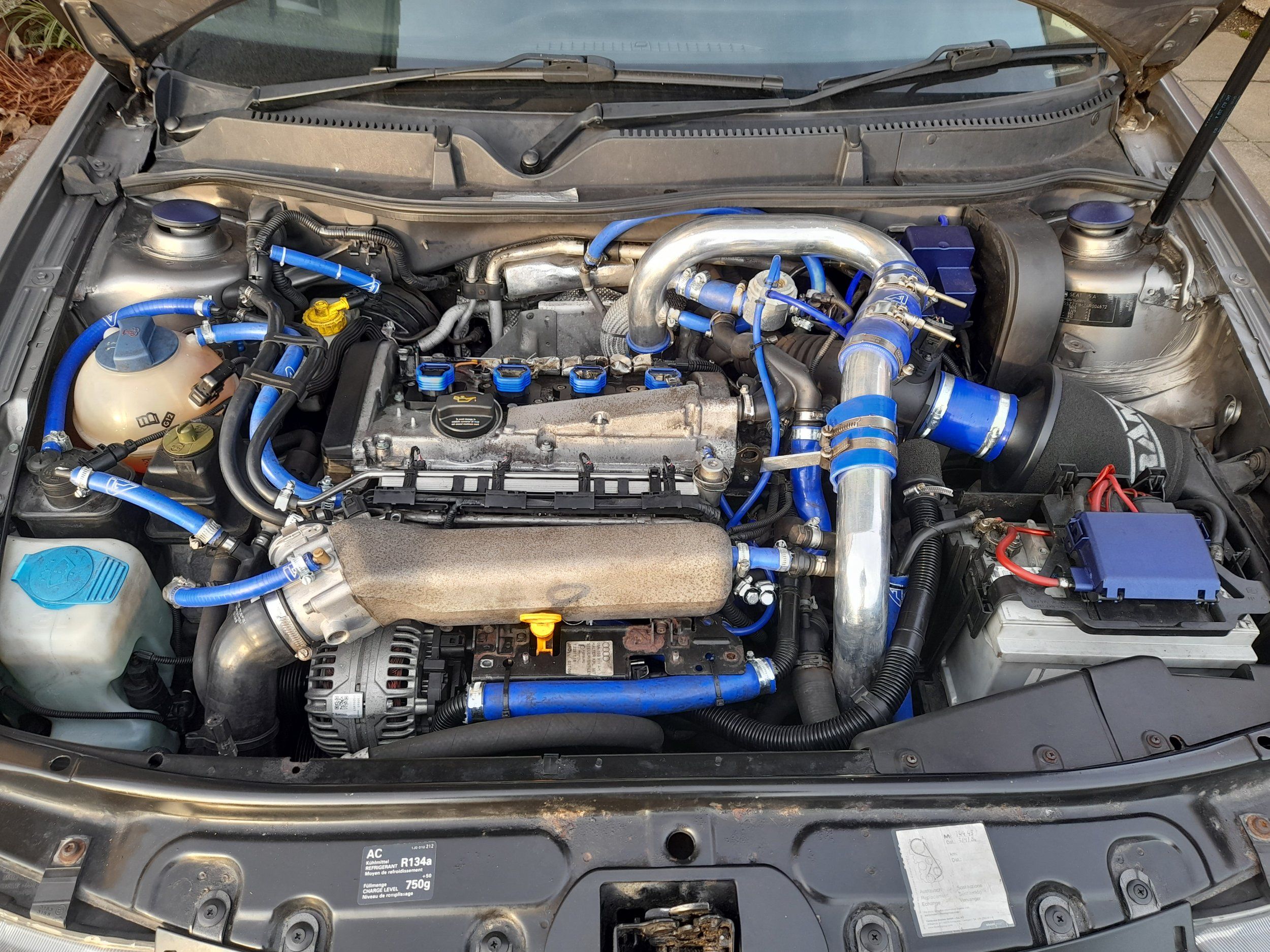

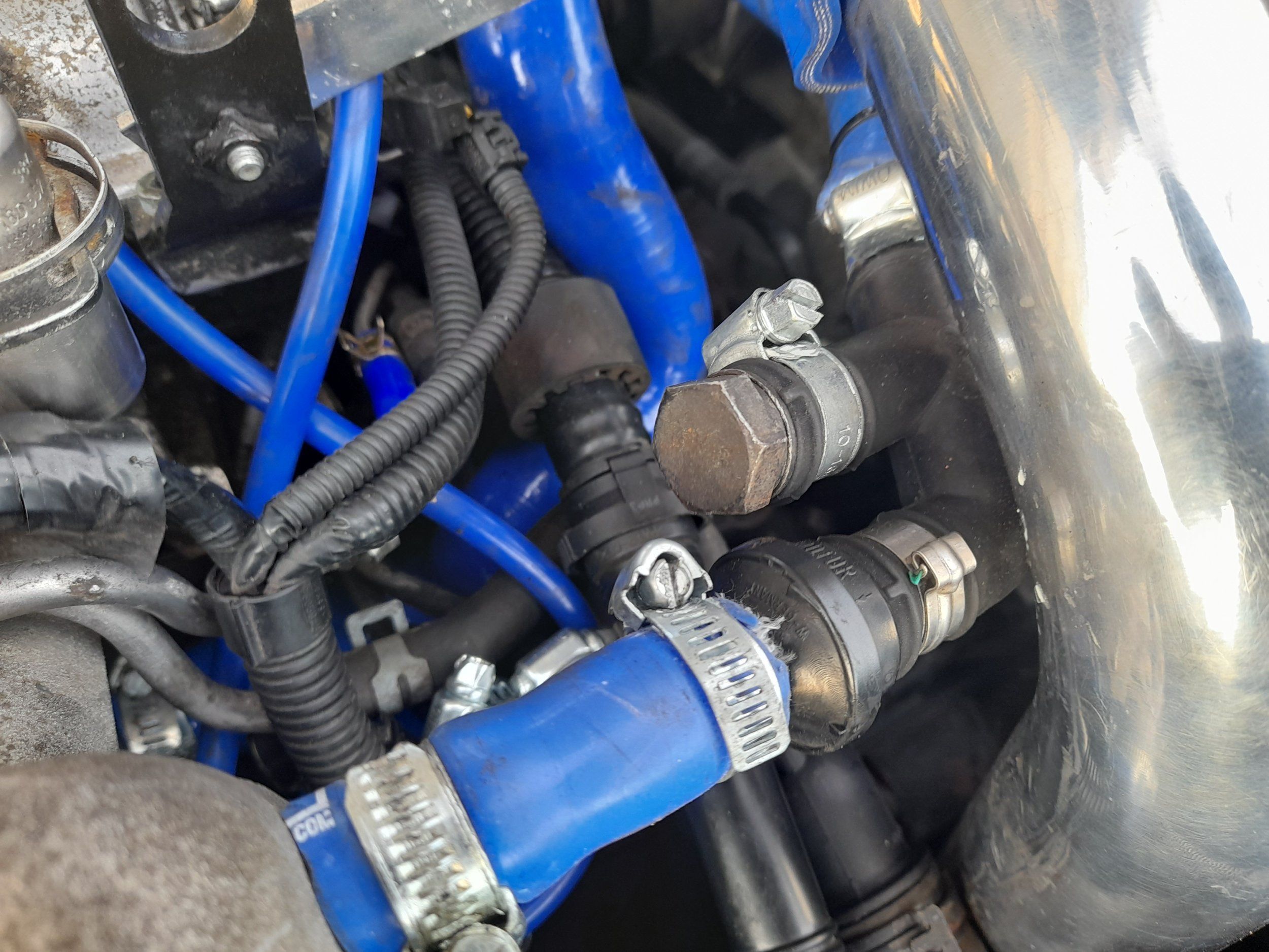

heres some pictures of the engine bay see if anything can be spotted...

started stripping all the blue hoses out around the N75 to see if anything was burst or if the clamps werent done up tight, everything seemed to be fine but now that Ive put everything back on and took it for a 10 mile run it seems the hesitation is gone from full throttle, the turbo peaks at 20psi and holds steady at around 17psi, didnt feel anything that felt like it was cutting boost and now theres no juddering boost gauge either, I wonder if one of the clamps was stuck and although it felt tight it just wasnt tight enough to be holding above a certain psi. (im not going to count my chickens with this too early though, will see what its like over next couple of days before i call that fixed)
