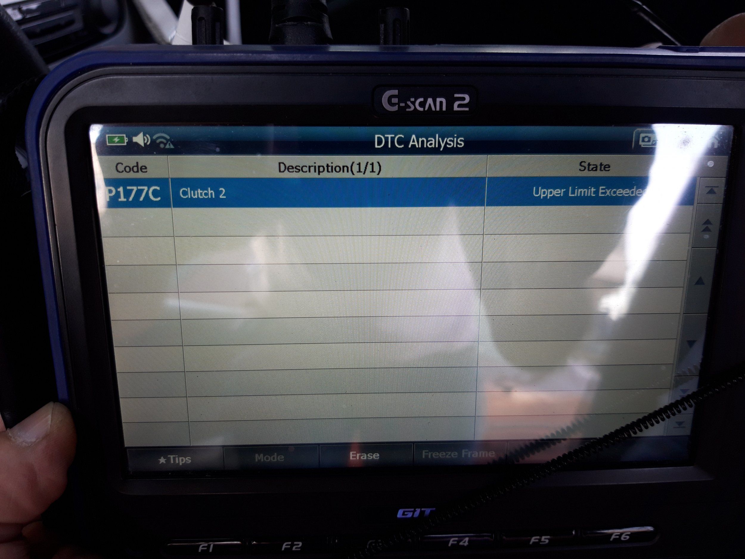

My car is Seat Leon 2011. Whenever I turn it on and put D it is so slow to respond that I turned it to from N to D. The attached picture is the car computer check for the car. Can any o
ne tell me what the problem is??
That error usually means the clutch pack needs replacing.
There was a recall on the early dry clutch 7 speed DSGs to switch them to mineral oil in the mechatronics as the original synthetic oil was found to be slightly conductive and could cause electrical issues.
It's worth asking Seat if your car was affected by this and if so if the recall was done.
