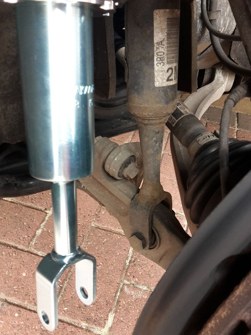

after buying some coilover which where FK AK Steet coilovers for an Audi A4 B7 none quattro i can confim they fit onto the exeo with out modification.

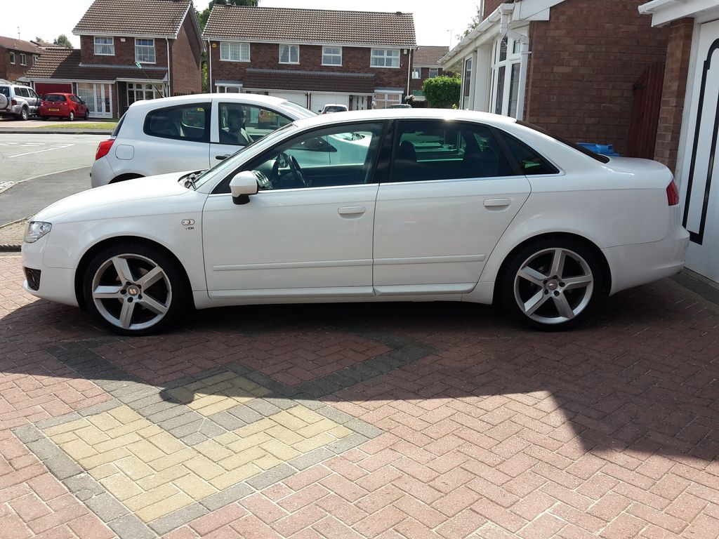

Looks great! I have same car and plan to lower soon. What's the ride quality like I.e will the Mrs complain? Lol
No I'm not lowered but I have the Sport Tech which has lower springs compared to the SE.
I got mine aligned as an Exeo last week and it drives better, so it confirms my suspicions that the A4 B7 settings aren't right for our cars.
Yours looks good lowered, mine scrapes speedhumps as it is. A dead badger did some hefty damage to my undertray, I recommend removing yours as I'm sure they're not cheap to replace.
I've just fitted H&R monotube coilovers to my car. I ordered the exeo coilovers but the have a label on for the A4. Everything matched up as it should.

I think the ride is fine on them. They budget coilovers though. It's a little more bouncy but not crashy and still comfortable. It corners a lot flatter I feel a lot less role. It does scrap over some speed bumps so I have to go over at an angle but not that slowly. Over all I'm impressed and I think it gives the car a better stance and meaner look.
