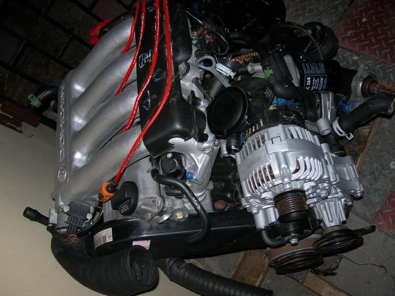

I currently have a 16v abf out of the vw golf, we never got this motor here in South Africa(very delayed). Seeing that you guys have the motors in your cars standard what would you recommend mods wise to acheive +-140kw on the flywheel? Im thinking Cams(268/272), slight headwork and management...

and the motor..

Thats one clean engine, did you get it new? 200 bhp at the crank is achieveable easily enough (if not a tad expensive) search on here for rob t and f2 stu's posts.

That motor looks like it never been in a car!
Anything more than 268 cams and the stock engine manegment wont cope albeit remapped (chipped), have know ABF's with cams, head work, exhuast & remapped acheive 180-190 at the flywheel.

hey man no the engine is not new, in japan they scrap cars after a certain mileage and sell the parts of seperately. Its usually 60000km on the clock when they scrap it, so its just been run in:D . I did a bit of cleaning the moment it arrived!
