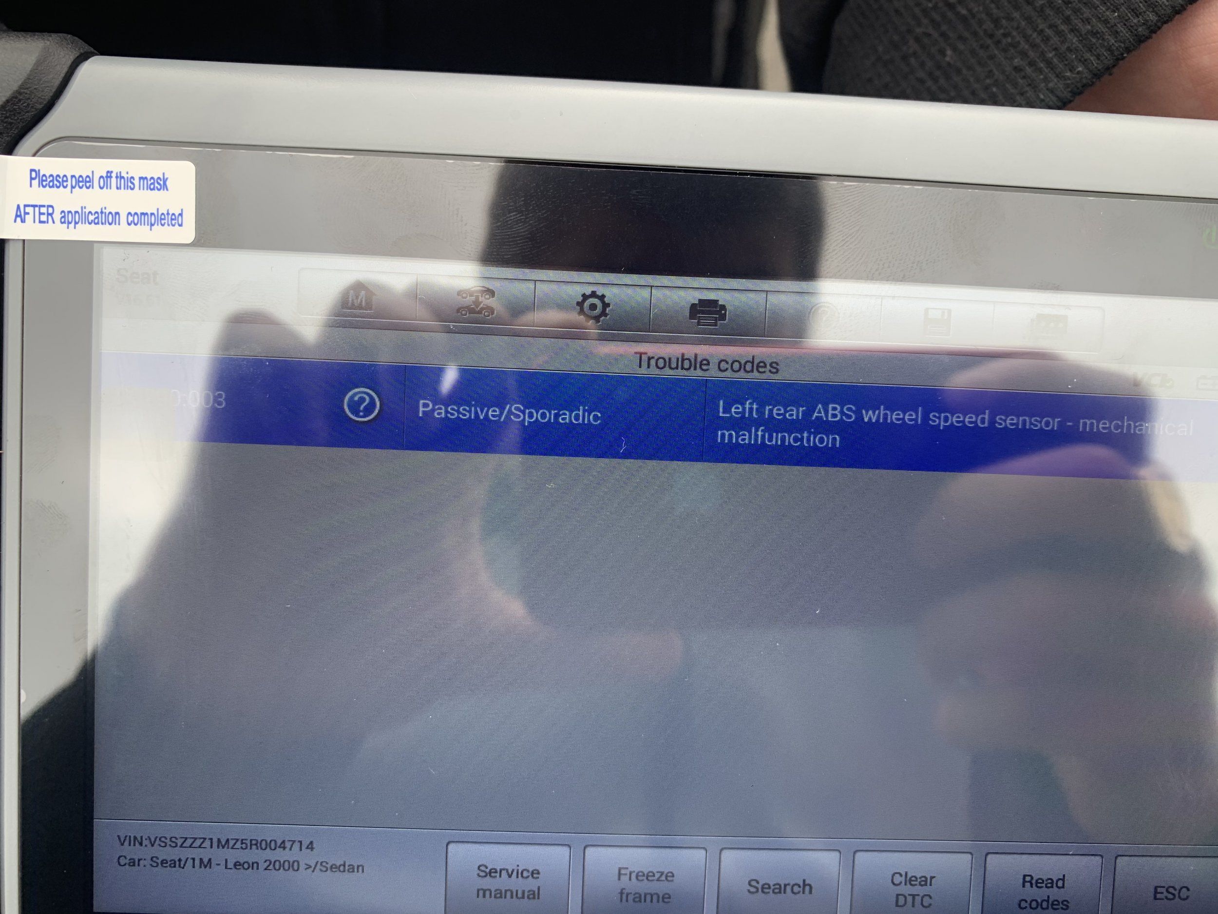

Kim&Macauley2020 Kim&Macauley Sep 3, 2017 8 0 Cornwall Jun 5, 2022 #1 Hello I have this code come up I’ve changed the rear left sensor to a Delphi one and the code is still coming up any help please? Attachments DC479CFC-24A0-47BD-BE00-41D0E44D1415.jpeg 705.2 KB · Views: 89

Seriously? Active Member Apr 20, 2018 1,505 1,108 Jun 13, 2022 #4 Could be the reluctor ring ; not sure where it is on your car but often built into the hub bearing or part of the cv joint.
