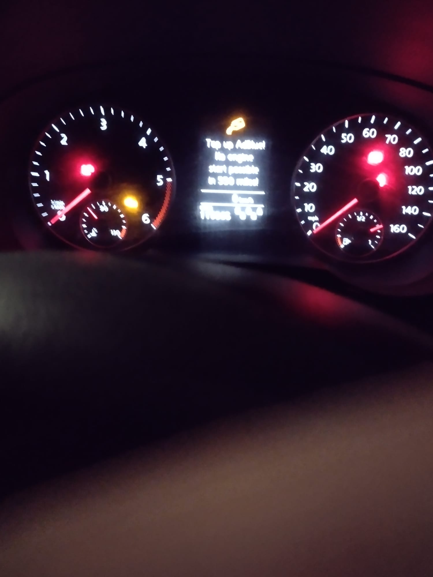

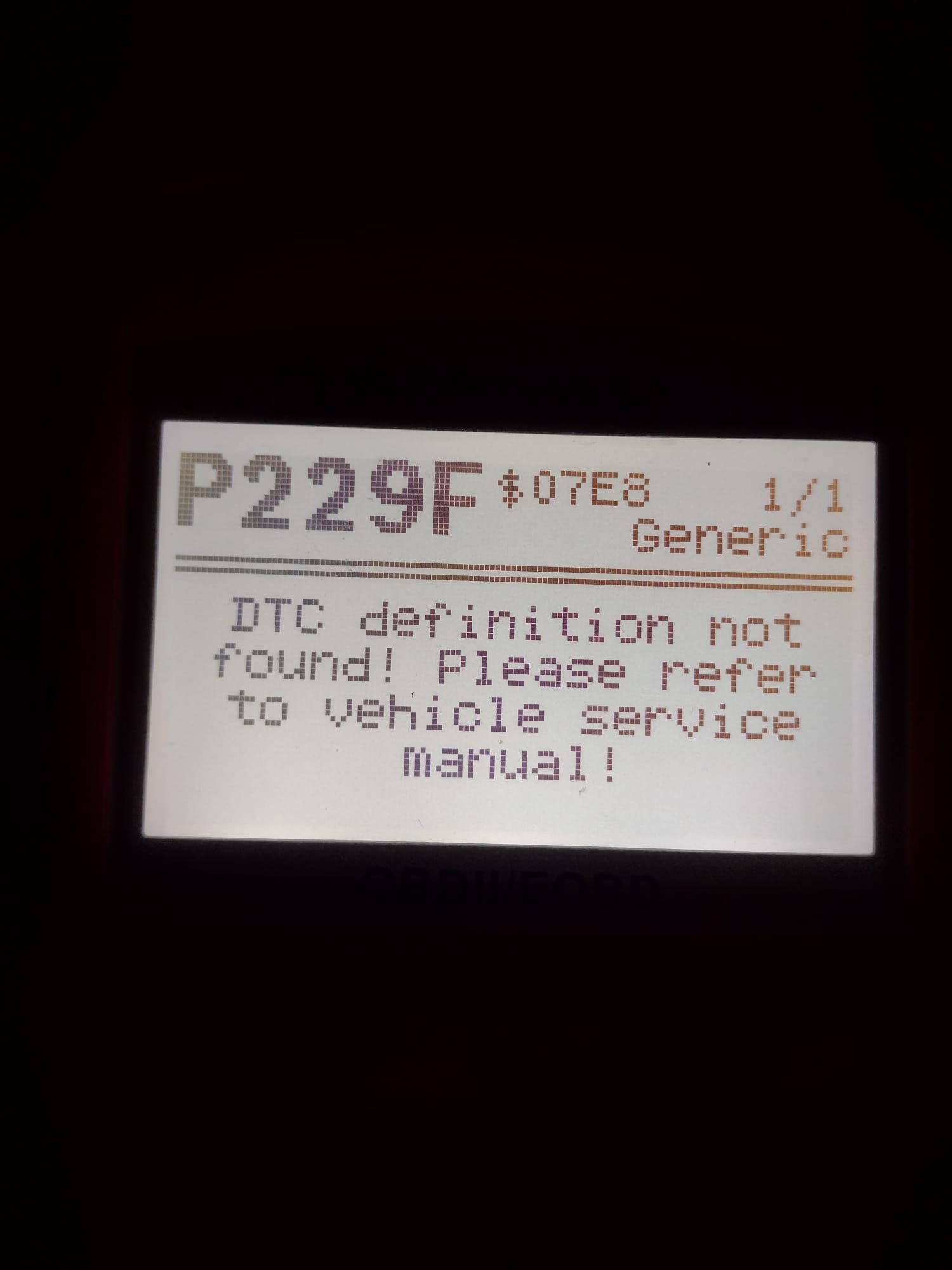

Hi there, I am getting "Top up Adblue No engine restart after 500 miles" although the tank is full. Also getting errors below
Error P203B: Reductant level sensor circuit range performance(It was coming on for a while, however ignored it as it was intermittent)(this is stored error)​
Error: P22NF: DTC definition not found, refer to vehicle manual(its pending error)​
Snapshots for errors attached
I have tried the below.
1. Iginition on for 30 secs(no car start) and start the car after 30 seconds
2. Ignition on for 30 secs(no car start), and press accelarator completely down and slowly get it back up and ignition off.
3. Drove for a bit after starting the car.
4. Cleared the errors by using diagnostic tool.
Did not try below:
1. Did not disconnect the battery and put it back again
2. Did not try new or refurbished nox sensor
3. Did not check if the injector needs clearing the cristals
4. Did not check if reductant level sensor connecctions are in place without any loose connectivity
5. Did not replace reductant level sensor.
Let me know the sequence to follow in Did not try or any easy fix this before the engine does not start

Level sensor in the tank could be defective, or you haven’t put enough in/you’ve overfilled it
If the problem is still there in ~100 miles then I’d be concerned, a lot of people just disable the adblue system rather that paying disgusting amounts of money to repair it
Add some Forte adblue additive to the adblue tank, and every time you top it up. It helps prevent crystalisation.
The error is gone :):), it makes my day pleasant; however may be there is groundwork to prevent it from happening again, especially those errors. In my case looks like some circuit or loose electric connection, as these errors are intermittent.
As I added AdBlue yesterday, could I add Forte in the next couple of days as waiting for delivery.
Yes add the forte regardless :)
And don’t overfill the tank. Add the amount it tells you to add
