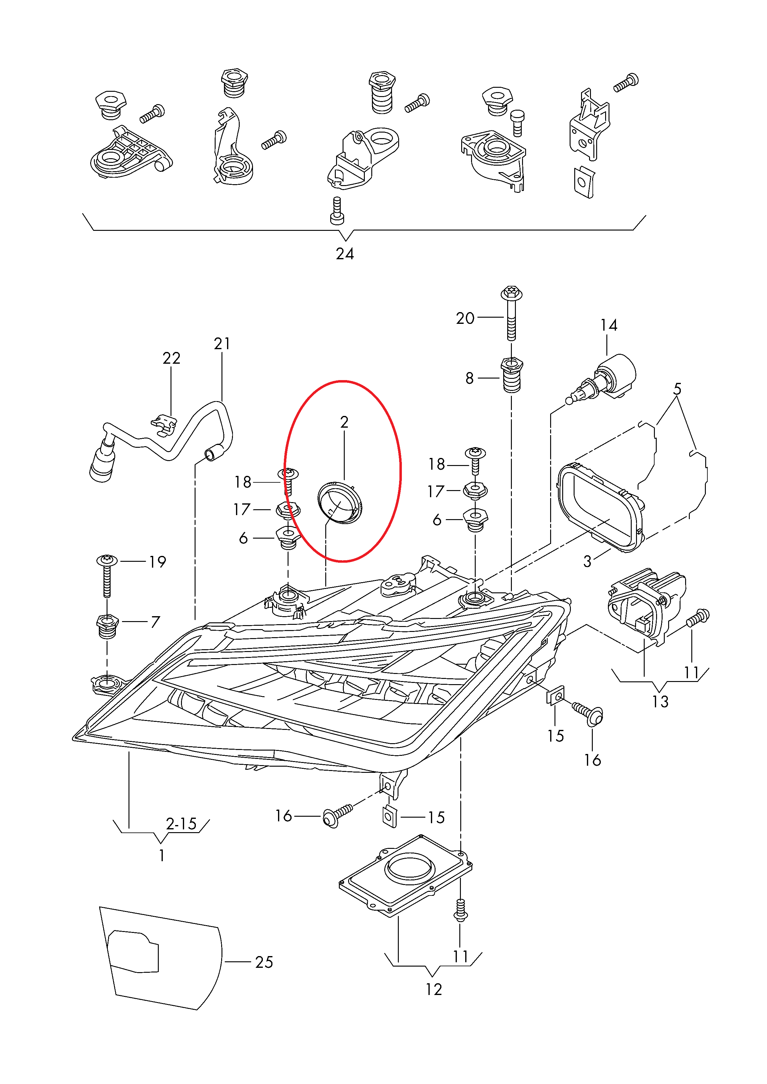

High beam got special screw for adjustment under outside cover (number 2 on picture)

Wound mine up a full turn they were still rubbish border line dangerous when raining the beam pattern is so narrow and short.
Took them to MOT station he said they were to high and wound them back so now I just drive at night on main beam not been flashed once yet that's how bad these lights are.
