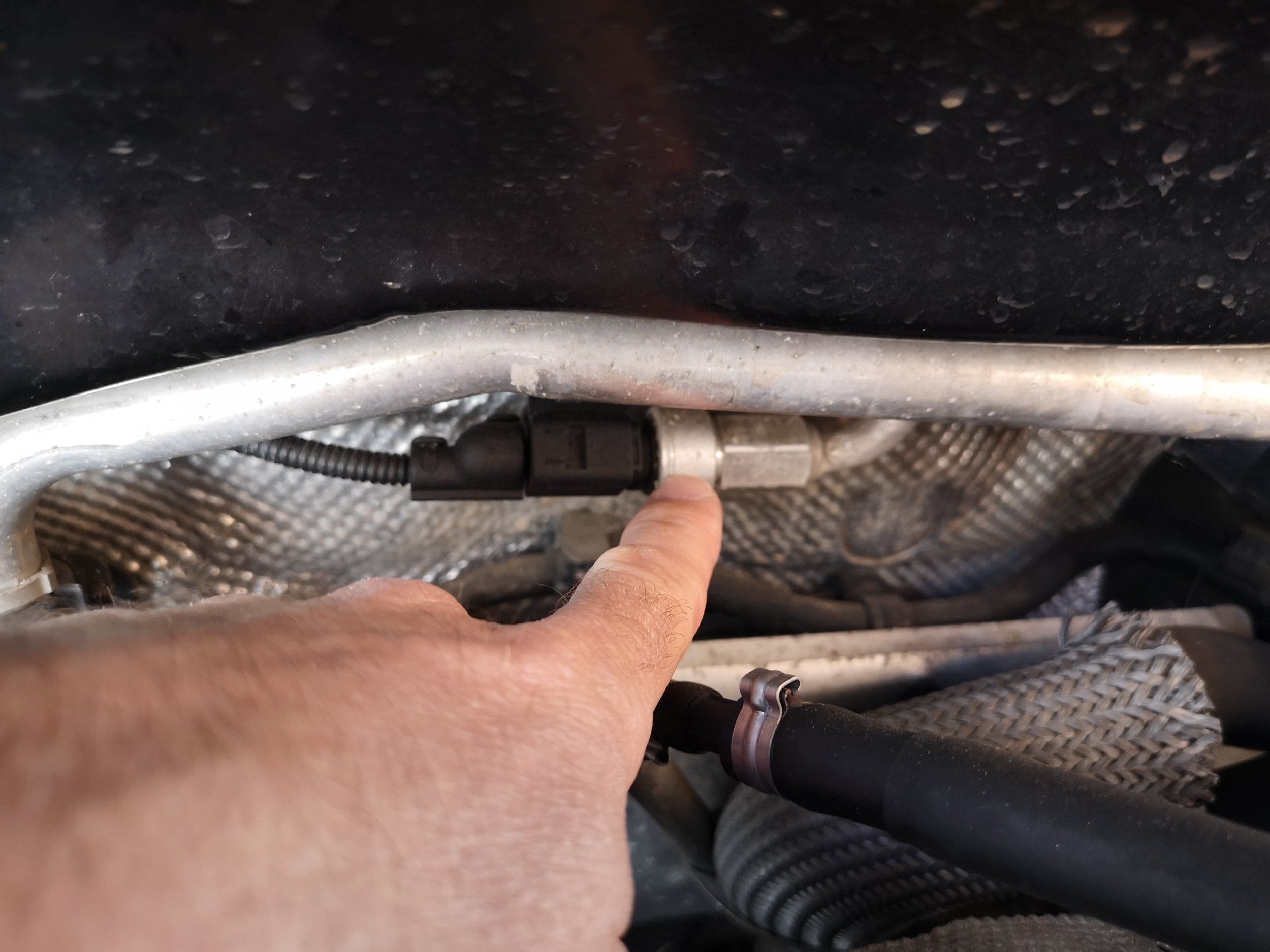

It's at the back of the engine, but make sure there's no gas in there 1st as someone has alre
It's at the back of the engine bay. But make sure its empty of gas 1st.
I’m surprised the ac tech didn’t take a quick look while he was there. If it’s full of gas the only thing it could be is the compressor has failed or has no power to it. The hi low pressure switch. Like I say providing the gas is full.
