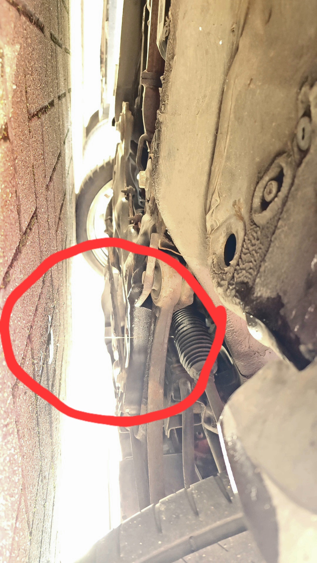

Hey everyone!
I have a 2005 SEAT Leon Cupra R (MK1)
It's started leaking power steering fluid from the driver side boot on the steering rack, indicating the whole rack needs to be changed.
I know the Cupra R has a quick rack and wanted to ask if anyone knows where I can buy one from?
Need it urgently so any help would be greatly appreciated!

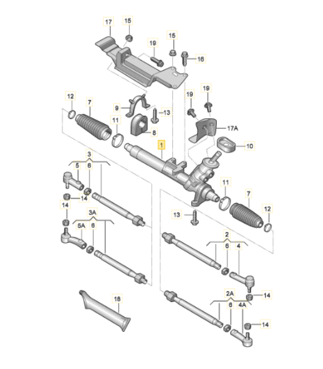

The exact part number of the steering rack for your Cupra R is 1ML422061A.
You might ask a dealer or a parts supplier for an original one or check Autodoc for equivalents from third party brands.
I can help you further if you need any of those bolts, nuts or clamps in the illustration below.
Reactions: Manic172 and _s4q1_
Thank you very much for this! I'll look into this and keep you updated. If any help is needed I'll be sure to give you a shout!

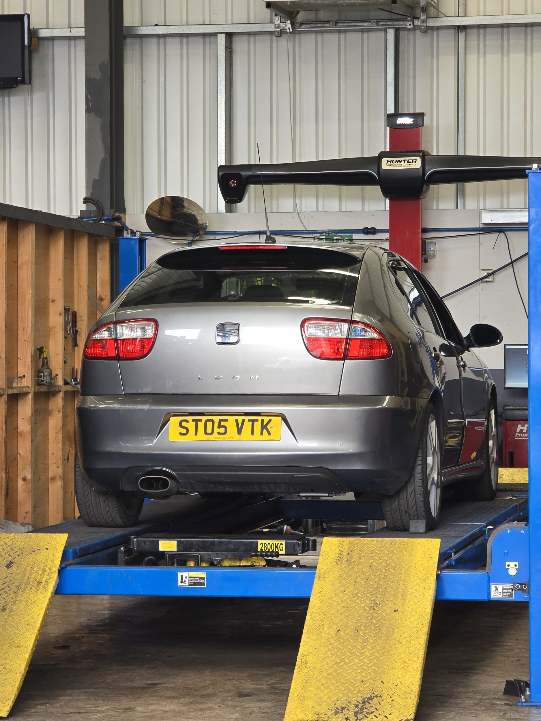

The steering rack has been replaced and car is driving sweet! Getting the wheel alignment done right now and we should be all sorted! Fluid was leaking out of the top reservoir cap itself but I believe that's because of the pressure in the system so after a nice drive it should be all good!
Hopefully many many miles left in this little beast!
Thanks for all of yours help, much appreciated SEAT family ❤️

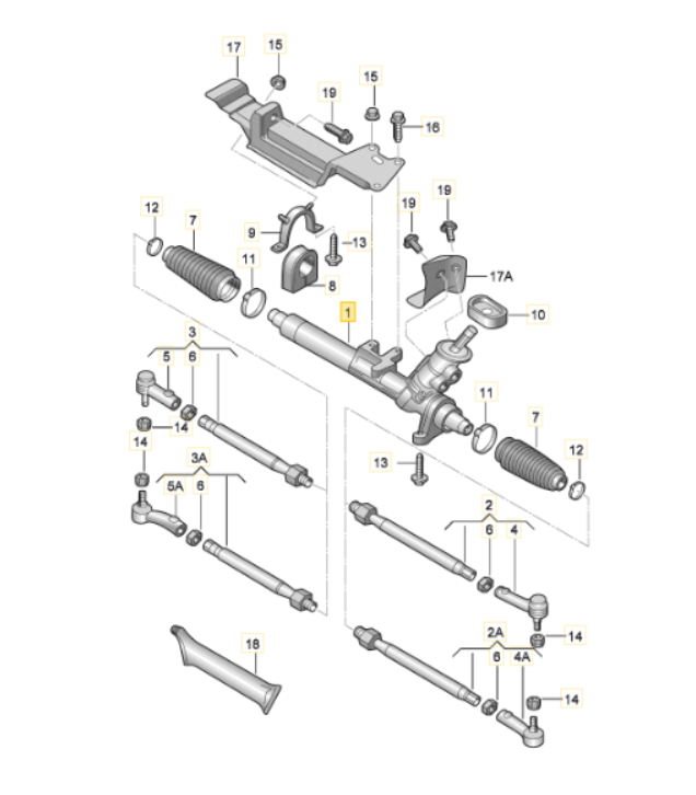

Just wondering does you look up show you what the thread is for the banjo bolts . I am going to conver mine to braided hoses and threw a cooler too
There are two banjo bolts in a section named "oil container and connection / parts, hoses" right after the power steering section in the parts catalog.
One is N90809301 and there's a remark next to it as "12-2"
The other is WHT001800 and on the remark column it is shown as "M16x1,5"
Not sure if it's relevant but there's another part described as "Non-return valve" that looks also like a banjo bolt, with the number 1J0422529A.
No thread size provided in the catalog but some spare parts sites show it as "M14x1.5"
There are also two more part numbers but they are for other variants, not this Cupra R with the given VIN.
