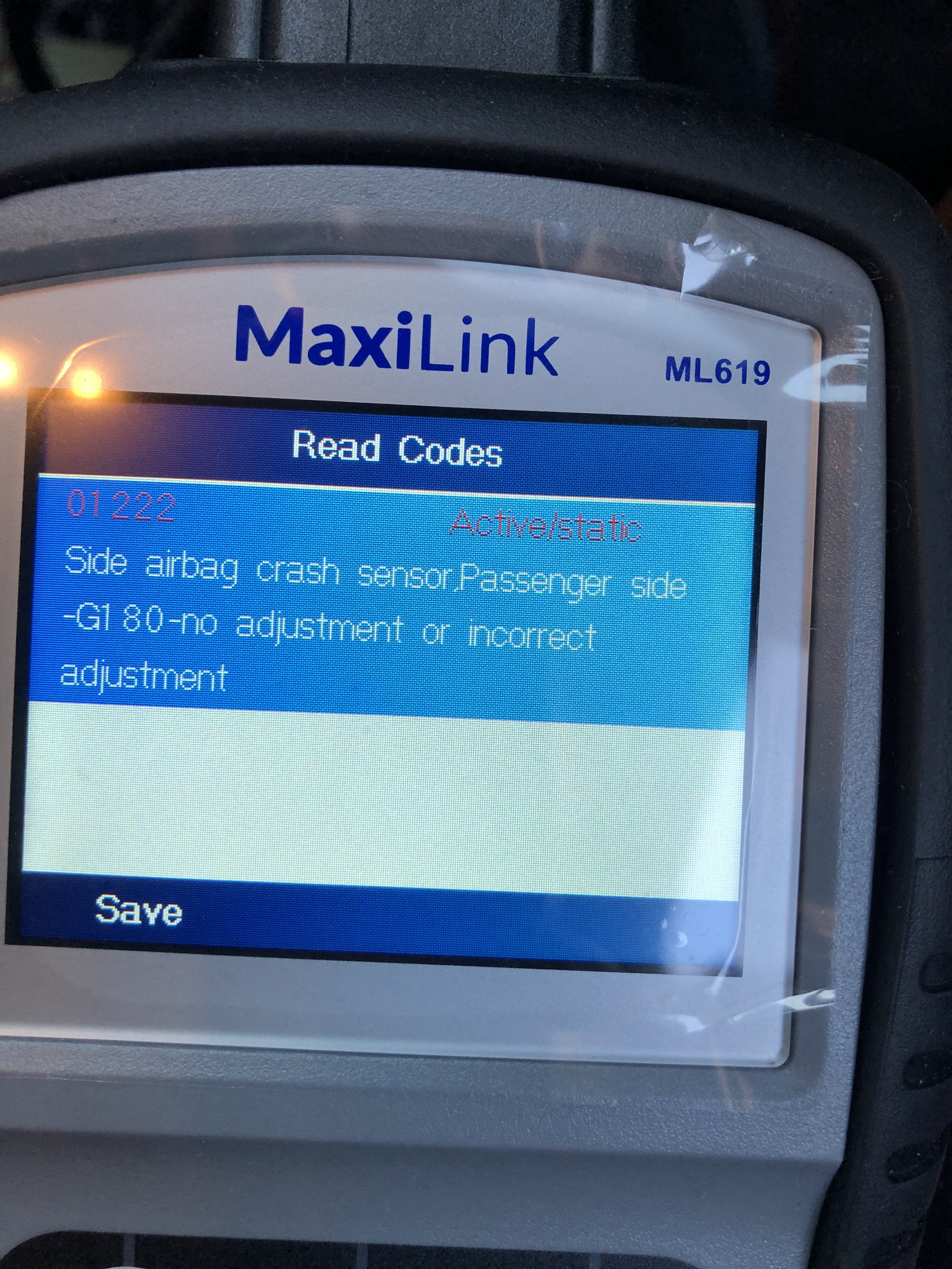

Thanks, managed to find it and got a replacement off eBay. Fitted it, done all the resets, the light goes off for about 3 seconds and then appears again with a different error message this time if anyone knows what it means.....

Dry as a bone. I think the new sensor must be the incorrect coding for my control unit. Starting to prove a nightmare to get or find the right one as the car is 15 years old.
