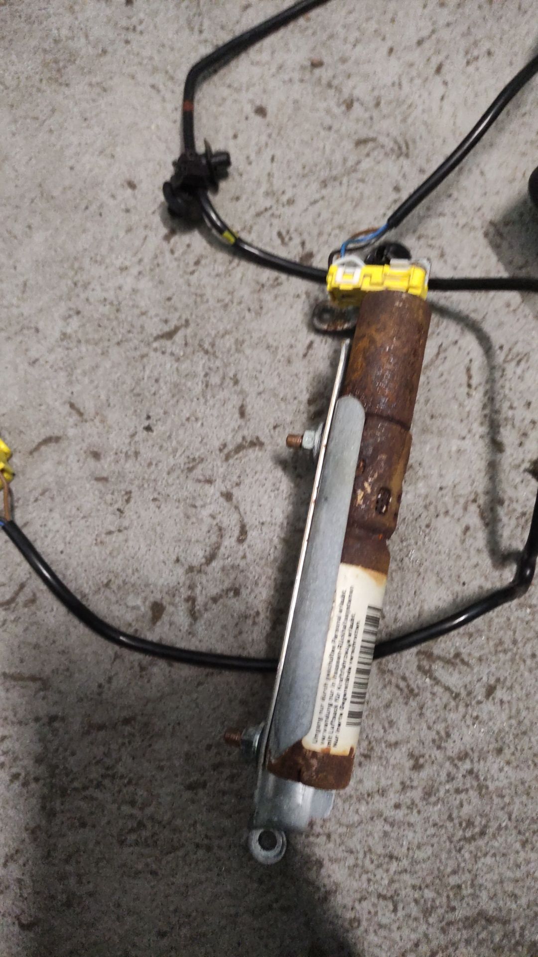

In my case airbag was in terrible condition. So I ve swapped it from different Cupra R seat.

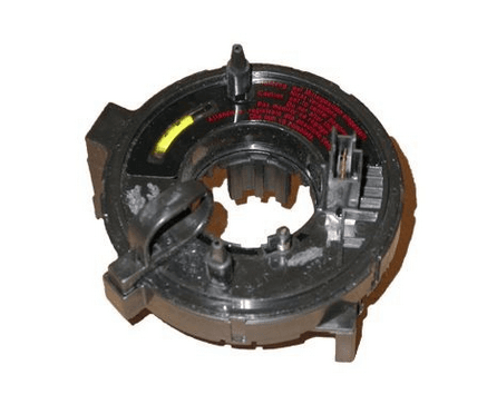

Check the flat cable inside the steering wheel. It could break and throw a error and a warning light. I can check the part number.

Check the flat cable inside the steering wheel. It could break and throw an error and a warning light. I can check the part number.
Thanks. I’m not sure that’s the case as the first time I cleaned the connector as I said, it did go away so seems to be a signal/ connection issue(?) is that part easy to replace if need be?

Yes, it's pretty easy to change but you have to disconnect the battery and requires a 12 spline bit (think is a M10) to take off the steering wheel center bolt.
Nice one. How would you rule it out though? As right now it says drivers seat airbag
