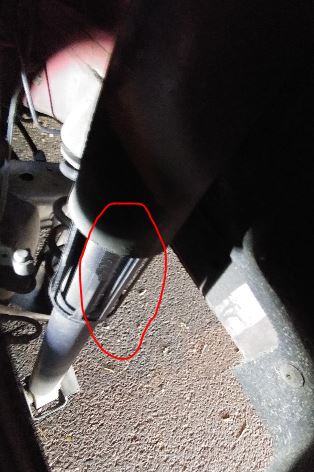

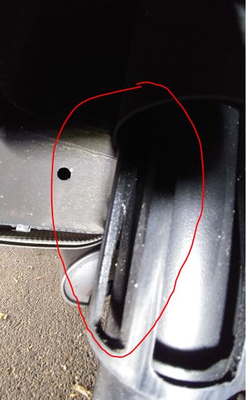

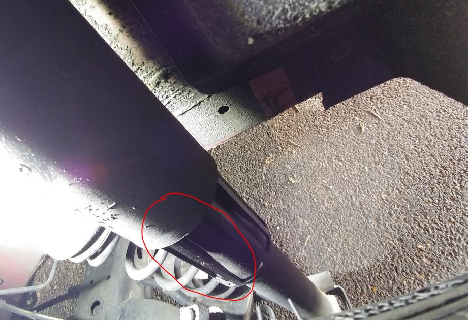

Are these weeping shocks a feature of the design or does it constitute a premature failure? It was advised as list misting (the only option you get when advising on the MOT) but now I feel as though they have got well passed the stage of "misting". The dealer (with whom I still have 2 months warranty) is trying to say only the offside front is leaking enough to warrant a change but below are photos of the other 3 shocks. I think there is clear evidence of leakeage (the dust covers on the rear shocks cover almost the whole lenght of the shock so hard to see the piston rod iselft but the evidence is clear imo)...

Seat have issued Technical Product Information document 2026585/2 about this issue.
This is the text of the document: My copy is too faint to reproduce
A minor loss of oil (condensation) is normal and is not justification for replacing a shock absorber. A shock absorber is considered to have no defects if it meets the following conditions:
a) A minor loss of oil (Dark colouring of the shock absorber) visible but matt, weak and dry due to dust.
b) Loss of oil spreads in the area of the upper seal of the shock absorber (piston seal).down to,at most, the dished spring.
Observations
A slight loss of oil is beneficial, as it lubricates the piston seal, prolonging it's service life.
Damaged shock absorbers can be detected by knocking or detonation noises, usually together with visible oil leaks.

So the dealer approved the warranty but has negotiated just changing the fronts (to mitigate cost to them I guess) I can't be bothered to argue to I just accepted. the rears are not difficult to change so will do them myself at some point.
I'm aware hydraulic seals are lubricated by the fluid on the shaft my previous job was designing hydraulic clutch components but they should not allow this much fluid to pass. I refuse to believe this is indented by design.
