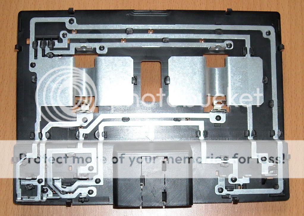

WAHEY, fixed mine, and took about 5 mins!
Popped the unit out, and opened it up, popped out the rocker switches and noticed that one set of the copper connectors had come slightly unstuck from the switch on one side - they`re held on by plastic "rivets" which are pretty small and rubbish - stuck a blob of glue under it.
Also bent all the brass connectors outwards on both switches, and now it works like a charm!

Mac Music, I`d put money (not very much mind :) that it`s one or 2 of those plastic rivets broke on one of your switches - they really are poor...........

Just open up the unit by pressing in the black plastic lugs on the sides and it will split into 2 pieces.
Then you can push the switches out by using a small screwdriver on the hinged part of them, give the brass connectors a small tug and if they are loose from the plastic switch, plop some glue underneath.
It`s also worth bending the connectors outwards VERY SLIGHTLY to ensure a good connection.
top part, don`t need to do anything with this, it`s all very solid.
Hopes this helps..............
