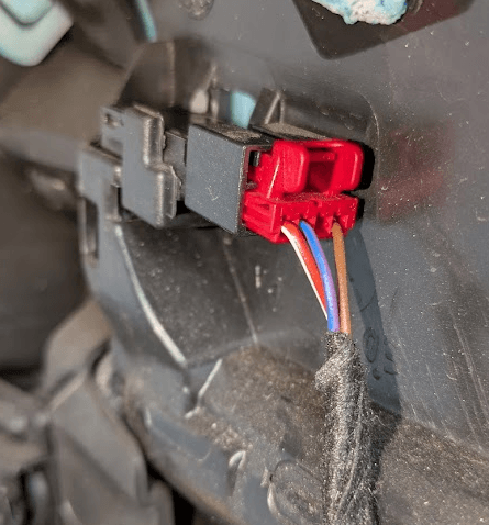

I’ve bought a half alcantara half leather interior from a cupra leon.
I’ve yet to fit it.
It come’s with the ambient light tubes and the 2 LEDs in each door.
My own car does not have this ambient lighting. So I don’t have a compatible headunit (went aftermarket), or BCM, or door controller, or probably wiring loom!
I think the interior is from a facelift cupra, so the LEDs are probably RGB.
Is there any simple way for me get these working? I’d be happy if I had them just stuck on red permanently to match the other buttons.

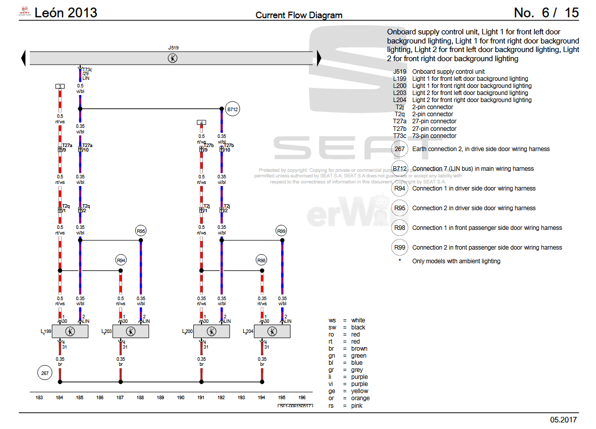

For reference, the LEDs have 3 wires.
This looks like purple/blue LIN (12V?), red/white control voltage?, brown 0V ? Or is this all CANBUS controlled?
LIN(purple/blue)is one Wire Bus. This one say which colour is aktiv
Right OK, just discovered LINBUS. I definitely can't just put 12V on LIN then and maybe get red.
I wonder without the LINBUS message, if I just put 12V on red/white and 0V on brown will I get white light from the ambient?

Just to answer you question - LIN is not oldschool high/low current, it is protocol that sends digital signal. It is send by BCM and (for ambient lights) it is used to transmit data about brightness and colour of light.
Retrofit is not easy as you have to pull 12V, ground and LIN signal from BCM to each door. Also BCM might need to be changed. However if you are stubborn enough you could do with it some nice things :)
