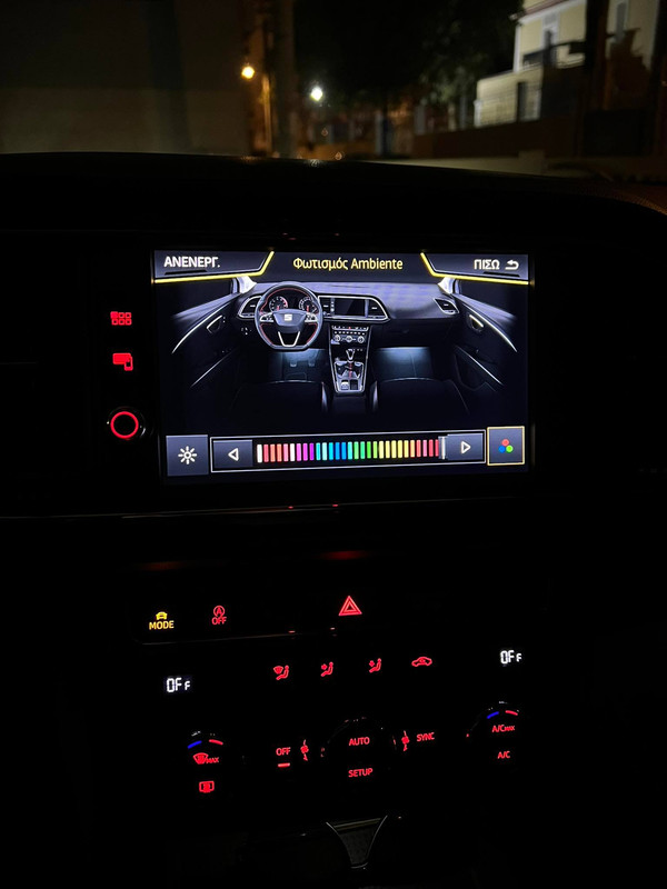

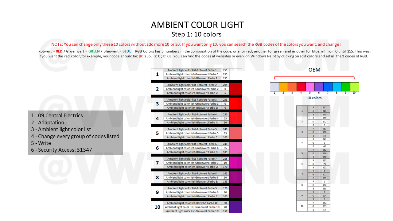

Helps for the first 10 colour yes thanks just trying to find the codes for the other 20 or find someone that could send me screenshots of there codes as my OBDeleven app has glitched out and says unsupported when trying to do it off there own systemDoes this help? Some additional links from the thread:

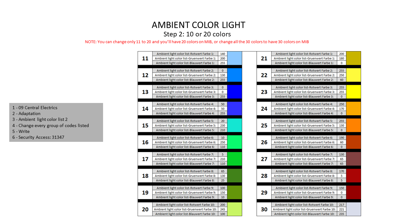

Nice work do you need to change first 10 OEM colours first to get access to list 2?
Check at Module-09 ---> Adaptation ---> Frei_Farbwahl_ueber_HMINice work do you need to change first 10 OEM colours first to get access to list 2?
Or can you keep OEM colours and just add 11-30 new colours? Sorry it seems bit complicated thanks

Follow the steps aboveI'm confused do I need to change both list2 and list 2lin? To exactly same colour numbers? For now changed list 2 all colours didn't touch list 2lin and still only 10 basic colours on the screen
