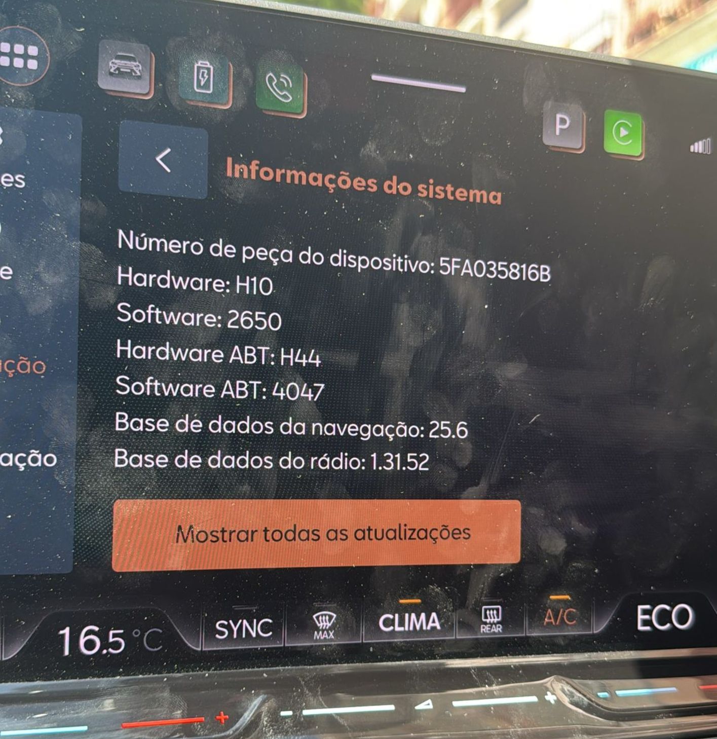

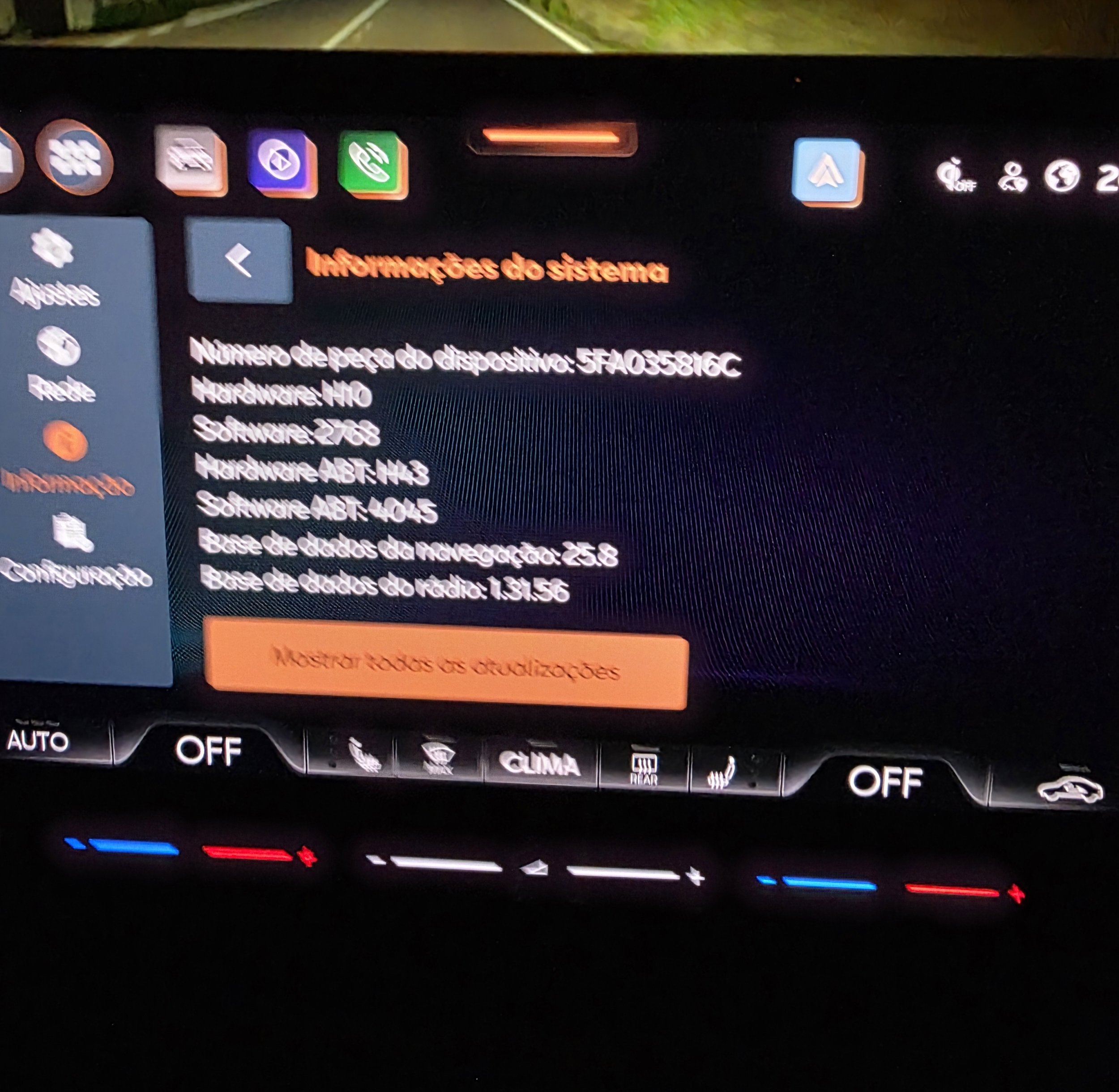

sry sry wrong info, yeah so
software version is 2565
ABT harware H43
ABT software 4045
