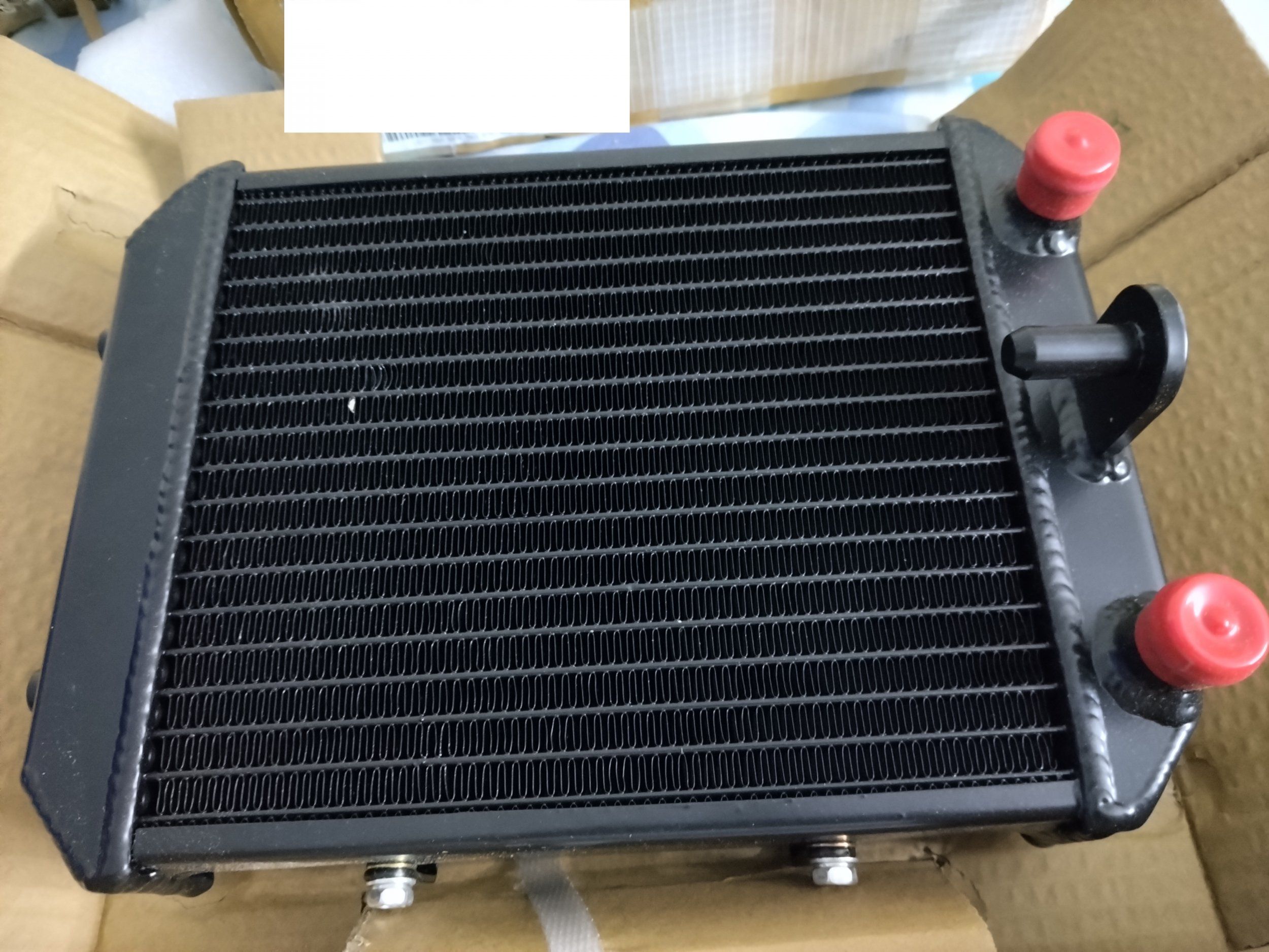

Update: spoken to my garage and its going in for this work to be done, once I get the list of parts I will share them in this thread so at least others will have a list of parts they need. Personally I am going to fit the Airtec Motorsport Uprated Auxiliary Radiator as this increase the size, capacity and ability of the original auxiliary radiators.

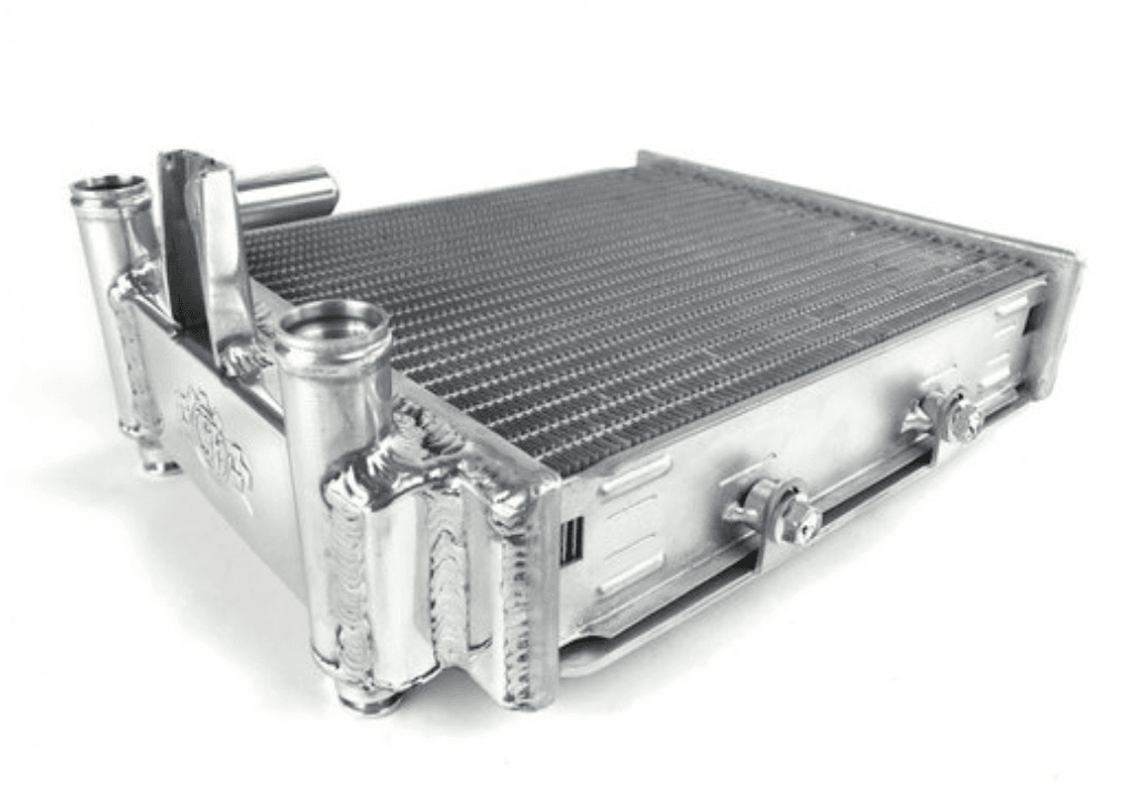

Just to update this thread.
I had already upgraded the DSG Aux Radiator with CSF Quadruple Pass DSG Cooler and I was able to confirm during a pre and post track session that it made a positive difference to the DSG Temps.

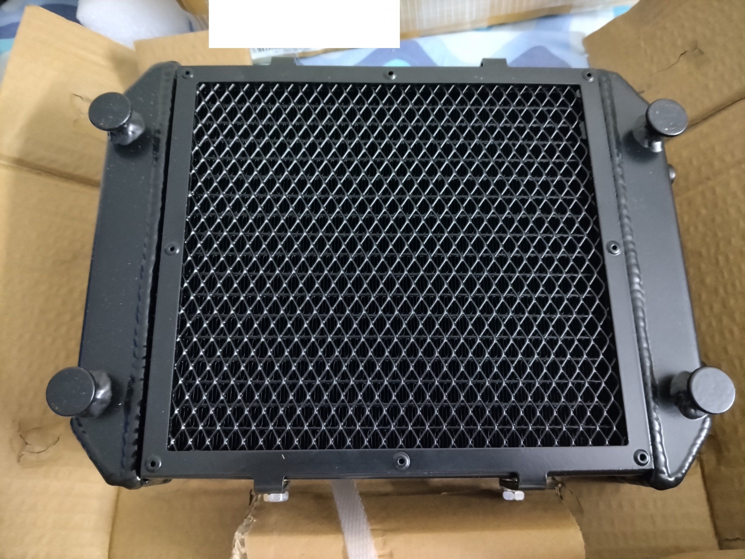

today my new engine aux radiator from Airtec Motorsport Uprated Auxiliary Radiator For MQB Platform - ATINTVAG42 arrived just waiting for pipework so it can be fitted
will update with pipework serial numbers when i get them

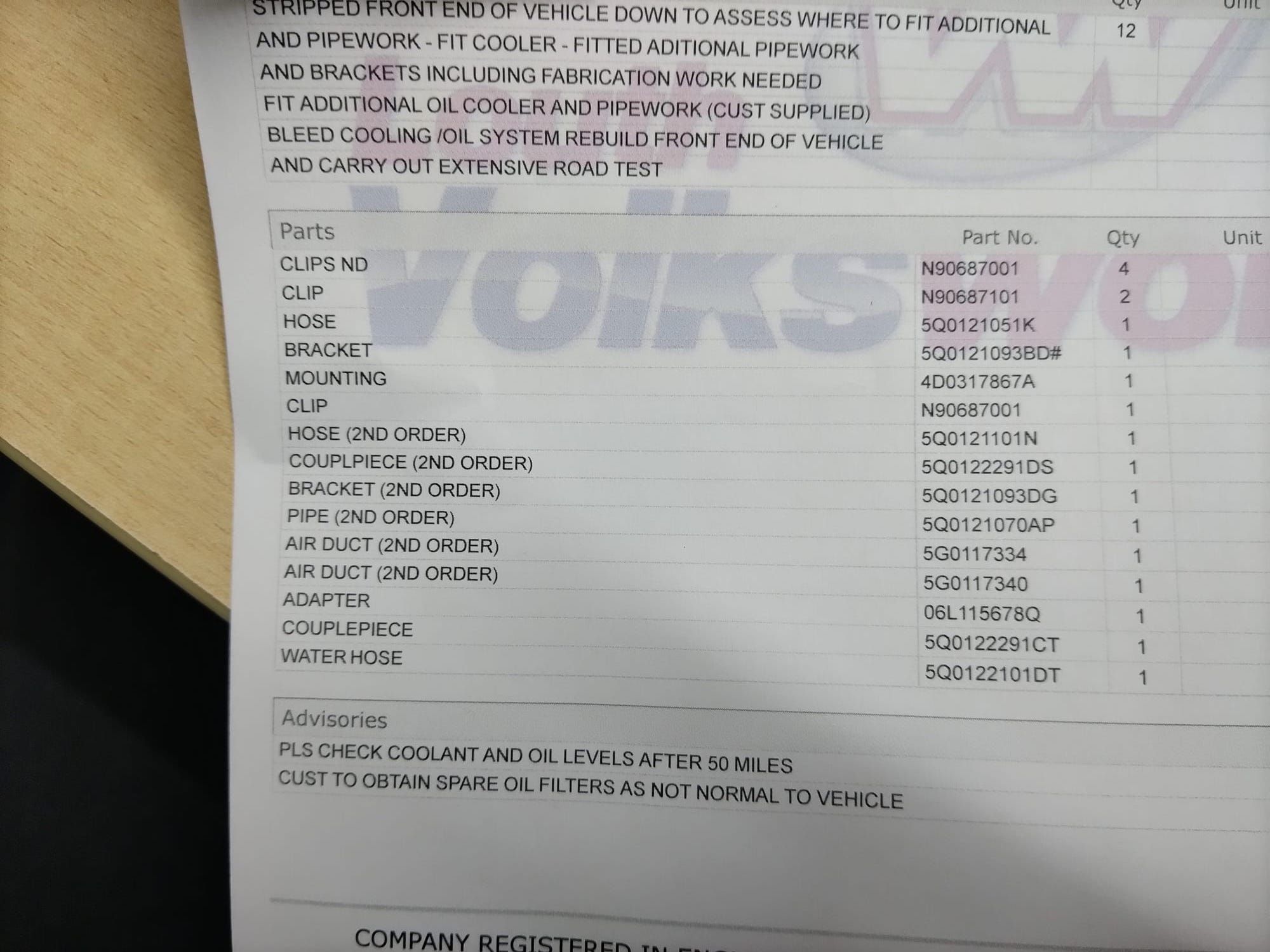

Finally got all the part's in and fitted for both the Aux rad (parts list in attached picture) and new oil cooler rad.
I would also add that the garage confirmed that the fitting instructions did not work on the Cupra 280 due to the light washers being in the way. The oil cables are long enough to change location with no issues.
