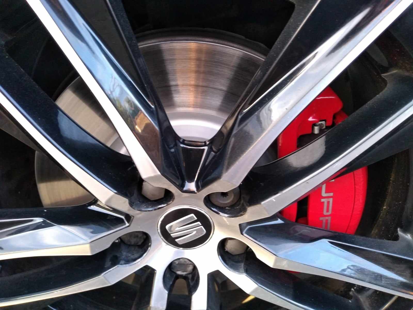

I'm not sure which brakes my car had but they were excellent. They said Cupra on them, not Brembo so I think they were the standard brakes. Good enough for me I know that.

I would avoid the 370 dia 'performance pack' brembo brakes for a road car, very expensive replacement discs. The Standard 340 dia single piston brakes are still good with the right pads.
Reactions: Mo_86 and Mr Pig
Also the Performance pack discs (Brembo) tend to warp. Replacing them with Zimmermann is the way to go then. Also the Performance pack is harder to fit behind wheels, fitment might become an issue.

@Mr Pig those are the stock 340mm brakes
