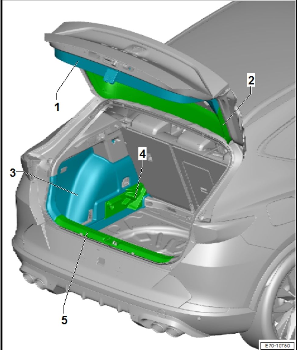

Remove the cross trim (5 in the below image) the cross trim needs to be prised up, slide a trim tool under the trim at the boot rubber and prise it straight up, work your way along the trim prising as you go, be careful this has a cable attached but there's enough slack to put it to one side.
