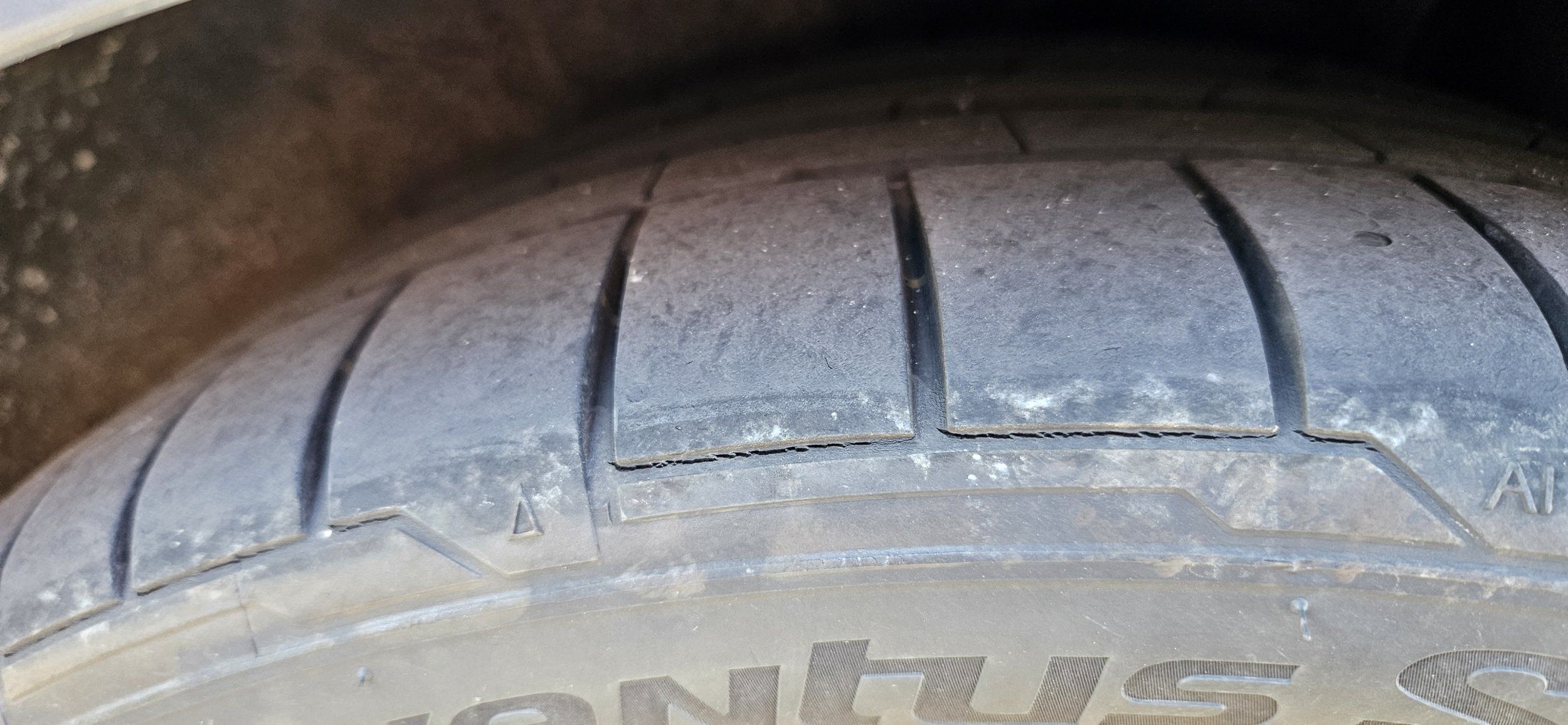

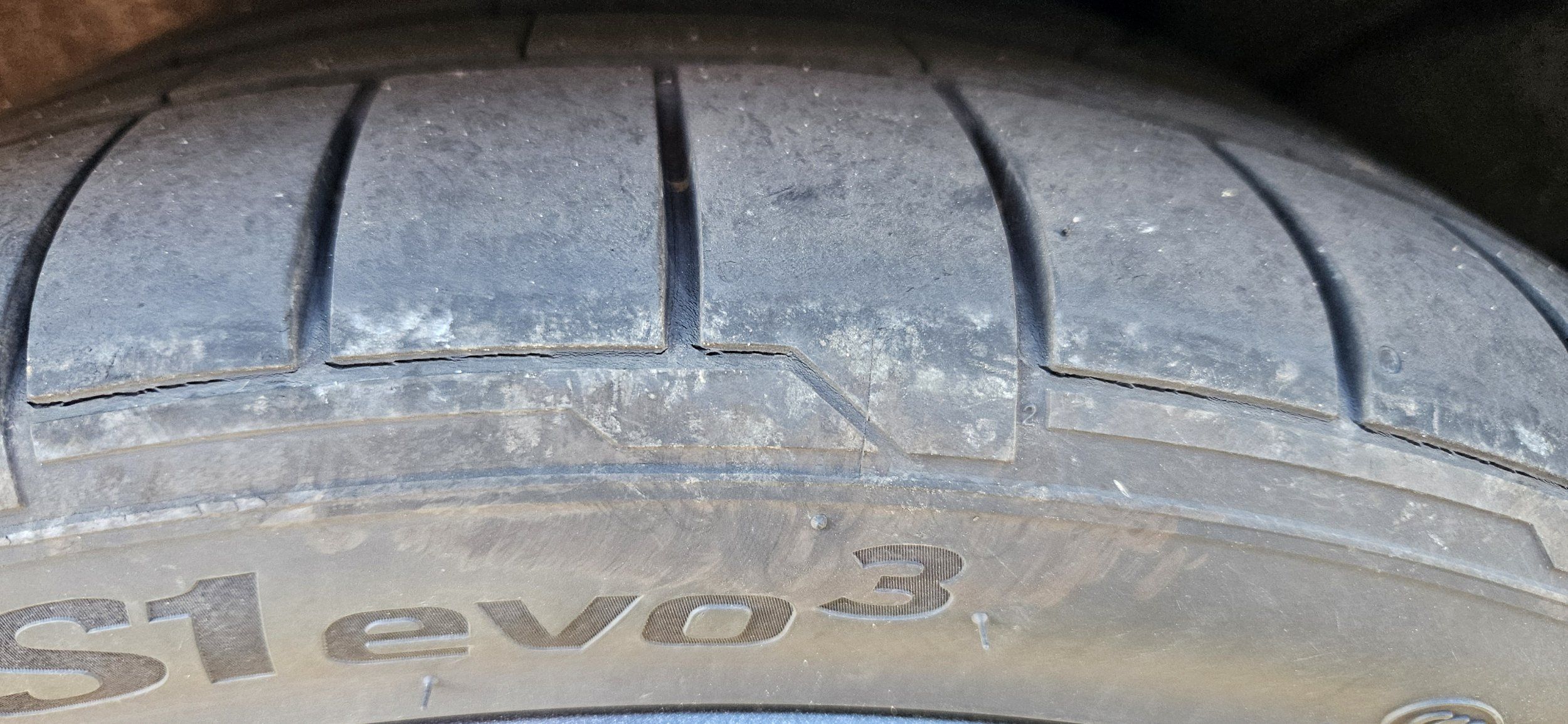

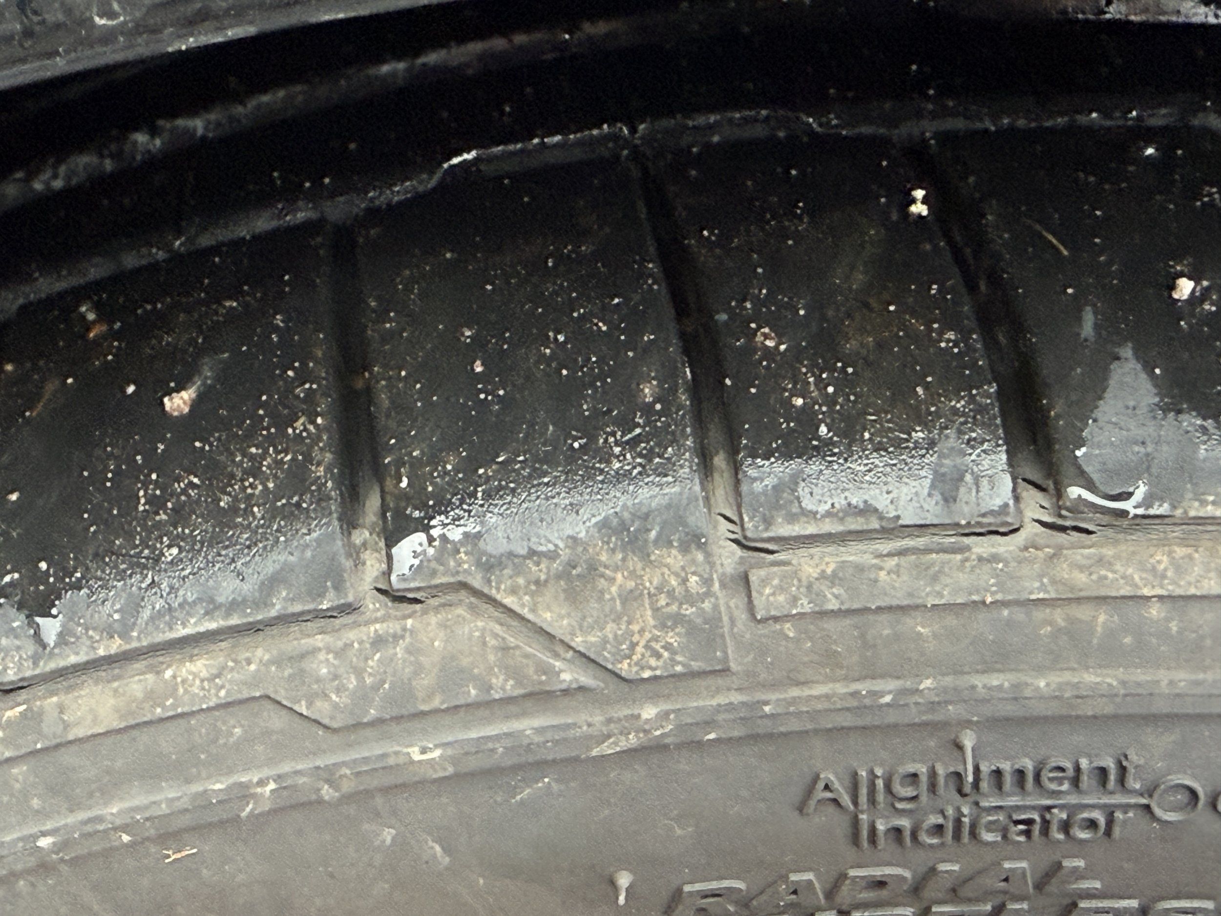

Evening all,
I have the Hankook Ventus S1 Evo 3 tyres on my 2023 VZ2 Leon (235/35/19).
The car has covered 5k miles and is 9 months old.
I noticed today when checking my tyre pressures that the rear tyres are cracking just below the main tread.
I've seen on here I believe that some tyres (maybe Bridgestone but not certain) have been known for delaminating on these cars and wondered if anybody has had or knows of any issues with the Hankooks?
I believe I've seen recently that there was even a recall on the Bridgestone tyres but for whatever reason when I search on here nothing is coming up.
Any information is much appreciated as always!

It doesn’t look good. I would get to a tyre centre and go from there, they may know something but I’d be getting in touch with your dealer as well. They’ll use excuses about the power steering causing this and load etc etc.
Thanks for the reply. I'll certainly be trying my hardest to get these replaced under warranty. The car is never fully loaded, it's mainly used by my wife to pootle round town in during the week. I know it won't be easy trying to get these replaced but rear tyres should last more than 9 months/5k miles! Wish me luck!
Looking forward to seeing what experiences people have had in the past with similar issues......

Had a lot of different Cupra's, all on different tyres (Bridgestone, Pirelli, Michelin) and never had this. I usually drive hard most of the time too, so they sound faulty to me.
Had a lot of different Cupra's, all on different tyres (Bridgestine, Pirelli, Michelin) and never had this. I usually drive hard most of the time too, so they sound faulty to me.
I had a Cupra 300 4 Drive before this one with the same size tyres, had Bridgestones on from new and I replaced with Goodyear ASM 6 and neither tyre gave any issues. Will contact Cupra dealer on Tuesday and see what they say.....
Have a quick look at the DOT code on the tyres. The end numbers (x4) refer to the week and year of manufacture, maybe the tyres are a lot older than the car??
Thanks for the advice, already checked this and they are week 16 2023 so not really any older than when the car was built. ?

It could be faulty tyres but I'd also advise getting your four wheel geometry checked in detail, not just alignment but also camber and toe to ensure it's in spec.
I had something similar happen on a VW some years ago, on that one the inside edges of the rear tyres wore in a saw tooth and those tread blocks looked like the leading edge was being torn - your photo is difficult to judge but if you run your hand around that edge in one direction then the other can you feel uneven and raised edges on those blocks? (It will feel smooth in one direction, bumpy in the other).
Tyres are wearing perfectly evenly (checked with digital tread gauge) and no roughness in any direction, all looks perfect other than the cracking. Appreciate your input and suggestions ?

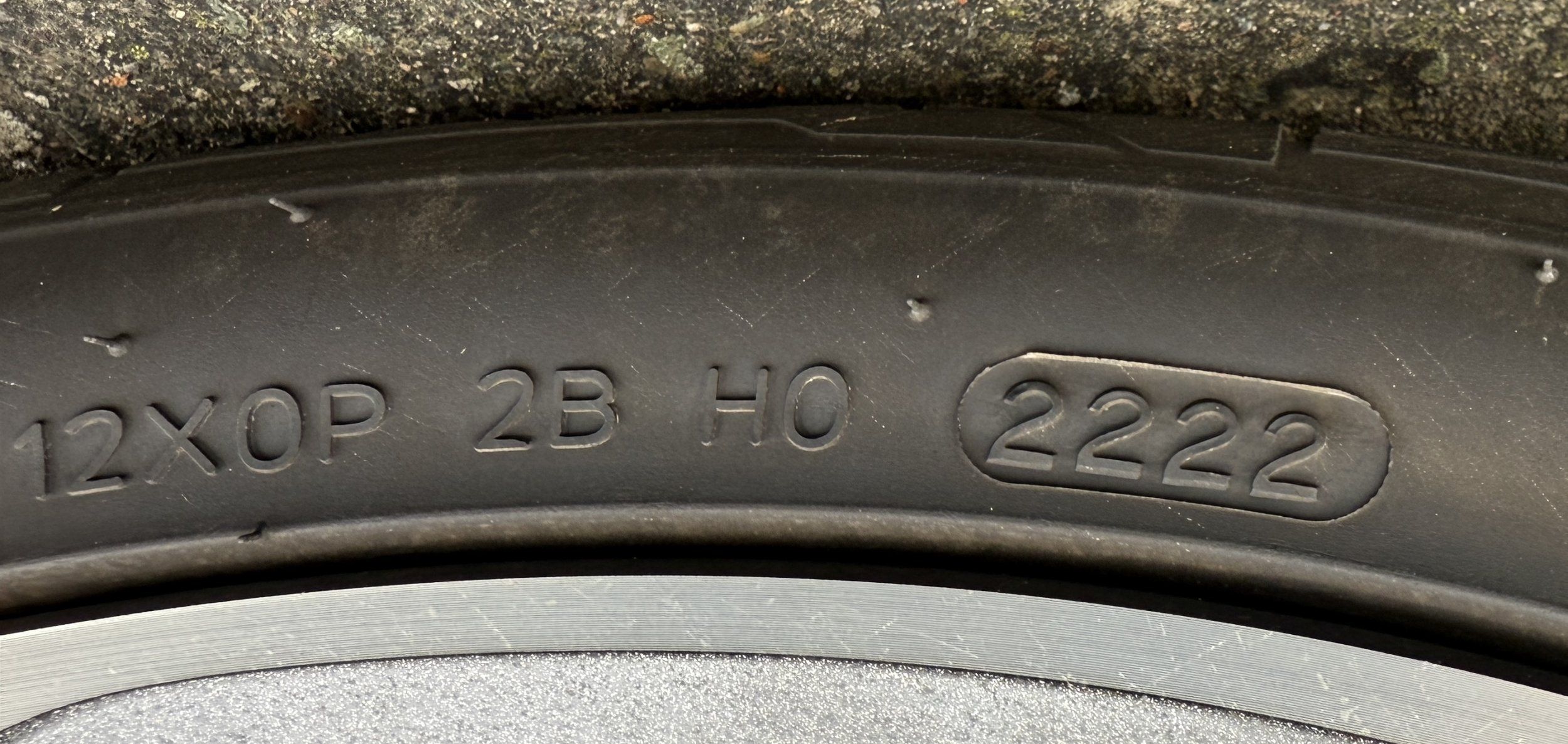

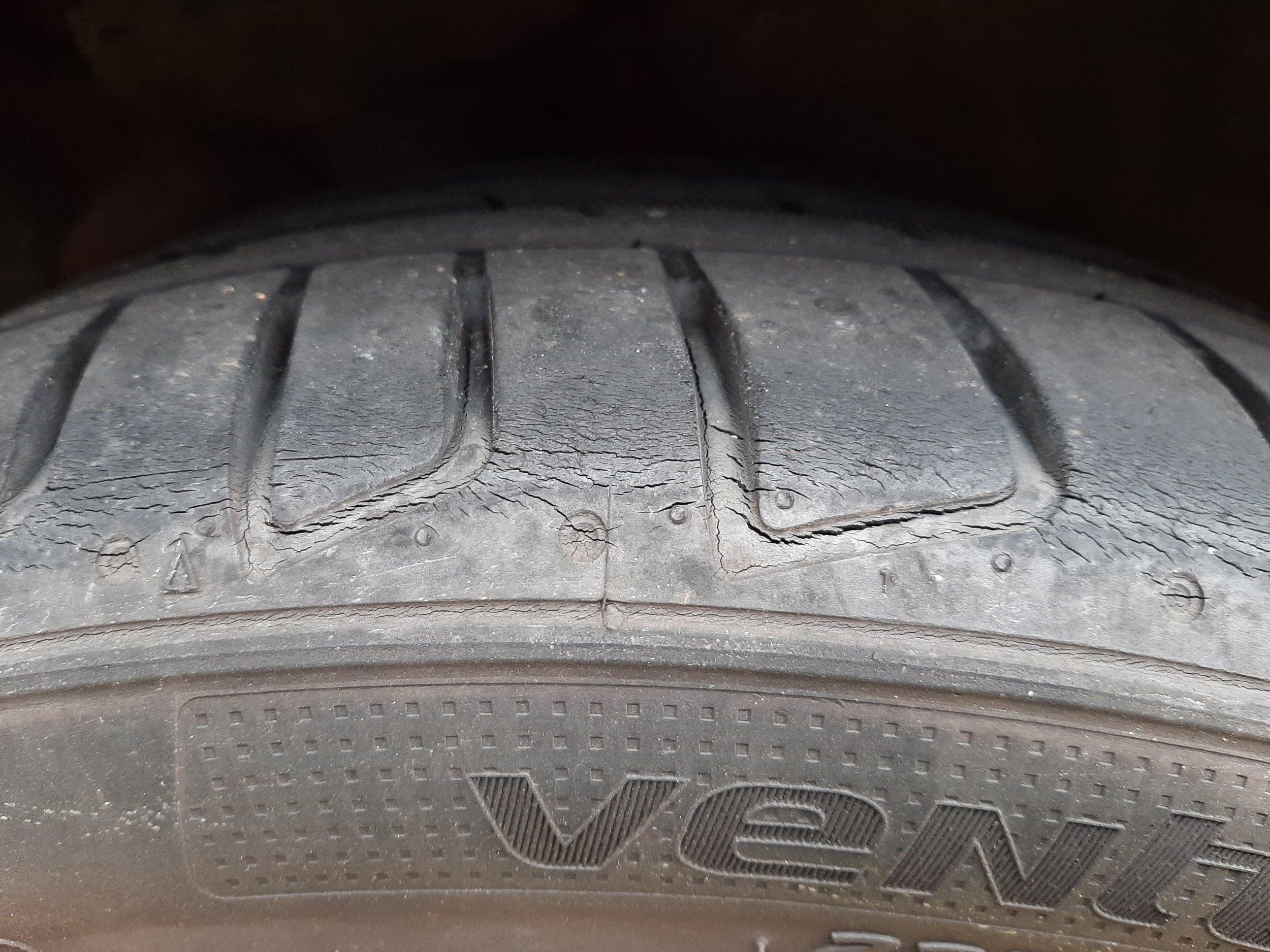

It appears to be a Hankook thing; these were fitted 18 months ago.

Wow they're not good are they for 18 months! I've never had Hankook tyres before and I certainly won't be using them in the future when I need any replacements. Turns out that Kia/Hyundai used to fit Hankooks as their main tyre supplier but after so many recalls on their cars due to faulty tyres they sacked them off!

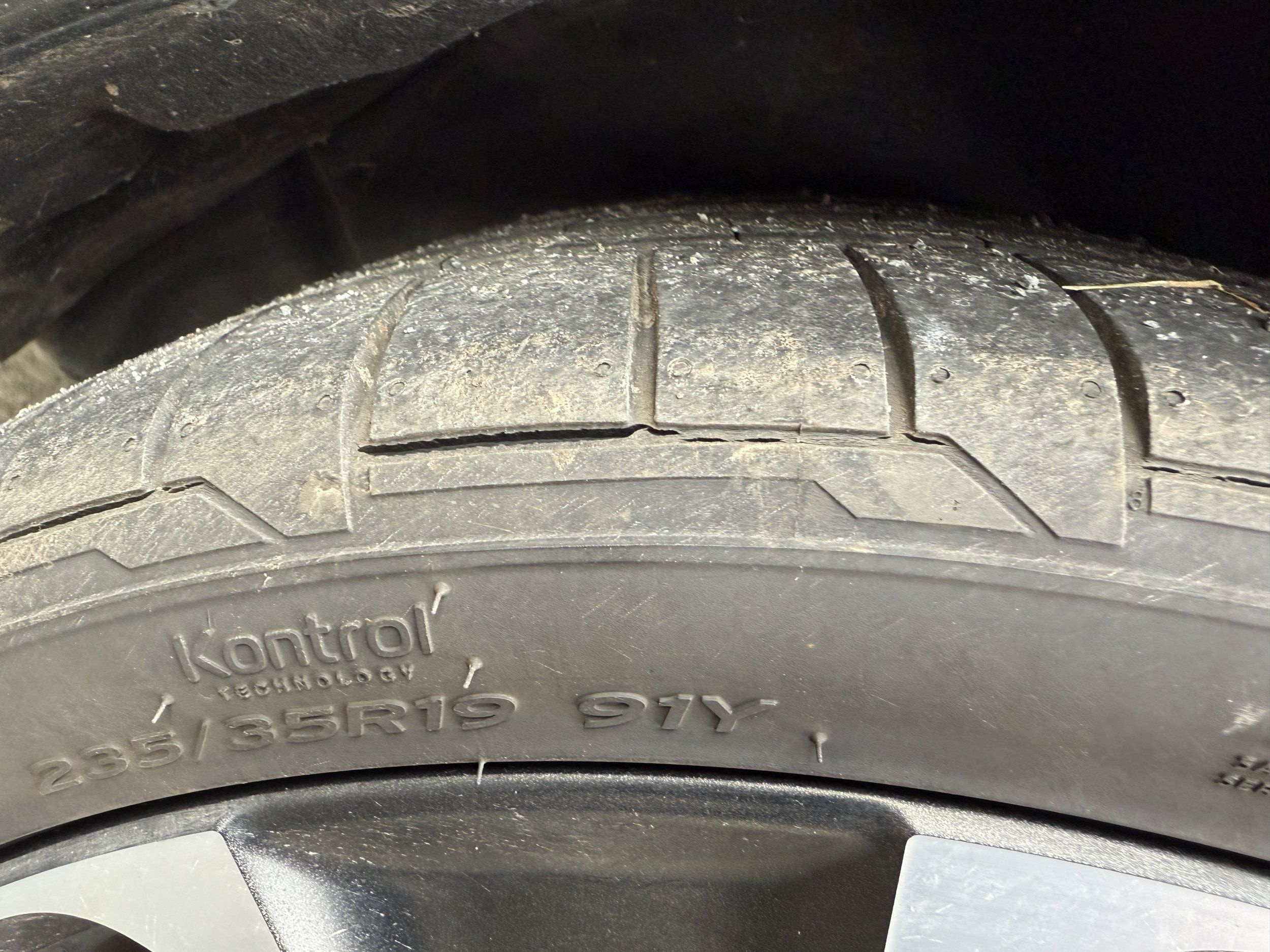

I have a very similar issue. The local dealer flagged it as an advisory when in for something else. The supplying dealer says that they are OK. I'm not happy with how they look.
Do I bother to get a third opinion, or just start the 'discussion' with the supplying dealer?
edit: when local dealer gave advisories, car had done less than 500miles and it was exactly 10 weeks since I collected it. All four tyres have cracking, all have more than 5mm tread. Total mileage was about 5150 at that point.

I would be right back to the dealer, tyres should not do that without being faulty. Do you not have a friendly tyre outlet that can give an opinion before you return to dealer?
It appears to just be what Hankooks do.
I binned them eventually (even though there was plenty of tread left) and bought Goodyears.
The Hankooks are good tyres in terms of grip and wear, but they definitely seem to have issues with cracking where the tread meets the sidewall.

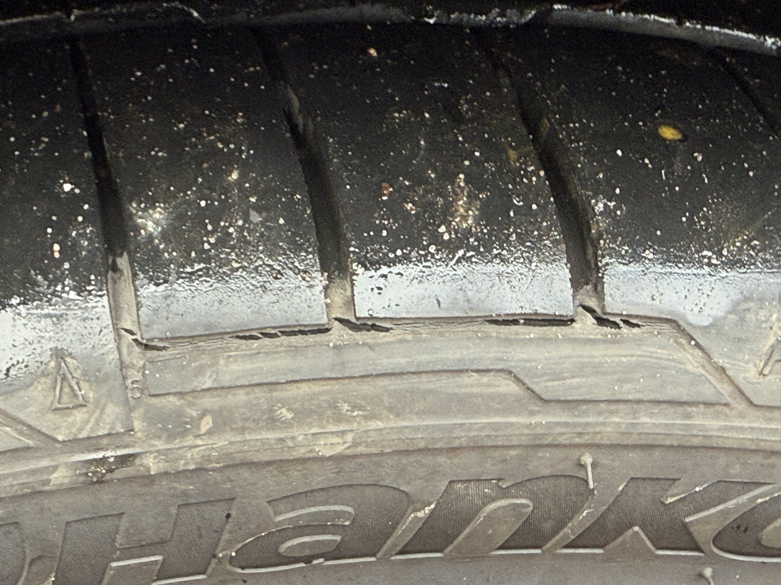

Thanks for the replies.
I went to a tyre fitter, he said keep pushing supplying dealer. (Then suggested a route to try if that fails - a localish Hankook dealer to try and get in contact with Hankook)
This is the OSF.
