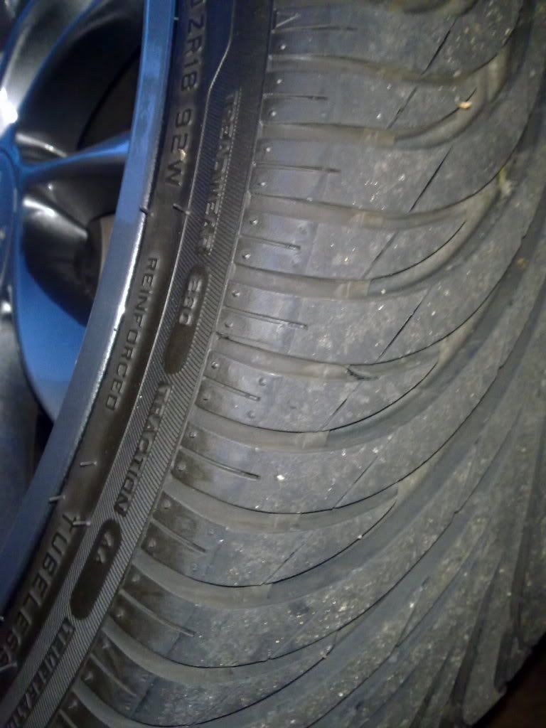

I have never fully understood the law when it comes to tyre wear hence why i have always changed my tyres as soon as i've noticed them to be anywhere near the limit. The present tyres on my car have an unusual pattern that i've not really come across before... I've recently purchased the car so would be grateful if someone could advise, as to whether or not, my tyres are legal... Please see following pictures
Drivers side front tyre outer grip looks to be completely worn however the majority of the inner tyre is still above the limits

law states 1.6mm across centre 3/4 of the tyre with visible tread on the rest......

i can see tread on the outer edges so theyre not illegal.
are they shite tyres ? yes
are they very close to the legal limit ? yes

not being a ****, but youre supposed to use a 20p coin, as the "border" running around the edge of the coin is 1.6mm thick.
also, that tyre is very much legal *i work for Vosa / MOT*
but i wouldnt reccomend them

I couldn't find a 20p piece so used 10p instead. Apparently the dots around the circumference of a 10p piece measure 1.6mm from the edge.
Definately legal mate ? You would pass the MOT on these tyres with the wear shown in the pics ?
