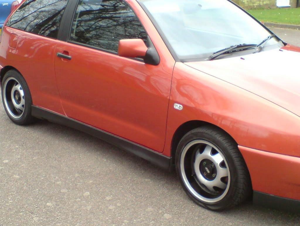

here's mine on my old ats's!! et15 7.5j with 195/45/r15 tyres
no rubbing problems unless i had more than 1 heavy bloke in the back! make sure you get longer wheel bolts though!! mine came loose cos the standard ones are too short!

yeah i did really like the look of them. it's lowered 40mm but it didn't really look i as the tyre's were a lower profile leavig a bigger arch gap.:confused: but I had a change of heart and wanted a more oem look so its on a set of origional 5 spoke gti alloys now.[B)]
Yeah i am umming and arhing at the moment, think i want 16's ultimately as i have 17's at the moment and it seems that lowering is an issue on large rims. Plus cheaper tyres etc...
to be honest it seems to be the width/low offset of some wheels that gives rubbing issues rather than the diameter of them. my car came with a set of 7 X 17 inch wheels and they never rubbed, only the cups with their low offset and 7.5j width:funk:. they looked cool but as they looked gay with high profile tyres i had to fit lower (45 profile) ones that left a bigger arch gap and that in turn made the car look like it as no longer lowered!:cry:
